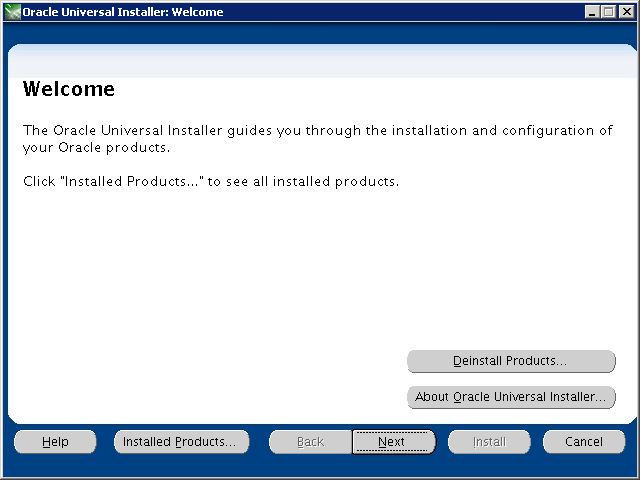

  3. On Welcome, click the Next button.

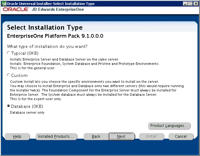

    Surrounding text describes ppack_install_type.gif.
  4. On Select Installation Type, click this radio button:
    Database
    This selection installs the components that match the OVM Enterprise Server template.
  5. Click the Next button.

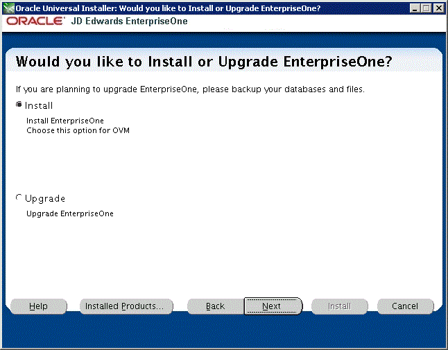

  8. On Would you like to Install or Upgrade EnterpriseOne?, click the first radio button that is entitled:
    Install
    Install EnterpriseOne
    Choose this option for OVM
    Caution:
    You must choose Install otherwise the Business Data and Control Tables will not get loaded.
  9. Click the Next button.

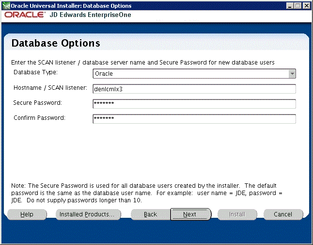

  10. On Database Options, complete these fields:
    • Database Type
      You can accept the default value, which is Oracle.
    • Hostname / SCAN listener
      Enter the unqualified hostname or Single Client Access Name (SCAN) for the database server. For example, denlcmlx3.
    • Secure Password
      For use with Oracle VM Templates, you must accept the DEFAULT value for this field.
      The Secure Password is used for all database users created by the installer. The default password is the same as the database user name. For example, user name = JDE, password = JDE. The value for the password cannot be longer than 10 characters.
  11. Click the Next button.

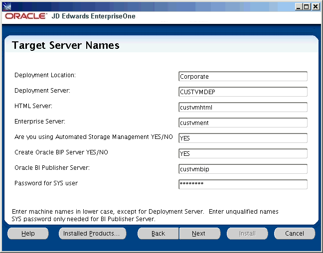

    Surrounding text describes ppack_target_names.gif.
  14. On Target Server Names, complete these fields:
    • Deployment Location
      Enter the Deployment Location. For example, Corporate.
      This value is used for package builds of JD Edwards EnterpriseOne.
    • Deployment Server
      Enter the name of the Deployment Server. This name must be all upper case and non-qualified. For example: CUSTVMDEP.
    • HTML Server
      Enter the name of the HTML Server. This name must be all lower case and non-qualified. For example: custvmhtml.
    • Enterprise Server
      Enter the name of the Enterprise Server. This name must be all lower case and non-qualified. For example: custvment.
    • Are you using Automated Storage Management YES / NO
      If you are using Oracle ASM on your database server, enter a value of YES.
    • Create Oracle BIP Server YES or NO
      If you want the Platform Pack installer to create an Oracle BI Publisher Server for JD Edwards EnterpriseOne, enter a value of YES.
    • Oracle BI Publisher Server
      If you specified YES in the previous field to create an Oracle BI Publisher Server, enter the name of the server. This name must be all lower case and non-qualified. For example: custvmbip.
    • Password for SYS user
      Enter the password for your Oracle SYS user on the database server.
  15. Click the Next button.

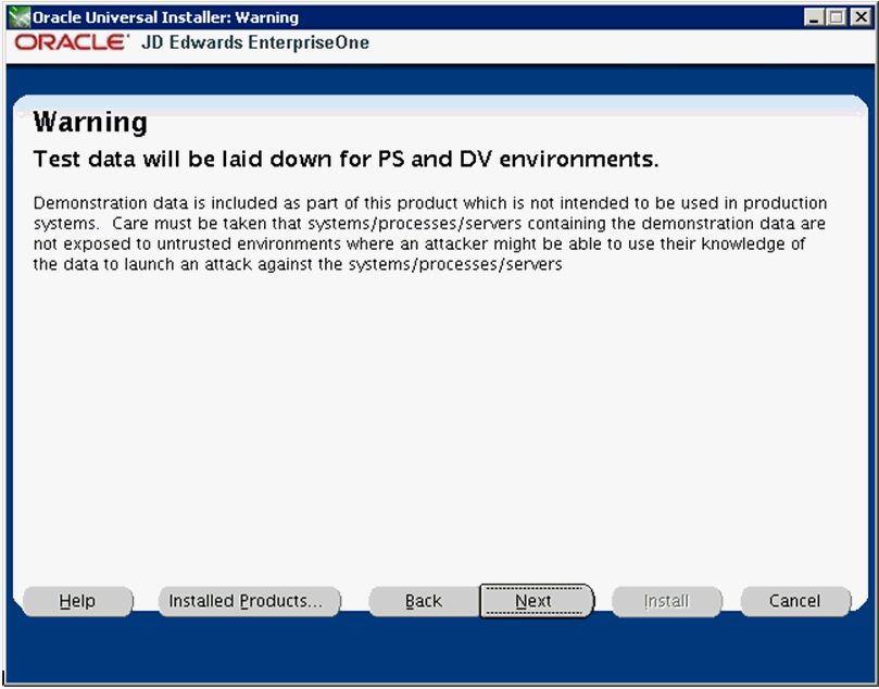

  16. On Warning Test data ill be laid down for PS and DV Environments, the warning informs you that the installation delivers test data that is not intended to be used in production environments. The primary purpose of this test data is for use by EnterpriseOne support when diagnosing issues you may have with the software. Because this data is not used in any production environment, it should not pose a security threat. Regardless, it is strongly recommended that as a best practice you secure your system as soon as possible after installing by changing your JDE and Database passwords. Refer to as described in the appendix of this guide entitled: Appendix C, "Security and Demo Data Configuration".
  17. Click the Next button.

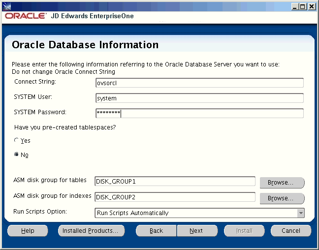

    Oracle Database Information - ASM = YES
    Surrounding text describes ppack_oracle_db_info.gif.
    The above screen and these steps are applicable if you chose ASM = YES on the Target Server Names screen in Step 14.
    On Oracle Database Information, complete these fields:
    • Connect String
      For purposes of running the Platform Pack installer, the value for this field must be ovsorcl. This is required to match the values specified in JD Edwards EnterpriseOne tables and also in jde.ini files on the Enterprise Server.
    • SYSTEM User
      You must accept the default values for this field, which is system. Do not specify this value as sys.
    • SYSTEM Password
      Enter the password for your SYSTEM user.
    • Have you pre-created tablespaces?
      Use the radio buttons to select whether you have pre-created your Oracle tablespaces. If you choose No, the Platform Pack installer will execute scripts to create the tablespaces. If you choose Yes, you must have already created the tablespaces prior to running the Platform Pack installer.
    • ASM disk group for tables
      Enter the ASM Disk Group name(s) that will be used for your JD Edwards EnterpriseOne database tables. For example, DISK_GROUP1.
    • ASM disk group for Indexes
      Enter the ASM Disk Group name(s) that will be used for your JD Edwards EnterpriseOne database indexes. For example, DISK_GROUP2.
    • Run Scripts Option
      Use the pulldown to select when you want the Platform Pack installer to automatically run the database scripts, or whether you want the installer to only deliver the scripts so you can run them manually. By choosing to manually run the scripts you can choose to further edit and/or run them sequentially.
    Proceed to the Step 19.

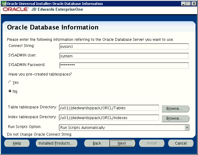

    Oracle Database Information - ASM = NO
    Surrounding text describes ppack_oracle_db_info_noasm.gif.
    The above screen and these steps are applicable if you chose ASM = NO on the Target Server Names screen in Step 14.
    • Connect String
    • SYSTEM User
    • SYSTEM Password
    • Table tablespace Directory
      Enter the mount point for the tablespaces of your JD Edwards EnterpriseOne database tables. For example:
      /u01/jdedwardsppack/ORCL/Tables
    • Index tablespace Directory
      Enter the mount point for the tablespaces of your JD Edwards EnterpriseOne database indexes. For example:
      /u01/jdedwardsppack/ORCL/Indexes
  19. Click the Next button.

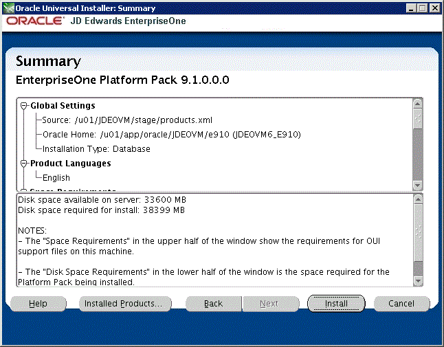

  20. On Summary, review and verify your installation choices.
  21. Click the Install button.

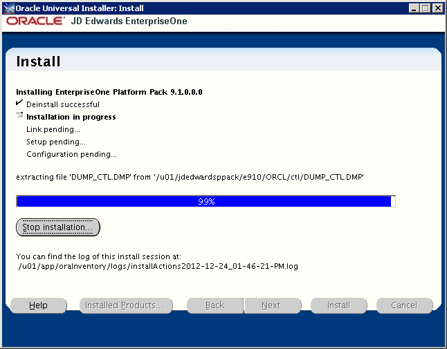

    Surrounding text describes ppack_progress.gif.
    The Platform Pack installer displays a progress screen. Also at the bottom of the screen, a message displays the location of the log file for this installation.
    Click the Stop installation ... button if you want to cancel the installation before it completes. Otherwise, the installer displays the following screen when it completes.

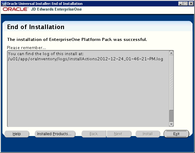

    Surrounding text describes ppack_end_install.gif.
  22. On End of Installation, verify the Platform Pack installation was successful. You should verify the OUI log files which are located in the path shown in the Please remember ... section. Also check the Oracle load logs which are located in this directory:
    /u01/jdedwardsppack/e910/ORCL
    Tip:
    It especially important that you check and verify the Import* logs.
    The above location is also where you will find this database script, which can be run manually:
    InstallOracleDatabase.sh
