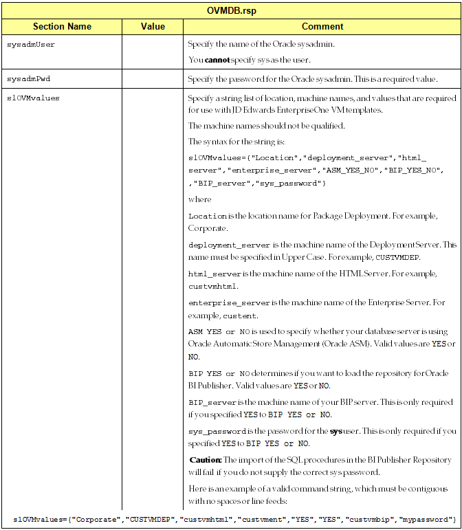

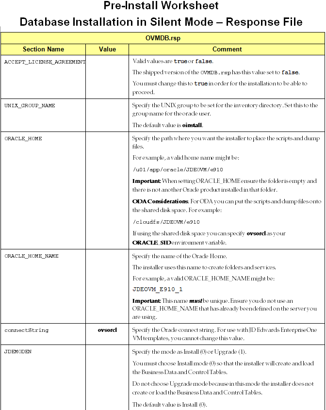

Edit the OVMDB.rsp response file to set valid parameters for your installation. Each section of the response file has comments to describe valid values. The entries that must be changed are at the top of the response file before the ###*###*### eye catcher.
The following figures contain the Pre-Install Worksheet for Database Installation in Silent Mode -- Response File. This Worksheet describes each section that you must modify or verify to be valid for your installation on a non-virtualized database server. Use the Worksheet to enter valid values for your installation.
Once edit, you should save and close the OVMDB.rsp response file.
