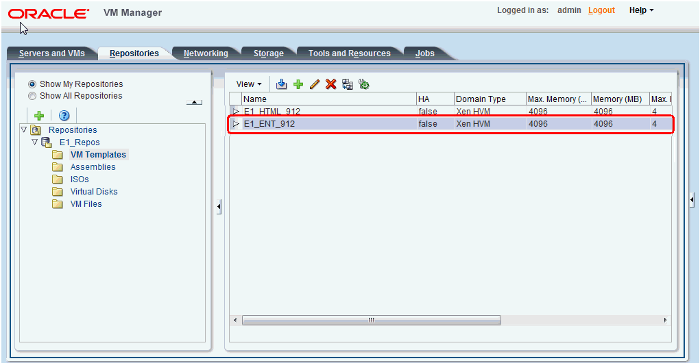

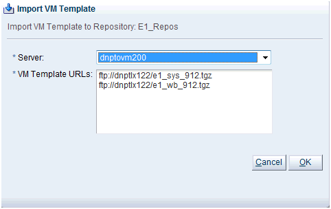

On Oracle VM Manager, on the Repositories tab, highlight the VM Templates node in the left pane and in the right pane click the Upload icon (blue downward arrow).
On Import VM Template, use the pulldown to enter the URL of the FTP server and the file to be uploaded. Enter each pair of the EnterpriseOne system image and one of the application images.
Server
Use the pulldown to select the target machine on which you want to import the VM Templates.
VM Template URLs
Enter the URLs to the FTP machine for each pair of JD Edwards EnterpriseOne VM Templates as listed in the table below. Refer to the section in this guide entitled: Section 4.4.1, "Working with the vm.cfg Files" for instructions on renaming the delivered *vm.cfg files appropriately.
| JD Edwards EnterpriseOne Template | Upload Files |
| Enterprise Server | E1_X86_SYS_9133.img
| Database Server | E1_X86_SYS_9133.img
Caution: The size of the Database Server image is approximately 11 GBs; depending on your network this image could take several hours to upload. |
| HTML Server | E1_X86_SYS_9133.img
| BI Publisher Server | E1_X86_SYS_9133.img
| Mobile Server | E1_X86_SYS_9133.img
Click the OK button to begin the import.

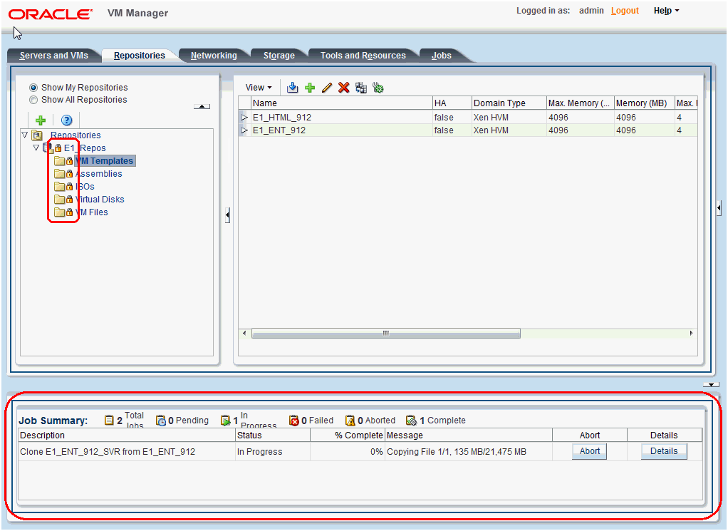

You can select the Jobs tab to check the progress of the import as shown in the following sample.

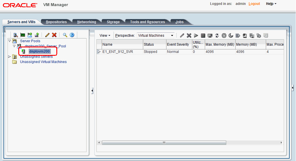

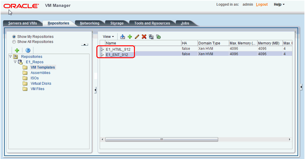

When the import successfully completes, the Oracle VM Manager shows the JD Edwards VM Template in the Job Summary section. The following sample shows the imported templates for JD Edwards EnterpriseOne HTML and Enterprise Servers.
The name of the template is derived from thevm.cfg file bundle within the application images.Once all three pairs of JD Edwards EnterpriseOne servers are imported, you can proceed to the next section to create VM Guests.

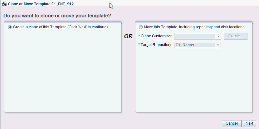

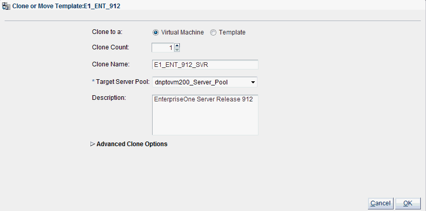

In order to get a functional VM Guest, you must use the procedure in this section to clone each template that you imported in the preceding section.
On Oracle VM Manager, on the Repositories tab, select the JD Edwards EntepriseOne template that you want to clone.
Click the Clone or Move icon.
On the Close or Move Template<name> popup, in the left pane select the radio button for this option:
Create a clone of this Template (Click 'Next' to continue)
Click the Next button.
On the second Close or Move Template<name> popup, complete these fields:
Clone to a:
Click the Virtual Machine radio button.
Clone Count
Set the count value to 1.
Clone Name
Enter a name for the clone. For example, E1_ENT_9133_SVR.
Target Server Pool
Use the pulldown to select a target server pool. For example, dnptovm200_server_pool.
Description
Enter a description for the clone.
The Advanced Clone Options are not used for JD Edwards EnterpriseOne OVM.Click the OK button.
With the Repositories tab selected, the Job Summary in the lower pane indicates the status and progress of the template cloning. In the upper left pane, Lock icons are displayed indicating that all files in the Repository are locked for changes. The Oracle VM Manager is still functional, but no changes to the Repository are allowed during cloning process.
Check the progress of the cloning process by selecting the Jobs tab. This may take several hours depending on the type of disk configuration you have.
Verify that when the cloning process completes that the new clone shows up as a new VM guest in the server pool as shown in the following example.
Repeat the cloning process for each of the EnterpriseOne templates:

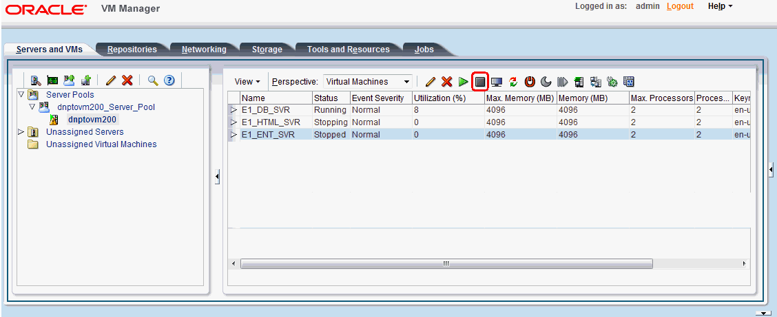

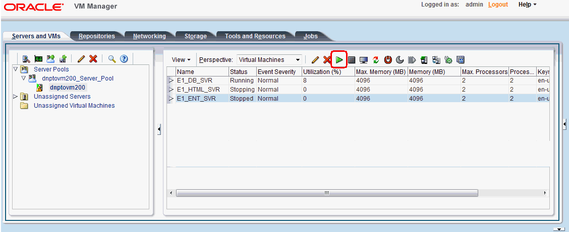

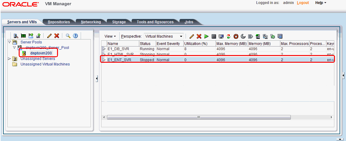

On Oracle VM Manager, open the Servers and VM tab and select the Server pool and then the host machine on which the VM guest is configured.
Click the Start icon (green triangle).
The VM Guests status will change from Stopped to Starting and then Running.
In this procedure you will run the EOne_cfg.ksh script to input information from the Configuration Worksheet and store it in a configuration file.

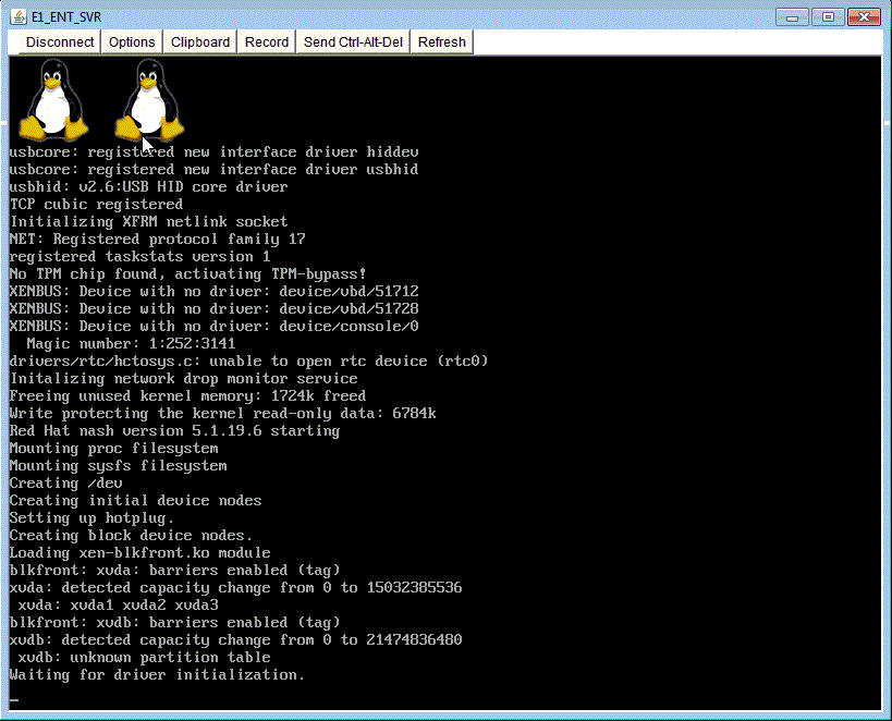

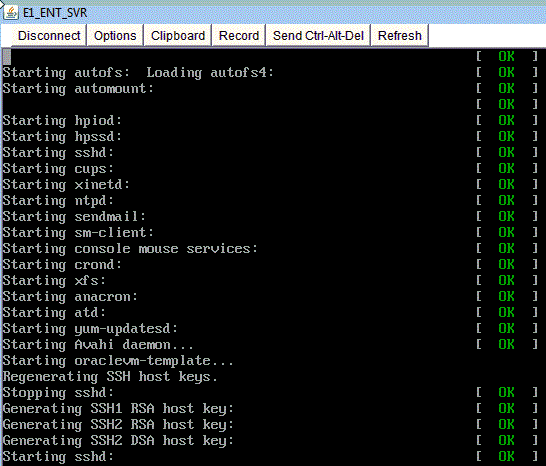

On Oracle VM Manager, with the Servers and VMs tab selected, while the VM guest is starting, select the Console icon to connect to the starting VM machine for the highlighted VM. In this example, that VM is E1_ENT_SVR.
The start up messages are displayed on the console.
The console continues to start up the VM Guest and displays startup messages with OK status.

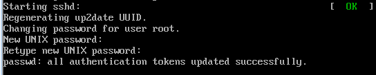

The system prompts the user for the root password. You must enter and retype a new password. Record this password using the security procedure applicable to your IT department.

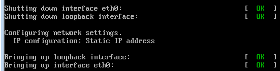

The system prompts the user for whether or not to configure DHCP. Enter ”n” and press return.
The system prompts for these values, which you should have recorded on the configuration worksheet for the server which you are starting and configuring:
static IP address
netmask
gateway
DNS server
Press return after entering each value.
The system configures the eth0 with the supplied network values and brings up the interface for eth0.

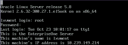

Login into the VM as the root user. The root user account has been configured to determine what type of EnterpriseOne application image and also the associated hostname and IP and upon successful login displays that information.

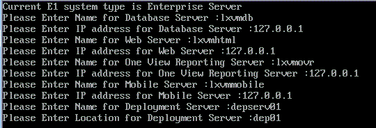

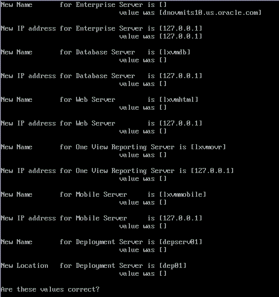

The script prompts for the following values (which should be recorded on the configuration Worksheet):
Name for Database Server
For example, lxvmdb.
Caution:
You must not use a fully qualified name. You can only use a 15 character alphanumeric string with no special characters.Note:
Regardless if you are using a non-virtualized database server, you must still supply a value here for the database name you are using.IP address for Database Server
For example, 127.0.0.1.
Regardless if you are using a non-virtualized database server, you must still supply a value here for the IP address of the database server you are using.Name for Web Server
For example, lxvmhtml.
Caution:
You must not use a fully qualified name. You can only use a 15 character alphanumeric string with no special characters.IP address for Web Server
Name for the One View Reporting Server (also called BIP Server)
For example, lxvmovr.
This value can be blank if you are not implementing this optional server.IP address for the One View Reporting Server (also called BIP Server)
This value can be blank if you are not implementing this optional server.Name for the Mobile Server (also called the BSSV Server)
For example, lxvmmobile.
This value can be blank if you are not implementing this optional server.IP address for the Mobile Server (also called the BSSV Server)
This value can be blank if you are not implementing this optional server.Name for Deployment Server
For example, depserv01.
Caution:
You must not use a fully qualified name. You can only use a 15 character alphanumeric string with no special characters.Caution:
The value you enter here must be a maximum of 15 alphanumeric characters (no special characters). You should not use the fully qualified name. If you enter a fully qualified name in this field, the system will accept the value. However, a failure within JD Edwards EnterpriseOne will occur when you attempt to run a UBE from the Development Client. If so, to remedy you should refer to the section of this guide entitled: Section 3.9.6, "UBE Submission Failed on the Development Client".Location for Deployment Server
For example, dep01.
Press enter after each value.
When done the script displays the configuration items and the values you provided. The script prompts the user to accept the values. If the values are correct enter a ”y” and press enter.
