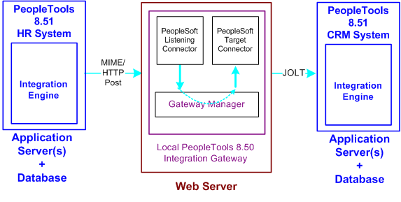

This section provides an overview of this scenario and discusses how to configure the system for this scenario.
Understanding This ScenarioThis diagram shows a PeopleSoft Human Resources system communicating with a PeopleSoft Customer Relationship Management (PeopleSoft CRM) system and shows the configuration and interaction of PeopleSoft Integration Broker components:
Integrations with PeopleSoft Integration Broker systems
This communication can be synchronous or asynchronous.
Configuring the System for This ScenarioThis section describes the source and destination system configuration tasks, based on the scenario shown in the previous diagram. In this example, the PeopleSoft Human Resources system is the source system and the PeopleSoft CRM system is the destination system.
This section discusses how to configure:
The integration gateway.
The PeopleSoft Human Resources system.
The PeopleSoft CRM system.
Configuring the Integration Gateway
The only required property that you must set for the local gateway is the Oracle Jolt connect strings that enable the gateway to find the PeopleSoft CRM system. Set this property in the integrationGateway.properties file.

Understanding This ScenarioA PeopleSoft Integration Broker hub configuration includes an integration engine that houses routing rules and transformations. All integrations are routed through the hub, which enables you to centralize routing rules and offload the transformation process.
This diagram shows a one-way hub configuration scenario that involves a PeopleSoft Human resources system and a PeopleSoft CRM system:
Integrations with PeopleSoft Integration Broker systems using a hub.
In this scenario, all of the routing rules and transformations are located on the hub.
To implement integrations between the two systems without a hub, you must set up a complete set of complementary routing rules and transformations on each node.

Configuring Generic-Routing Hubs
By using the elements in the previous diagram as an example, this section provides an overview of how to configure a generic-routing hub. In the scenario, the PeopleSoft Human Resources system, the PeopleSoft CRM system, and the hub must all point to the same integration gateway and use the same gateway URL.
The PeopleSoft hub.
The generic-routing hub.

Integrating with PeopleTools 8.47 and Earlier PeopleTools 8.4x SystemsThis section provides and overview of this scenario and discusses how to configure the system for this scenario.
Understanding This ScenarioThis diagram shows the PeopleSoft Integration Broker components and configuration for communications between PeopleSoft Integration Broker system and a PeopleSoft system running on PeopleTools 8.47:
Integrations with PeopleTools 8.47 and earlier systems.
While this diagram depicts a PeopleSoft 8.47 system, the information provided in this section applies to any PeopleTools 8.47 or earlier system.
In this example, the PeopleSoft Human Resources is the sending system and the PeopleSoft CRM system is the receiving system.
The remainder of this section highlights the integration tasks by using the systems and components shown in the diagram as examples.

Configuring the PeopleSoft Human Resources System
In this scenario, the PeopleSoft Human Resource system is running on PeopleTools 8.52.
On the PeopleSoft Human Resources system:
Define a local integration gateway.
Use the Gateways component to set up a local gateway for the PeopleSoft Human Resources system.
The only required properties are the Oracle Jolt connect string properties that enable communication with the PeopleSoft Human Resources systems. Set these properties in the integrationGateway.properties file
Set up a local node.
Use the Node Definition component to set up the local node, which represents the PeopleSoft 8.52 Human Resources system.
Set up a remote node.
The remote node that you set up represents the PeopleSoft 8.47 or earlier Human Resources system. When you set up the remote node, specify the PeopleSoft target connector (PSFTTARGET) on the Connectors tab.
Note. If you have upgraded from a PeopleSoft system, all nodes that existed for the system have been preserved as remote nodes in the PeopleSoft Integration Broker system. However, you must then associate each of these nodes to the PeopleSoft target connector for the remote note.
Create a service operation with an inbound routing definition.
Use the Service Operations component to create a service operation that contains an inbound routing definition where the receiving node is the PeopleSoft 8.52 system and the sending node is the PeopleSoft 8.47 or earlier system.
Set up an outbound routing definition.
In the service operation definition that you created in the previous step, create and outbound routing definition where the sending node is the PeopleSoft 8.52 system and the receiving node is the 8.47 or earlier system.
Configuring the PeopleSoft 8.47 or Earlier Human Resources System
