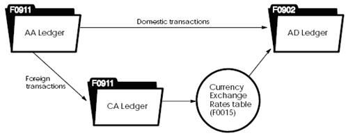

The following illustrates the process used to create "as if" balances:
Figure 39-1 Process to Create "As If" Balances
Description of Figure 39-1 follows
Description of "Figure 39-1 Process to Create "As If" Balances"

To restate account balances using a single exchange rate, run the "As If" Repost program. This program selects posted transactions entered in a foreign currency from the Account Ledger table (F0911).
This program recalculates the domestic amount by applying a new exchange rate to the CA (foreign amount) ledger type, and then creates the new amounts. Restated amounts are in a user-specified ledger type, generally the AD ("as if" restatement) ledger type, in the Account Balances table (F0902). Although the AD ledger is generally used, the "as if" ledger can be any user-specified ledger except AA, CA, XA, YA, ZA, or AZ. The program then moves domestic-only transactions to the new ledger type.

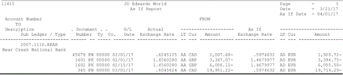

You can run this program as often as necessary. Rerunning the program overwrites existing balances, unless you specify a different destination ledger type. You can run this program in three modes:
Mode Description
Proof mode with report The system prints a report, but does not create balances in the destination ledger type.
Final mode with report The system creates balances in the destination ledger type and prints a detailed audit trail.
Final mode without report The system creates balances in the destination ledger type and does not print a detailed audit trail.

Incorrect or missing calculations If the report shows incorrect or missing conversion calculations, or fails to show expected detail, check that the required setup is complete and correct.
In addition, note that transactions originally entered in the domestic currency do not have an original or "as if" exchange rate. The source and destination amounts are the same. The DEMO version of this program processes domestic transactions and foreign transactions for the selected account range. Doing this ensures that all transactions in the AA (actual amounts) ledger type are transferred to the conversion ledger type.
