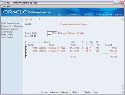

To review pro forma vouchers by payee
Figure 15-1 Review Vouchers by Payee screen

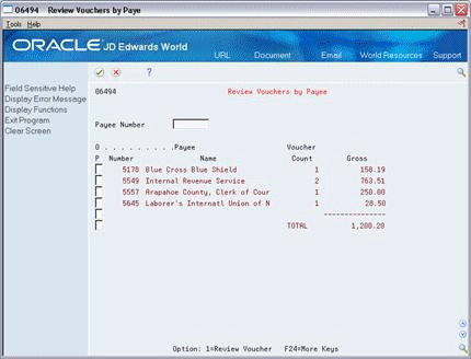

To limit the vouchers that appear, complete the following optional field and press Enter:
Payee Number
Choose the Review Voucher option.

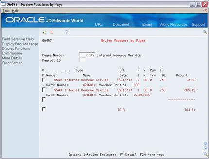

On the second Review Vouchers by Payee form, to limit the vouchers that appear complete the following optional field:
Payroll ID
Figure 15-3 Review Vouchers by Payee screen
Review the information in the following fields:
Batch Number
Voucher Control

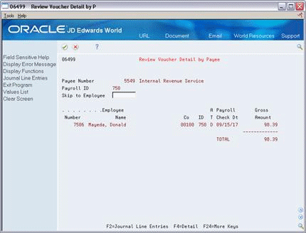

Choose the Review Employees option.
Figure 15-4 Review Voucher Detail by Payee screen
On the Review Voucher Detail by Payee form, choose the Detail function to review additional information.

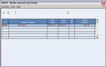

To view the journal entries associated with a voucher, choose the Journal Line Entries function.
Figure 15-5 Review Journal Line Entries screen
On Review Journal Line Entries, access the detail area to review additional information.

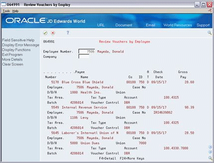

To review pro forma vouchers by employee
On Review Vouchers by Employee
Figure 15-6 Review Vouchers by Employee screen
Complete the following field:
Employee
To limit the vouchers that appear, complete the following optional field:
Company
Figure 15-7 Review Vouchers by Employee screen (Detail area)

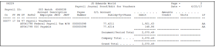

When you process the payroll journal entries step of the payroll cycle, the system prints the Payroll Journal Proof/Edit for Vouchers report. This report lists Payroll voucher entries for the T7 document type.
If you did not specify a payee for any tax type or DBA, this report contains a payee not specified message. When this error appears, the system does not create the pro forma voucher for that tax type or DBA. You must enter a payee for the tax type or DBA and then complete the steps for revising voucher information.
Figure 15-8 Payroll Journal Proof/Edit for Vouchers report

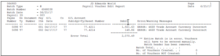

When you process the final update for a payroll cycle that includes vouchers, the Payroll system provides several reports that you can print to verify voucher information before you post the vouchers to the general ledger. You can also review reports that indicate whether the vouchers posted correctly.
During final update, the system automatically prints the following reports:
Payroll Voucher Edit report
Payroll Voucher Journal Detail report
Payroll Voucher Journal Summary report
You should also have printed the detail and summary journals during the print payroll cycle reports step of the payroll cycle. When the system prints these reports during final update, they include document numbers and pay items. You can use this information to verify voucher information before you post vouchers to the general ledger.
Use the Payroll Voucher Edit Report to determine whether any voucher-related errors occurred when the system created the actual vouchers during final update. This report lists payment items that are in error and conditions that require a warning. If no errors occurred, the system prints the message informing you there are no errors.
If you set up Enhanced Subledger Accounting, you can view these values on the report. See Work with Enhanced Subledger Accounting in the JD Edwards World General Accounting I Guide for more information.
This report prints two types of messages:

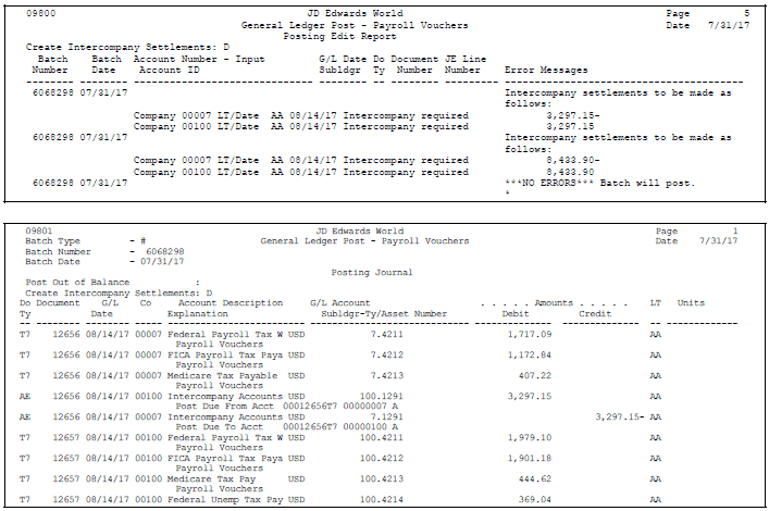

When you post vouchers, the system prints the following reports:
| Report | Description |
| Posting Edit report | Use the Posting Edit Report to determine whether the vouchers posted. When no errors occur during posting, the report contains a message that no errors were found and the system will post the batch. |
| General Ledger Post Payroll Vouchers report | Use the General Ledger Post Payroll Vouchers report to review posted vouchers. This report lists the following document types:
 T7 – The Payroll voucher entries AE – The offsetting credit entries to the accounts payable liability account that the system creates during posting  |
