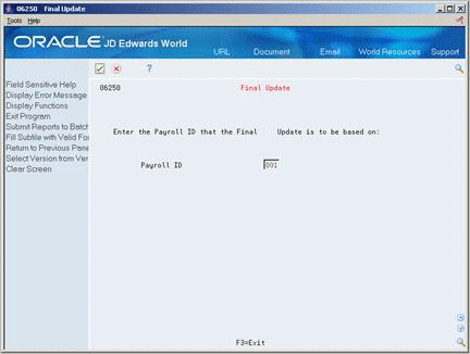

On the first Final Update form
Figure 29-2 Final Update screen
Description of Figure 29-2 follows
Description of ''Figure 29-2 Final Update screen''
  1. Complete the following field:
    • Payroll ID

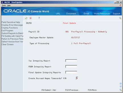

  2. On the second Final Update form, if you want to print integrity reports, enter a version in the following fields:
    • Tax Integrity Report
    • PDBA Integrity Report
    • Final Update Integrity Reports
  3. If your organization accumulates wages for employees on contract calendars, complete the following field:
    • Generate Accumulated Wages Timecards
    This field appears only when you activate contract calendars in the payroll constants.
  4. Choose the Submit Job function.

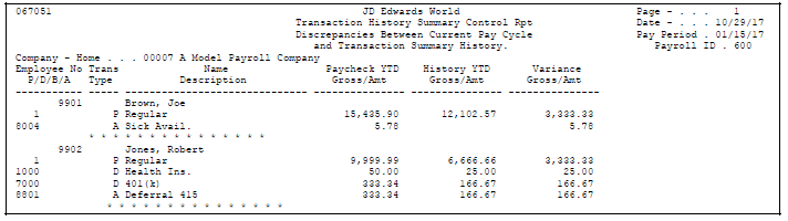

29.2.3 Reviewing the Transaction History Summary Control Report
The Transaction History Summary Control Report compares year-to-date PDBA amounts in the Paycheck Workfile (F063501) to the corresponding amounts in the Payroll Month PDBA Summary History table (F06146).
This report does not have error codes. The Variance column lists current DBA information that was not updated in the Payroll Month DBA Summary table.
