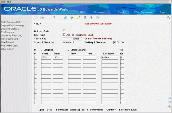

To define tax derivation rules
On Tax Derivation Table
Complete the following fields:
Key Type
Table Key
Complete the following optional fields to further define the tax rule:
Start Effective
Ending Effective
Complete the following fields to specify the account range for the rule:
Object From
Object Thru
Subsidiary From (optional)
Subsidiary Thru (optional)
Complete the following fields to specify the tax information for the rule:
Tax Rate
Tax Explanation
