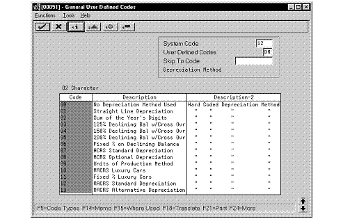

You must define a code for each German depreciation method you want to set up in user defined depreciation. You use the Depreciation Method user defined codes file (system 12, type DM) to define codes for user defined depreciation methods.
When you set up the Depreciation Method user defined codes file, you must do the following:
Use alpha codes to identify user-defined depreciation methods
Enter a 1 in the Special Handling Code field for each user-defined depreciation method
Enter an N in the Hard Coded Y/N field for each of user-defined depreciation method
To define codes for user defined depreciation
On any User Defined Codes screen
Figure 10-1 General User Defined Codes (Depreciation) screen
To access the user defined codes file for Depreciation Method, complete the following fields:
System Code
User Defined Codes
To define depreciation codes, complete the following fields:
Character Code
Description
Description 2
Access the detail area.
To identify the depreciation method as a user defined method, complete the following fields:
Hard Coded Y/N

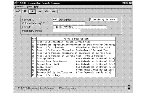

From Set Up User Defined Depreciation (G1232), choose Depreciation Formula Revisions
You can define or revise specific depreciation formulas for user defined depreciation methods. You assign the depreciation formulas to the life years you specify for the depreciation method. Use the four basic mathematical functions (+ - * /) and parentheses for nesting amounts or quantities to construct depreciation formulas in algebraic format.
The Fixed Assets system includes codes that you can use to represent the elements that the system uses to retrieve the related amounts or quantities from the Item Balance file, Item Master file, Date Pattern file, and so on. For example, you can define a depreciation method that is based on a formula that you create to subtract salvage value from cost.
You can access the Depreciation Formula Revision screen directly from the menu, or you can access the screen from Depreciation Rule Revision. For example, if you are revising depreciation rules, and you want to update a formula associated with the rule, you can access Depreciation Formula Revision to review and revise formulas you have previously defined without exiting from the Depreciation Rule Revision program.
User defined depreciation formulas must have alphabetic identifiers to distinguish them from J.D. Edwards base depreciation formulas. You can modify only the alpha formulas, but you can use the numeric formulas as a starting point to create your own formulas with alphabetic identifiers.Define the following formulas for German depreciation:
| Formula | Explanation |
| Salvage Value | The Salvage Value is the amount you expect to recover when you dispose of the asset. The salvage value is a key element in many depreciation methods. Define the Salvage Value formula as a percentage of the asset's acquisition cost. |
| Base/Limit | The Base/Limit is the total amount that can be depreciated over the life of an asset. Define the Base/Limit formula as the cost of the asset less its salvage value. |
| Assets acquired during the first half of year | Define a formula for assets that are placed in service in the first half of the company's fiscal year. The initial depreciation for the assets is computed for the entire year.
For example, the company's fiscal year is January through December and the asset is placed in service in April. The system computes the initial depreciation for the asset based on twelve months (January through December), rather than eight (April through December). |
| Assets acquired in the second half of year | Define a formula for assets that are placed in service in the second half of the company's fiscal year. The initial depreciation is computed for a half year.
For example, the company's fiscal year is January through December and the asset is placed in service in November. The system computes the initial depreciation for the asset based on six months (July through December), rather than the entire year. |
| Assets during second and subsequent years | Define a formula to compute the depreciation for all assets that are in service during the second and subsequent years. |
To define formulas for user defined depreciation
On Depreciation Formula Revision
Figure 10-2 Depreciation Formula Revision screen
To set up or review an existing formula, complete the following field:
Formula ID
Choose the field-sensitive help for Formula ID to review a list of valid formulas or to search for a specific formula by code or description.
To define or revise the formula, complete the following fields:
Description
Formula
Multiplier/Constant

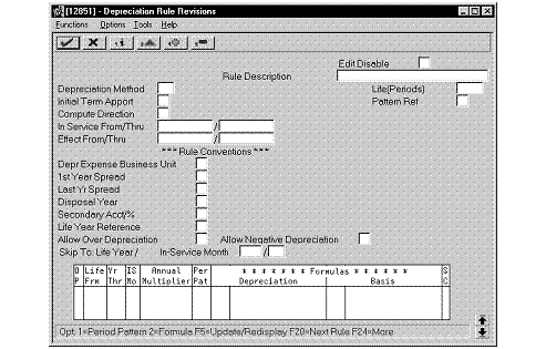

From Set Up User Defined Depreciation (G1232), choose Depreciation Rule Revisions
You must define the rules that you want the system to use when it calculates user defined depreciation for an asset. Depreciation rules consist of the following elements:
Reference information
Rule conventions
Life year rules
Formulas
You use reference information to tie a specific depreciation rule to an asset. The system uses the values that you specify to reference the specific depreciation method in which the rule is to be used. Reference information includes:
The code that identifies the method
Special characteristics of the rule
Period over which the asset cost is to be apportioned
Placed in service date for the asset
Date through which the method is effective
Rule conventions dictate how the system calculates depreciation based on the life year rules and formulas you specify for the rule. These conventions apply to the entire apportionment period referenced by the rule. You can set up rule conventions to:
Override the business unit destination of the depreciation expense.
Spread the first and last year of cost apportionment. For example, you can designate a rule to spread depreciation throughout the year, or spread the depreciation proportionate beginning with the depreciation start or end date.
Allow the utilization of a second annual rule.
Use the asset's life periods or the fiscal year as the beginning reference point in determining the current life year of an asset.
Depreciate more cost than exists for an asset.
Allow negative depreciation amounts to be computed in the formula during the life of an asset.
The basic equation for computing depreciation for a life year consists of a multiplier that is applied to a cost or basis. The resulting amount is subject to a minimum (base) and a maximum (limit). The basis amount that is multiplied might be subject to an overall floor or salvage value. The same rule might apply to multiple life years, or it might apply to a single life year of a cost.
You can define a rule for any asset life year. You can also define a separate rule for the disposal year of an asset.
The formulas that are used by the life year rules can be applied to any element in the depreciation equation, such as:
Multiplier
Depreciable basis
Base
Limit
Salvage value
To define depreciation rules for German depreciation methods
On Depreciation Rule Revisions
Figure 10-3 Depreciation Rule Revisions screen
To reference the depreciation rule, complete the following fields:
Depreciation Method
Life (Periods)
Initial Term Apportionment
Compute Direction
In Service From/Thru
Effective From/Thru
Pattern Reference
The Depreciation Method is the code identifier you defined on user defined codes file 12/48.
To define the conventions of the depreciation rule, complete any of the following fields:
Depreciation Expense Business Unit
First Year Spread
Last Year Spread
Disposal Year
Secondary Account/%
Life Year Reference
Allow Over Depreciation
Allow Negative Depreciation
To define the life year rules for the depreciation rule, complete the following fields:
Life Year-From
Life Year-Thru
In Service Month
Annual Multiplier
Period Pattern
Complete the following fields with the codes for the formulas that you want the system to use for each element of the depreciation equation:
Depreciation Formula-Multiplier
Depreciation Formula-Basis
Secondary Percentage Continuation
Use the formulas you defined on the Depreciation Formula Revisions screen as applicable.
Complete any of the following optional fields for additional formula specifications:
Depreciation Formula-Base
Depreciation Formula-Limit
Depreciation Formula-Salvage Value

| Asset Life Year - Through | The last year in the life of an asset to which the rule pertains. You can set up the detail annual rules beyond the life of the asset. Each rule must have a rule for contiguous years beginning with 1. A single record can represent several contiguous years, but the system does not allow duplicate years. |
| Placed In Service Period | This field refers to the month the asset is placed in service. You can specify rules by inclusive ranges. When you use the value of blank, the system continues to use the annual rule for the last specified placed in service month until it finds a higher placed in service month value.
The system uses the values you enter in this field as follows:
For example, if you set up annual rules for the Placed In Service Months of 01, 03, 06, and 09, the system uses the rule you specify for 01 during the first and second months, the rule you specify for 03 during the third, fourth, and fifth months, the rule you specify for 06 during the sixth, seventh, and eighth months, and the rule you specify for 09 for the remaining months. Valid values are blank, 01, 02, 03, 04, 05, 06, 07, 08, 09, 10, 11, and 12. |
| Annual Multiplier | A percentage that you can use as an element within a formula, or by itself. The system applies this percentage to the basis of an asset to derive depreciation. If no basis is defined for the asset, then the system applies this percentage to the cost.
Enter a value in this field as a decimal. For example, enter 10% as .10 and 150% as 1.5. |
| Spread Pattern Reference | The code for a specific depreciation spread pattern. A pattern determines how the annual depreciation amount is to be apportioned to periods within a year. You can designate spread patterns for individual years, or for a group of years. |
| Secondary % Continuation | Use this code to indicate whether an annual depreciation rule is a primary or secondary rule. |
