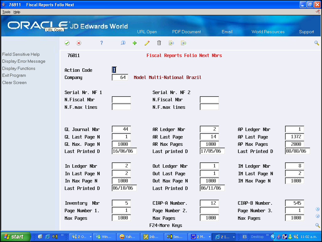

52.2.1 Setting Up Fiscal Reports Folio Next Numbers
Figure 52-1 Fiscal Reports Folio Next screen
Description of Figure 52-1 follows
Description of "Figure 52-1 Fiscal Reports Folio Next screen"
Complete the following fields:
Field Explanation
Serial Nr NF ¾ Serial Nr for corresponding Nota fiscal, can not be changed
N.Fiscal Nbr. In Brazil, Nota Fiscais are identified based on the combination of a Nota Fiscal number and a Nota Fiscal series number.
You use this numeric, six-character field to identify the Nota Fiscal number.
The Nota Fiscal printing process uses the field.
N.F. max lines Maximum quantity of detail lines used for the printing of Nota Fiscal
GL Journal Nbr General Journal number used for the opening period and ending period
GL Last Page N Last printed page number of the last general ledger journal report printed
GL Max. Page N This is the maximum pages number that is allowed for G/L journal report.
AR Ledger Nbr Accounts receivable ledger number used for the opening period and ending period
AR Last Page This is the Last Page Number used in the last A/R ledger printed
AR Max Pages Maximum number of pages allowed of the A/R Auxiliary Journal Ledger
AP Ledger Nbr Accounts payable ledger number used for the opening period and ending period
AP Last Page Last printed page number of the last accounts payable journal report printed
AP Max Pages Maximum number of pages allowed in the A/P Auxiliary Journal Ledger
Last Printed D (G/L, AR and AP) The last printed date of the report
In Ledger Nbr This is the book number of the Input Transaction Registry used in the period.
In Last Page N This is the Last Page Number used in the last Input Transactions Ledger
In Max Page N Maximum number of pages allowed of the Entry Record Book.
Out Ledger Nbr This is the book number of the Output Transaction Registry used in the period
Out Last Page Last printed page number of the last output transactions journal report
Out Max Page N Maximum number of pages allowed in the Exit Record Book.
IM Ledger Nbr Last used Book Number of Stock Movement.
IM Last Page N Inventory Management Journal last printed page
IM Max Page N Maximum number of pages allowed in the Inventory Record Book (Stock Movements).
Last Printed D Emission date of the last exit record.
Inventory Nbr Future use reserved number
CIAP-A Number Future use reserved number
CIAP-B Number Future use reserved number
Page Number User reserved page number

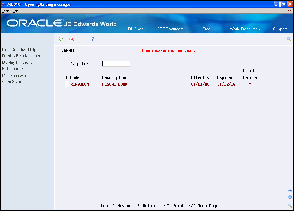

52.3.1 Setting up opening/ending messages
The message code has the following format:
  • Opening message: xxAyyyyy
  • Ending message: xxEyyyyy
    • xx is a hard coded value that identifies the fiscal book where that message will be printed.
    • yyyyy is the company number
The hard coded values to use for each report are:
  • DG = General Account Journal.
  • DP = Accounts Payable Auxiliary Journal.
  • DR = Accounts Receivable Auxiliary Journal.
  • RE = Entries Registry.
  • RS = Exits Registry.
  • LC = CIAP Book Registry - Model B
  • LA = CIAP Book Registry - Model A
  • RI = Inventory Registry.
  • RC = Verification Records of ICMS
  • RP = Verification Records of IPI
  • A: Indicates message will be at the beginning
  • E: Indicates message will be at the end
Example to create a code:
  • RI + A +Co number: RIA0001
Set up the following information:
Figure 52-2 Opening/Ending messages screen
Description of Figure 52-2 follows
Description of "Figure 52-2 Opening/Ending messages screen"
Do one of the following:
  • Access the detail area for a created text with option 1
  • Create a new message with option 1 in a blank line

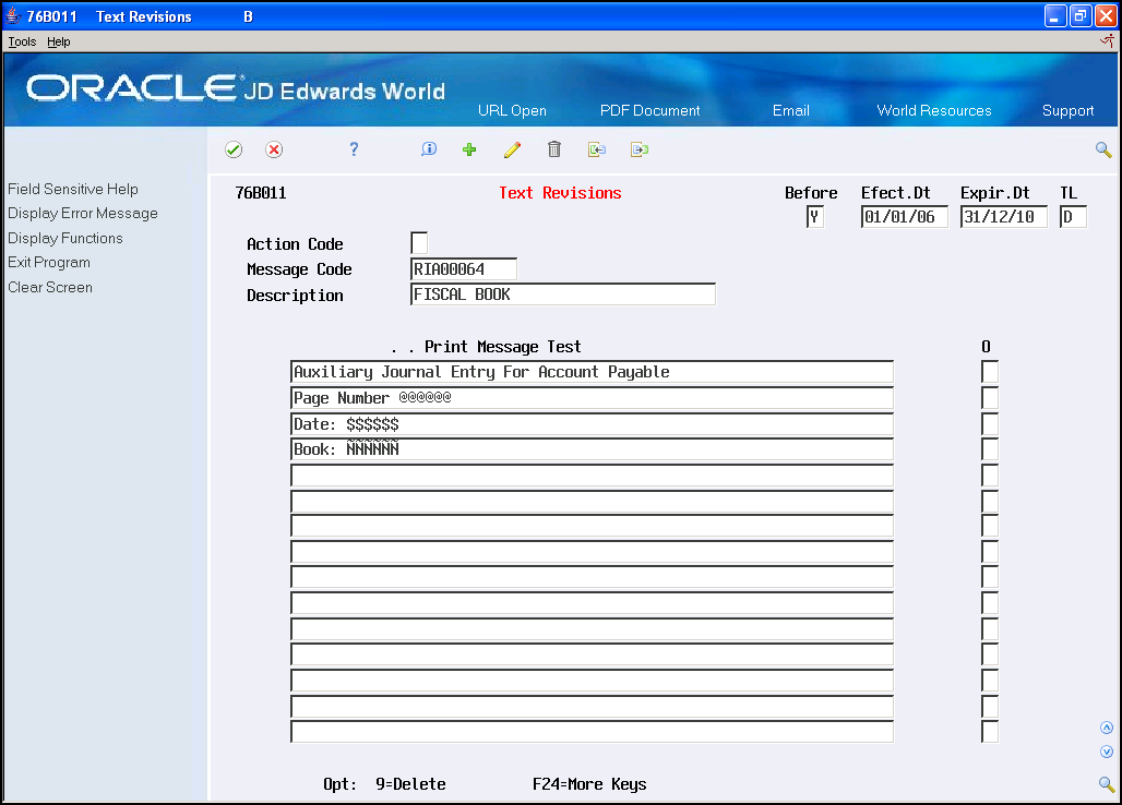

Figure 52-3 Tax Revisions screen
Description of Figure 52-3 follows
Description of "Figure 52-3 Tax Revisions screen"
Field Explanation
Before A one-character code that indicates whether the print message/item note text prints before or after the detail line on the order. The default is to print after the detail line
Efect.Dt The date when a text message becomes effective.
Expiration Dt The date on which a text message has expired or been completed
TL Line Type
Print Message Text to print, wildcards can be used to insert the printing of the following variable information:
@@@@@@: page number
$$$$$$: date
ÑÑÑÑÑÑ: book number
