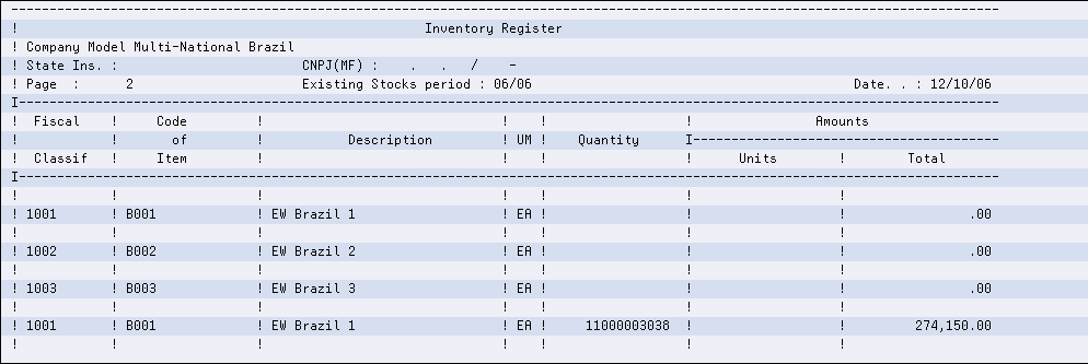

From Inventory Management Fiscal Reports - Brazil (G76B0020), choose 1 - Inventory Register
This report lists all fiscal classification/item quantity on hand, unit of measure, unit cost and total amount for a specific period.
It also summarizes total amounts for each record Type (UDC 76B/RT).
The program allows update of Fiscal Book Inventory Next Number and prints Beginning and Closing Messages (Access with RIA+Company, for example RIA00063).
First, you must create Stock Balance by Item end of Month (F76B4159)
Base File: F76B159 (Stock Balance by Item end of Month).
Selection data: User can define selection.
Figure 53-1 Report: Inventory Register - R76B460
See Section 69.25, "Processing Options for Inventory Register (P76B460)"

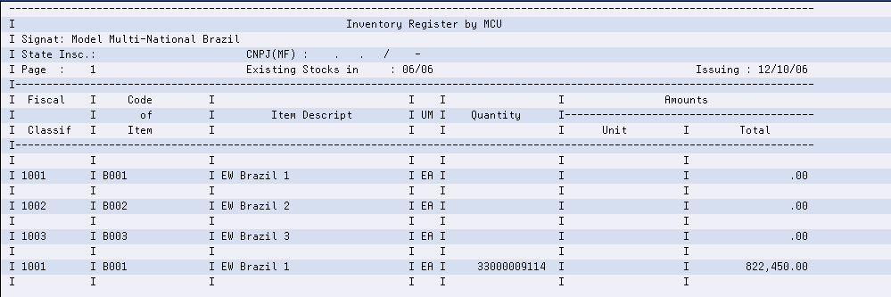

From Inventory Management Fiscal Reports - Brazil (G76B0020), choose 2 - Inventory register by MCU
This report lists all fiscal classification/item quantity on hand, unit of measure, unit cost and total amount for a specific period order by storage.
First, you must create Stock Balance by Item end of Month by MCU (F76B15)
Base File: F76B15 (Stock Balance by Item end of Month)
Sequence Data: Business Unit, Fiscal Year, Period, Fiscal Class
Figure 53-2 Report: Inventory Register - R76B461
See Section 69.26, "Processing Options for Inventory Register by MCU (P76B461)".

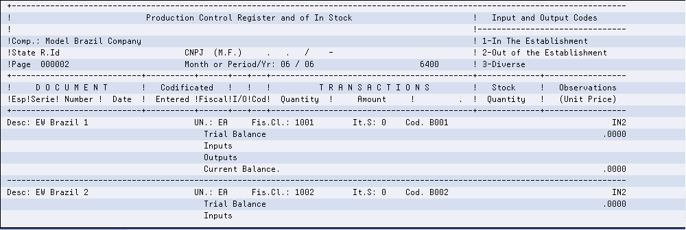

From Inventory Management Fiscal Reports - Brazil (G76B0020), choose 3 - Stock Production Register
This report lists all transactions history, such as sales, receipts or transfers for each item in the inventory in a specific period.
This is helpful to reconcile the inventory, to review number of transactions and to know localization information (such as Fiscal Classification, fiscal note number, series, and so on).
The report lists for each item all transactions information, such as quantity, document number, date, if it's and input or output movement, type of movement (1: In the establishment; 2: out of the establishment; 3: Diverse), amount, stock quantity, observations.
For each item you can find a total of input, output and balance amount.
The program prints Beginning and Closing Messages (Access with L3A+Company, for example L3A00063)
First you must create Stock Balance by Item end of Month by MCU (F76B15) and stock movements (F76B501)
Base File: F76B15 (Stock Balance by Item end of Month) and F76B501- Stock Movements.
This process updates the Stock Balance by Item end of Month with an * in Transaction Originator (QLTORG), so the program only selects the register that do not have * in that field.
Figure 53-3 Report: Inventory Register - R76B3021
See Section 69.27, "Processing Options for Transaction Report of Model 3 (P76B3021)".

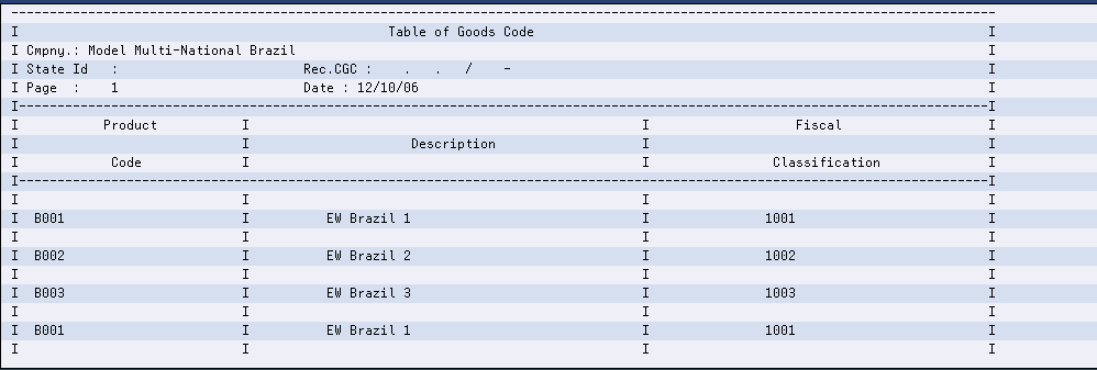

From Inventory Management Fiscal Reports - Brazil (G76B0020), choose 4 - Goods Coding Table
This report list all items codes, description and fiscal classification that have movements in the As Of item file.
First, you must create Stock Balance by Item end of Month by MCU (F76B15).
Base File: F76B15 (Stock Balance by Item end of Month). Selection Data: user defines which items must be printed.
Figure 53-4 Report: Goods Coding Table - R76B459
