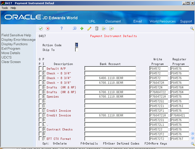

You can specify various output formats for automatic payments by assigning the programs that generate the formats to user-defined payment instruments. Payment formats can be printed or electronic. Payment instruments can include checks and drafts.
The programs that you assign to your payment instruments determine the formats for payments and any additional output that the system generates when you process payment groups. The additional output components can include:
Attachments, which are printed reports that contain the detail information that does not fit on a payment stub or in the specified fields of the electronic file.
Debit statements, which are printed lists of debit balances. Debit statements list net amounts that can either decrease or clear the amount of a voucher.
To assign formats to payment instruments, you specify a format generation program for each component of a payment instrument. For example, you could assign program P04573 (for print standard attachments) to the attachments component of your payment instrument for drafts. Then, when you generate drafts, the system accesses this program to produce the appropriate type of attachment.
You can also define the specific uses for a payment instrument by assigning a specific bank account to the instrument. For example, you can set up two types of payment instruments for drafts with each type drawn on a different bank account.
You may change the format of a payment just before printing a check. You can assign the format just before printing by choosing Revise from the Row menu on Work With Payment Instrument Defaults.
Assign the following programs to payment instruments for Brazil:
Set up a code on user defined codes table 00/PY for each payment instrument that you use and user defined codes table 04/PP for your payment programs. See Work with User Defined Codes in the JD Edwards World Technical Foundation Guide.
On Payment Instrument Defaults
Figure 50-2 Payment Instrument Defaults screen
Complete the following fields:
Payment Instrument
Write Program
Register Program
Complete the following optional field:
Bank Account
Choose the Details function.

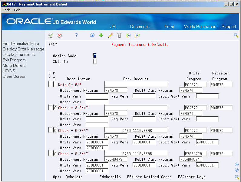

Figure 50-3 Payment Instrument Defaults screen (details function)
Attachment Program
Debit Stmt Program
To specify a particular version for a format program, complete the following fields:
Write Vers
Reg Vers
Debit Stmt Vers
Attch Vers
You can specify different versions of the Write, Register, Debit Statement and Attachment programs that you assign to your payment instruments. To do this, access the versions list to create a new version of the program. Then, on Payment Instrument Defaults, access the detail area and type the new version name in the appropriate Version field.

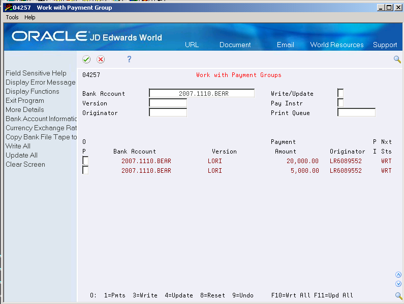

From the Automatic Payment Processing menu (G0413), choose Work with Payment Groups
Figure 50-4 Work with Payment Groups screen
Click the following options:
Write/Update Status
To further limit your search, complete the following field:
Bank Account
Version
Originator
Print Queue
Payment Instrument
| Field | Explanation |
| Write/Update Status | Indicates whether the payment records displayed are to be written and/or updated. |
| Bank Account | A field that identifies an account in the general ledger. You can use one of the following formats for account numbers:
Standard account number (business unit.object.subsidiary or flexible format) Third G/L number (maximum of 25 digits) 8-digit short account ID number Speed code The first character of the account indicates the format of the account number. You define the account format in the General Accounting Constants program. |
| Version | A version is a user-defined set of specifications. These specifications control how applications and reports run. You use versions to group and save a set of user-defined processing option values and/or data selection and sequencing options. Interactive versions are associated with applications (usually as a menu selection). Batch versions are associated with batch jobs ore report. To run a batch process you must choose a version. |
| Originator | The person who originally entered the transaction. |
| Print Queue | This is the print output queue for A/P payments. |
| Payment Instrument | The user defined code that determines the type of payment to be made to the supplier. |
An alternative to entering a value in a field on Additional Selection Criteria is to preset the value in a processing option. For example, if you want to review only those vouchers for business unit 100, you can preset that value in a processing option. This is particularly useful if you routinely review vouchers that meet certain search criteria.
