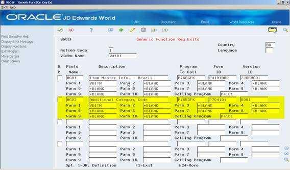

Additional Item Master Information (P704101) and Additional Item Branch Information (P704102) programs allow you to add additional information to your items.
You may want to set up generic function key exits to these programs so you can access them from Item Master (P4101) and Item Branch (P4102) Function Key 24.
Go to Generic Function Key Exits (P9601F)
Inquire on Item Master video (V4101)
Put a C (Change) in the Action Code (ACTN) and set up the function key exit as follows:
Figure 62-1 Generic Function Key Exits screen

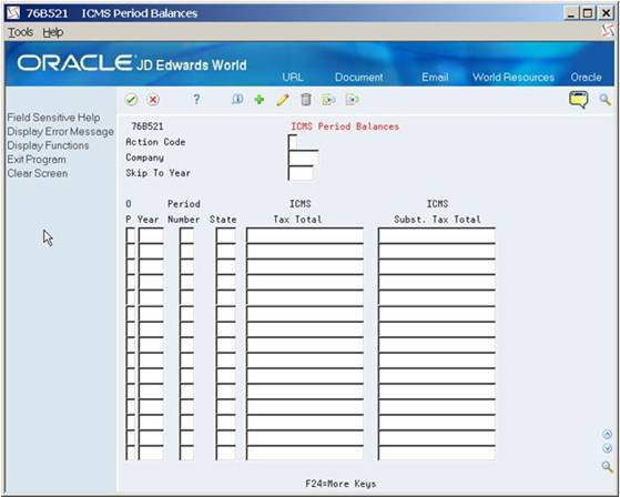

According to SPED Fiscal requirements, records E110 and E210 of Block E must contain information about the ending balances that are carried forward to the next period for ICMS and ICMS Substitution tax. For record E110, you must set up the ICMS balances for the state of the company. There should be one E210 record per state in which a company conducts business, so you must set up the ICMS balances for each state for the reporting company. The reporting company should be the Fiscal Company for which the report is being processed.
From Localizations - Brazil (G76B), choose Fiscal Books
From Fiscal Books (G76B00), choose SPED Fiscal Setup
From SPED Fiscal Set Setup (G76B0011), choose ICMS Period Balances
This information is stored in the F76B521 file.

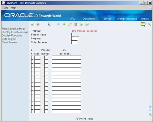

This program allows you to enter ending IPI tax balance information that is then carried forward to the next period. Data entered is stored in the F76B522 file.
From SPED Fiscal Set Setup (G76B0011), choose IPI Period Balances
