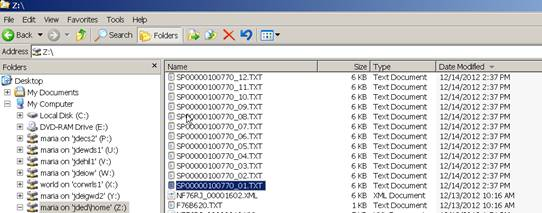

SPED Contabil IFS: 1 file created per period.
Figure 61-1 Figure File Created
Description of Figure 61-1 follows
Description of "Figure 61-1 Figure File Created"
