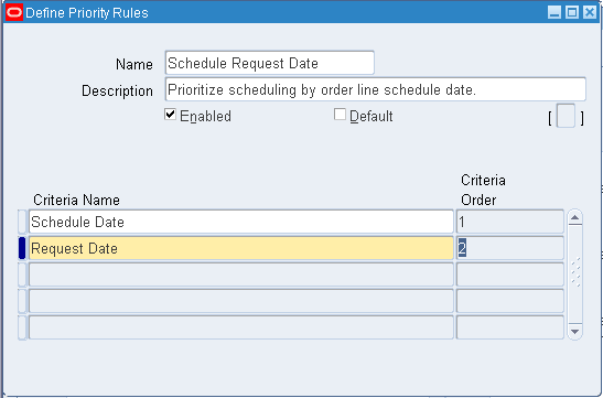

As a prerequisite, you must define at least one sequencing (priority) Rule before you use the Order Backlog Workbench. The terms sequencing rule and priority rule are used interchangeably.
Oracle Advanced Planning Solution uses priority rules to determine the processing order used when scheduling orders through the scheduler. You can:
Define a default scheduling order processing priority rule.
Disable a priority rule.
Define single or multiple criteria within a priority rule to further define the processing order that the scheduler uses during line scheduling.
Priority rules are not instance-specific. They are defined by selecting specific criteria that determine the order input to the scheduler.
Note: At least one priority rule must be defined prior to utilizing the Order Backlog Workbench for scheduling.
Enter a Name for the priority rule.
Enter a Description for the priority rule.
Select the Enabled checkbox to enable the priority rule to be used by the scheduler.
Choose whether the priority rule will be used as the default priority rule when the schedule is executed.
Select the Default checkbox to use the priority rule as the default rule.
Note: If another priority rule was defined as the default priority rule and you select the Default check box, you will see a decision box asking if you want to update the current default priority rule to the rule you are currently modifying. Select Yes to update your default priority rule.
Select the criteria name of the priority rule in the Criteria Name field. Values are:
Promise Date
Request Date
Sales Order and MDS Entities priority
Scheduled Date
Select the criteria processing order that the scheduler will use when scheduling order lines. Enter a numeric value in the Criteria Priority field.
Save your work.
Note: Once a priority rule is successfully saved, you can only update:
The Enabled checkbox
The Default checkbox
You can add additional criteria to the priority rule.

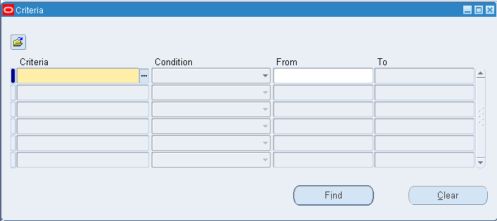

The Criteria folder window appears. The window title is Criteria.
Criteria Window
Create your order selection criteria for scheduling. Order selection is determined by current order line status and the filter criteria you defined.
Order lines that have a current status of Shipped or Cancelled are not selected for simulated scheduling.
Order lines whose source is External, for example, drop-ship order line are also not selected for simulated scheduling.
The Schedule Orders window uses Oracle Applications Folder technology to save filter criteria for reuse. Users can create filter criteria and save it to a folder, or they can query an existing folder and modify the filter criteria. You are not allowed to enter filter criteria for scheduling without first saving the criteria to a folder.
Either edit the filter criteria for the folder selected, or enter new filter criteria. Select the Field name from the list of values for Task:
