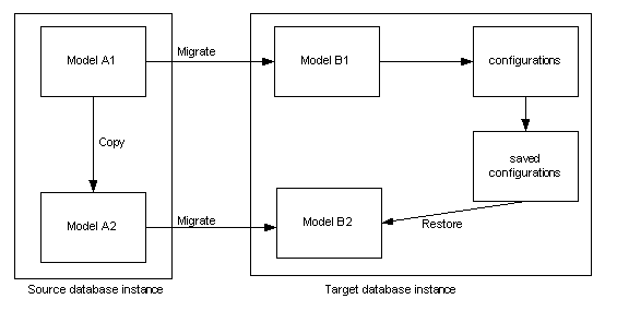

The following illustration shows what happens when a saved configuration is restored against a Model that has been migrated to and changed in another instance after the configuration was saved.
Restoring Saved Configurations Created from a Migrated Model
Model A1 is migrated to another instance as Model B1. Configurations are made against Model B1. A copy of Model A1 is made on the source instance (Model A2). At a later time Model A2 is migrated to the same target instance (Model B2). When the saved configurations are restored, they are restored against Model B2 (the most recent version of the Model).
Usually, Model node names are unique within an individual tree level and can be used when restoring configurations. Occasionally, the node name matching may fail. If you want to restore configurations that were saved against a Model that has been migrated, you must run either the Add Model Node Names to Configurations by Model Items or the Add Model Node Names to Configurations by Product Key concurrent program.
