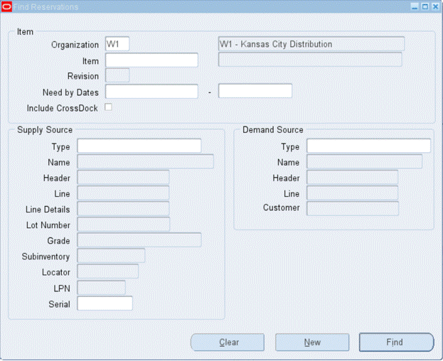

To create a reservation in the Item Reservation window:
Navigate to the Inventory responsibility, On-hand, Availability, and then Reservations.
The Find Reservations window appears.
Select an organization.
Click New.

Two procedures to access items on the Reservations page are as follows:
Procedure 1
Log in to Oracle Inventory Management using the Manufacturing and Distribution Manager Vision Project Mfg (EUR) Standard responsibility.
Click Order Management, Shipping, and then Plan Fulfillment.
On the Item Reservations tab, select the items you want to display on the Reservations page.
Click Actions, and then Manage Reservations.
The items you selected are displayed on the Reservations page.
Procedure 2
Log in using the Warehouse Manager responsibility.
Click Outbound Logistics, and then Plan Fulfillment.
For more information about setting up the navigation, see Setting Up Oracle Warehouse Management Information Discovery in Oracle E-Business Suite Information Discovery Integration and System Administration Guide.
All forms-based Reservations features, except creating reservations, are present in the simplified Reservations page, but in a different layout.
