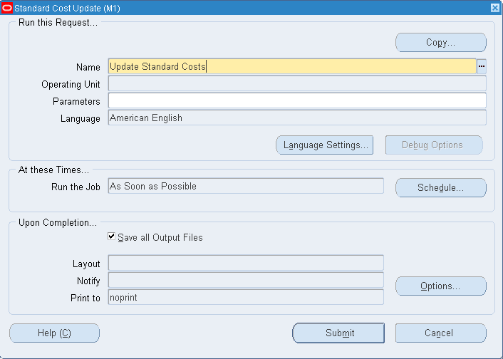

The standard cost update procedure lets you define and roll up pending costs, simulate changes to standard costs for analysis, and then update pending costs to the Frozen standard cost type.
Note: You can also update costs using the Supply Chain Cost Rollup. This cost rollup enables you to roll up costs across multiple organizations connected to sourcing rules. You can preserve the buy cost detail visibility and use a lot size multiplier in calculations. See: Rolling Up Supply Chain Costs
If possible, run your cost update at the beginning of your inventory accounting period before transactions have started for the new period.
To update standard costs, define costs and rates, and run the following procedures:
Define a cost type for pending standard costs.
Define pending costs for each of the cost elements: material (inventory items: both components and assemblies), material overhead, resources, overhead, and outside processing.
If you have changed your activity rates, as well as the base material overhead on these activity rates, then you must run the activity mass edit to recalculate the activity based material overhead.
You can also define pending rates for resources and overhead.
Roll up pending costs. This adds up pending costs for all cost elements of an assembly and creates a new pending cost for the assembly.
Print and review preliminary adjustment reports to see potential changes to the frozen standard costs.
Update pending costs to frozen standard costs.
(Optional) Print new standard cost reports.

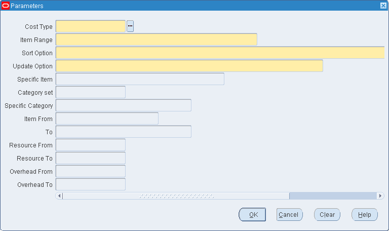

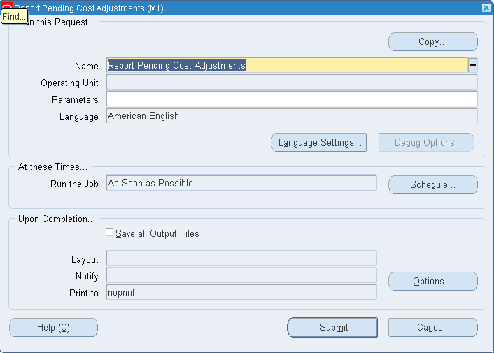

Report pending adjustments to simulate a change in standard costs. This launches two processes, one to simulate a cost update from the cost type that you specify to the Frozen cost type, and one to launch the Inventory, Intransit, and WIP Standard Cost Adjustment reports. These reports enable you to preview the changes that the standard cost update would perform for current inventory balances. These same three reports are run as part of a cost update. In this case, the reports show adjustments made to the inventory valuation by the cost update process.
To report pending adjustments
Navigate to the Report Pending Cost Adjustments window.

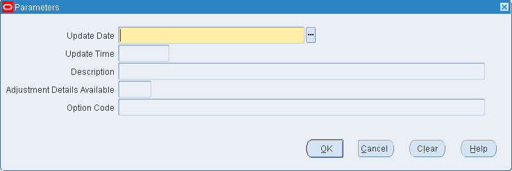

In the Parameters window, select a Cost Type.
Select an item range to perform a simulated standard cost update and generate preliminary adjustment reports for:
All items: This is the default.
Based on rollup items: Items that have Based on Rollup turned on in the Frozen cost type. This is only available if you use Inventory with Bills of Material.
Category: All items in a category you specify.
Not based on rollup items: Items that have Based on Rollup turned off in the Frozen cost type. This is only available if you use Inventory with Bills of Material.
Range of items: Range of items you specify.
Specific item: Specific item you specify.
Zero cost items: Items with zero cost in the Frozen cost type.
Select a sort option for the adjustment reports: by category, by item, or by subinventory (default).
Item costs only: This is the default.
Resource, overhead, and item costs: This is only available if you use Inventory with Bills of Material. If you use WIP, choose this option to reflect resource and overhead cost changes for actual charges to standard and non-standard asset jobs.
Do one of the following:
If you selected Specific item in the Item Range field, enter the specific item to include in the simulated cost update.
If you selected Category in the Item Range field, enter a specific category.
If you selected Range of items in the Item Range field, enter values for Item From and Item To. A simulated standard cost update is performed for all items in this range, inclusive.

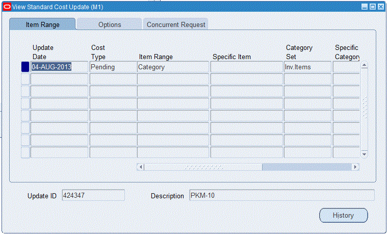

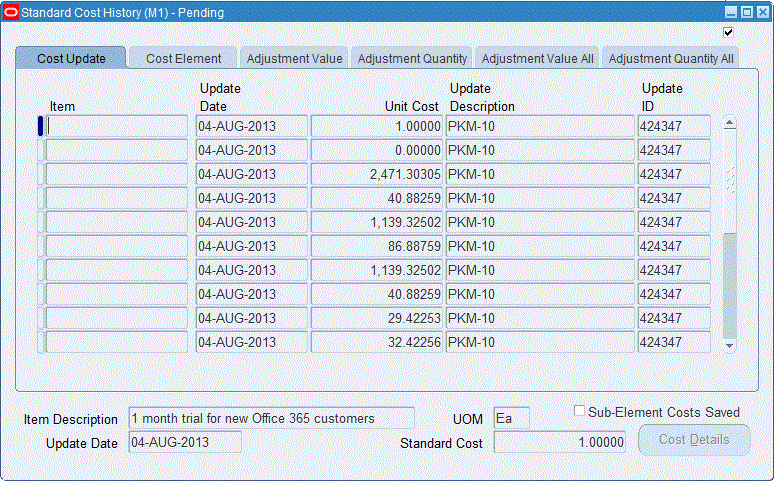

Updating pending costs to Frozen standard costs does the following:
Updates the existing standard costs with the costs created in the new cost type and creates the resulting adjustment accounting entries.
If you use Work in Process, the cost update revalues discrete job balances, creates accounting adjustments, and prints the adjustments along with the new job values in its report.

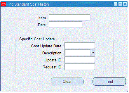

Creates item cost history.

Navigate to the Update Standard Cost window.
Cost information (a set of costs for items, activities, resources, outside processing, and overhead) is copied from this cost type into the Frozen cost type.
This account is used to collect the changes in value to each item, and to automatically generate transactions that adjust your inventory accounts. Your inventory is adjusted by subinventory and elemental cost account. Your discrete WIP is adjusted by job and cost element account. The WIP accounting class defines the adjustment account for your discrete jobs.
Optionally, enter a Description.
Select an Item Range option. The options are as follows:
Category: All items in a selected category.
Select a Sort Option for the adjustment report. The options are as follows:
Item: By item
Category, Item: By category, then by item within the category
Subinventory, Item: By subinventory, then by item within the subinventory (Default)
If you selected All Items for Item Range, select an update option: either Overhead, resource, activity, and item costs, or Resource, overhead, and item costs.
Overhead, resource, activity, and item costs:
Activity and item Costs:
If you selected Specific item for the Item Range, select the Specific Item to be updated.
If you selected Category for the Item Range, do one of the following:
Select a Category Set. The default is the category set defined for the costing functional area.
Select a specific category.
If you selected Range of items in the Item Range field, select beginning and ending Item From and To values. Standard costs are updated for all items in this range, inclusive.
Indicate whether to save details. Selecting Yes saves a snapshot of the inventory and WIP on-hand quantities cost update details. If you select Yes, then you can rerun the adjustment reports as long as you choose to maintain the details.
You can purge standard cost history to delete these details.
Indicate whether or not to Delete Resource Overhead. Selecting 'Yes' deletes any associations through the resource and overhead list. In order for a resource overhead association to qualify for deletion, you must ensure that both the overhead and the resource have been selected.
Note: If you do not provide a specific range in the resource / overhead parameters, then all resource-overhead associations that are not present in the user defined cost type will be deleted from the frozen cost type.
Use this option to track item cost history at the cost sub-element level. Select Yes to enable tracking costs at the sub-element level. The default value is No. The next run will use the chosen value from the prior run as the default value.

To report cost update adjustments
Navigate to the Report Standard Cost Adjustments window.
This submits the Historical Intransit Standard Cost, Historical WIP Standard Cost Adjustment, and Historical Inventory Standard Cost reports.
In the Parameters window, enter the date and a time of a previous cost update.
Select a report Sort Option. The options are as follows:
Item: By item
Select a Cost Type.
To restrict the report to a range of items, select a beginning and ending Item.
Related Topics
Standard Request Submission, Oracle Applications User's Guide.
View standard cost history and inventory adjustment values and quantities for your items. All historical cost information for your items is displayed for each cost update, even if you did not choose to save cost update details. All item costs updated or defined using the Define Item Cost window are also displayed.
If you share costs and are accessing this window from the master costing organization, you can choose to view the adjustment values for the current organization only or for all organizations that share the same standard costs. If you access this window from a child organization (non-cost master organization), you can only view the adjustment values for that organization.
Prerequisites
To view standard cost history
Navigate to the View Cost History window. The Find Standard Cost History window appears.
Enter your search criteria.
Choose Find to initiate the search, and choose History to view the Standard Cost History window.
The Standard Cost History window lists item cost updates. There are four tabbed regions: Cost Update, Cost Elements, Adjustment Values, and Adjustment Quantity. The Adjustment Values and Adjustment Quantity tabbed regions are available for the current organization. They are available for all organizations if you are in the costing master organization and there are child organizations that point to the master for cost information. Select the Sub-Element Costs Saved checkbox to view sub-element cost update history.
The Cost Update tabbed region displays the update date, the unit cost, the update description, and the update ID.
The Cost Elements tabbed region displays cost element information.
The Adjustment Values tabbed region displays the update date, the inventory and intransit adjustment values, and, if you use WIP, the WIP adjustment value.
The Adjustment Quantity tabbed region displays the update date, the inventory and intransit adjustment quantities, and, if you use WIP, the WIP adjustment quantity.

View previous standard cost update requests, options, and ranges.
Prerequisites
To view a standard cost updates
Navigate to the View Standard Cost Update window.
Enter information by which to find a previous standard cost update to view.
Choose the History button to view previous standard cost update requests.

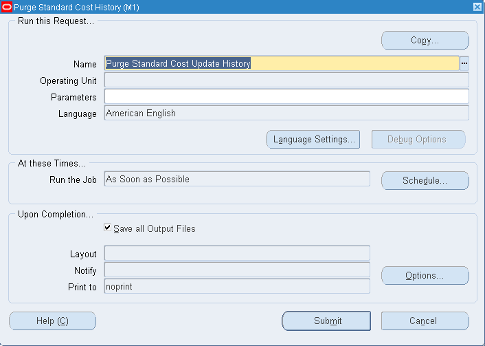

When you update costs and choose to save details, information associated with the update is retained so that you can rerun adjustment reports. When you no longer need such information, you can purge it. Purging Standard Cost Update History also purges sub-element cost details.
Prerequisites
To purge standard cost update history
Navigate to the Purge Standard Cost History window.
Enter the date and time of a standard cost update to purge.
Select to purge only the cost update adjustment details available, only the item cost history, or both.
Important: If you choose to purge the item cost history, then note that this impacts the period close summarization values. In the absence of item cost history, the period close summarization process assumes zero as the standard cost for the item at the end of the period that is being summarized.
