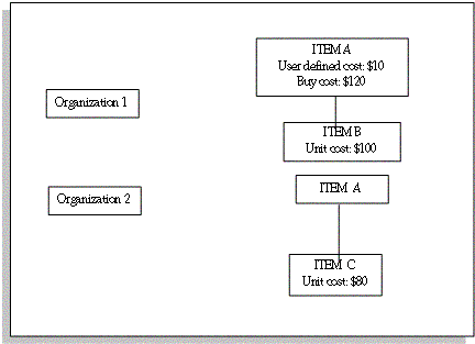

Example of Process Flow for Supply Chain Cost Rollup
A bill of material structure is defined at Organization 1 and Organization 2. Before the Supply Chain Cost Rollup program is submitted:
Item A (at Organization 1) has a user defined cost of $10, and a buy cost defined as $120.
The unit cost for Item B is $100.
The Unit cost for Item C (at Organization 2) is $80.
The Transfer Charge Type percentage is defined as 10 percent when transferring from Organization 2, to Organization 1. The sourcing rule is defined for Item a in organization 1 as the following:
| Source | Rank | Percentage |
| Make at Organization 1 | 1 | 50 |
| Transfer from Organization 2 | 1 | 25 |
| Buy | 1 | 25 |

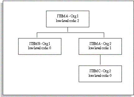

When a full cost rollup is submitted for item A, the following process flow occurs:
A supply chain bill of material explosion is performed and the low level codes are assigned, The program starts with Item B in Organization 1, and Item C in Organization 2 - and then rolls up the cost for Item A in Organization 2. Then it completes by rolling up and merging costs for Item A in Organization 1.
The costs of Item A at Organization 1 are calculated with a total unit cost of $112. The following information is used::

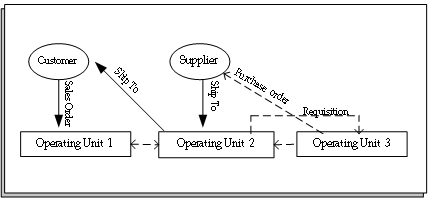

When a transfer occurs between two inventory organizations that belong to two different operating units (that may or may not belong to the same ledger), the transfer is considered to be intercompany. Release 11i9 introduced an option that enables you to generate intercompany invoices for this type of transfer.
The system generates intercompany invoices for internal sales orders (ISOs) with intermediate nodes. This means that:
An internal sales order involving physical movement of goods is placed between organizations in two operating units.
The financial transactions may flow between one or more different internal operating units (nodes) within the larger corporate structure.
Each intermediary node generates an invoice to the next organization in the chain, effectively requiring each transfer of ownership to be accounted for with separate intercompany invoices at the appropriate transfer price.
In addition to the inventory accounting of the physical intercompany shipment and receipt transactions, the logical transactions representing the financial flow is also appropriately accounted at the transfer price between the nodes.
Return logistics between the operating units with intermediate nodes is managed with reversals in inventory accounting and invoicing.
Along with the invoicing option, the release introduced a transfer pricing mechanism to value the transfers. You can use either the transfer price as the incoming cost, or use the sending organization cost as the incoming cost in the destination organization. However, the inter-company accounting option is available only for transfers created using internal orders.
In the case of transfer with intercompany invoicing and transfer prices, the accounting entries generated are different from those that are generated for a transfer without the intercompany invoicing option. The accounting entries are also different from those that are generated for a transfer between inventory organizations belonging to the same operating unit as in examples 2a & 2b.
The following two sections illustrate how the inter-company transfers are accounted for inter-company transfers between process and discrete organizations.

The following flow of activities demonstrates this scenario for complex intercompany invoicing:
Operating Unit 1 (OU1) receives a sales order from a customer.
Order price is $25.
The material is shipped to the customer from Operating Unit 2 (OU2) warehouse.
OU2 does not stock the material. Global Agreement Rules dictate that the item is procured by Operating Unit 3 (OU3).
OU2 creates a requisition to OU3 to purchase the material.
OU3 creates purchase order to the Supplier.
Purchase order price is $10.
The Supplier ships the material OU2:
OU2 has the physical receipt of the material.
OU3 creates PO Receipt transaction because it purchased the material.
OU3 also creates a shipping transaction to OU2.
The transfer price is $15
OU1 created the sales order, and performs the shipping transaction to the customer.
The material is physically shipped from OU2
A transfer transaction is created from OU2 to OU1,at a Transfer price of $20.
A receipt transaction is created in OU1.
The accounting for this example for intercompany transactions follows this flow:
Operating Unit 3
Receipt Transaction
| Receiving Processor | Debit | Credit |
| OU1 Clearing | 10 | - |
| Accrual | - | 10 |
| Cost Processor | Debit | Credit |
| OU2 Inventory | 10 | - |
| OU1 Clearing | - | 10 |
| Invoicing | Debit | Credit |
| Intercompany Receivable | 15 | - |
| Intercompany Revenue | - | 15 |
| Intercompany Cost of Goods (COGS) | 10 | - |
| OU2 Inventory | - | 10 |
Operating Unit 2
Receipt Transaction
| OU1 Clearing | 15 | - |
| Intercompany Accrual | - | 15 |
| Intercompany Invoicing | Debit | Credit |
| Intercompany Accrual | 15 | - |
| Intercompany Payable | - | 15 |
Deliver Transaction
| OU1 Inventory | 15 | - |
| OU1 Receipt | - | 15 |
Shipping Transaction
| Intercompany Receivable | 20 | - |
| OU1 Intercompany Revenue | - | 20 |
| Intercompany COGS | 15 | - |
| OU1 Inventory | - | 15 |
Operating Unit 1
| OU3 Inventory | 20 | - |
| OU1 Inventory | - | 20 |
| Intercompany Accrual | 20 | - |
| Intercompany Payable | - | 20 |
| OU3 COGS | 20 | - |
| OU3 Inventory | - | 20 |
| Accounts Receivable Invoicing | Debit | Credit |
| OU3 Receivable | 25 | - |
| OU3 Revenue | - | 25 |
