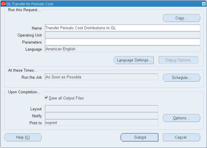

You can choose to create Periodic Costing distributions and send them to the General ledger after a Periodic Costing run. You can also disable the perpetual costing General Ledger transfer, electing instead to produce accounting entries only after a Periodic Costing run.

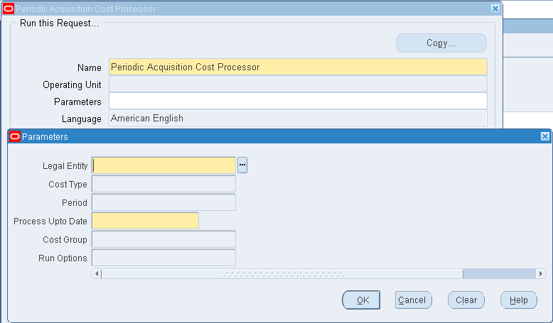

Acquisition Costing: The Periodic Costing processor uses acquisition costs (including additional charges such as freight, customs, and insurance) to value receipts and returns. If no invoice is matched to the receipt at the time the cost processor is run, the PO price is used. You can view receipts that use PO Cost and make any corrections necessary.

Periodic Costing Distributions: You can choose to post periodic distributions or perpetual costing distributions to the General Ledger. While it is not recommended, you could also post both distributions to the General Ledger.

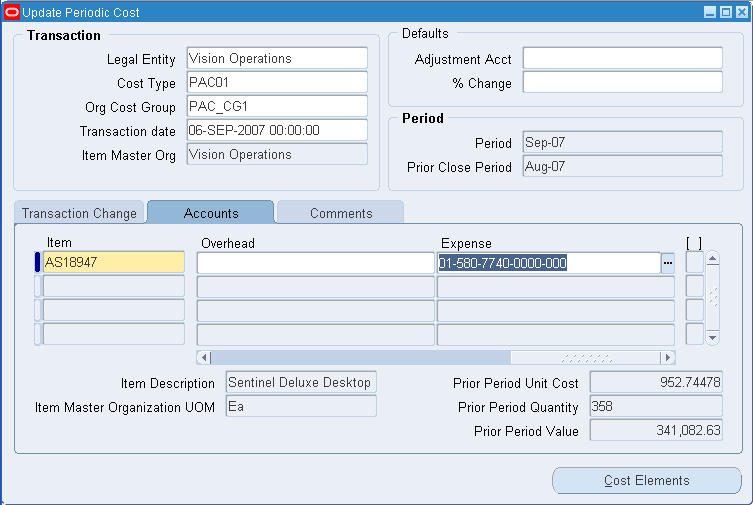

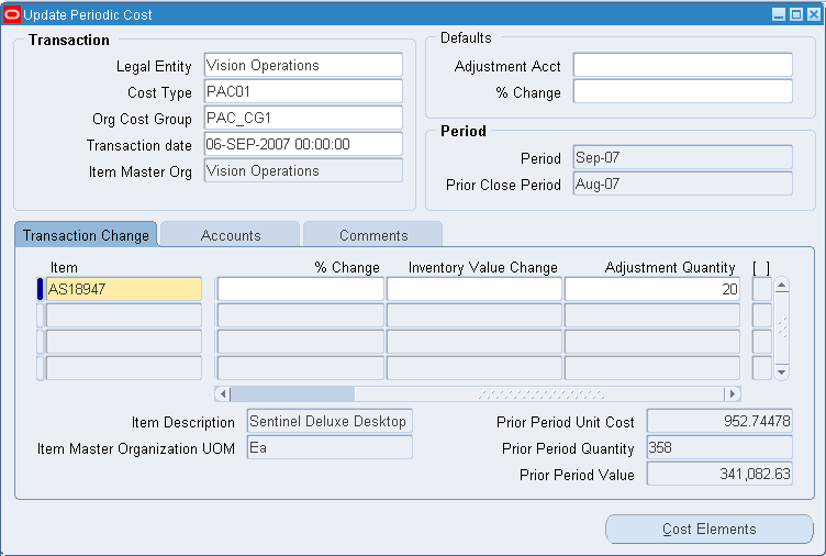

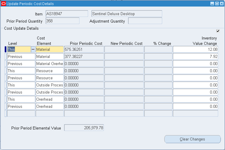

You can manually change the periodic cost of an item by performing a periodic cost update.

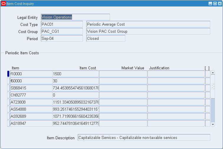

You use the Item Cost Inquiry screen to compare the calculated LIFO item cost with a published market value. See: Making Item Cost Inquiries.
For more information on calculating a LIFO item cost, See: Periodic Incremental LIFO Calculations.
If the market value is less than the calculated LIFO item cost, then you can enter that value along with a mandatory justification. This market value replaces the calculated LIFO item cost for quantities in all period cost layers and in the Incremental LIFO Valuation reports run at this time.
You can update and remove the market value and justification until the period is closed.
The inventory valuation that is carried forward is now based on that market value. Previous layers do not figure in future calculations, but they are not purged, so that you can still run reports from prior periods, for auditing purposes and to maintain historical records of Incremental LIFO quantities.

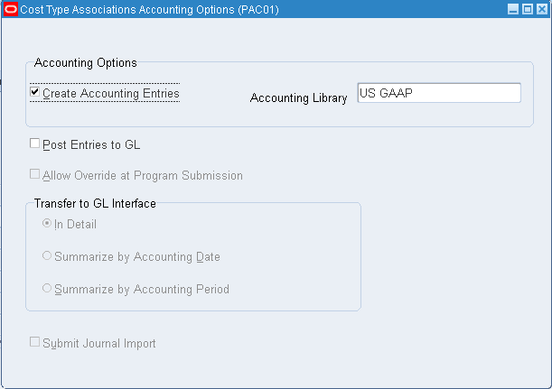

If you enable distributions for a Legal Entity/Cost Type, then associate the same ledger that you used in the perpetual cost type.
If you do not enable distributions for a Legal Entity/Cost Type, then you can use a different ledger but the chart of account and currency must be the same as those used in the perpetual cost type.

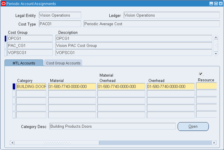

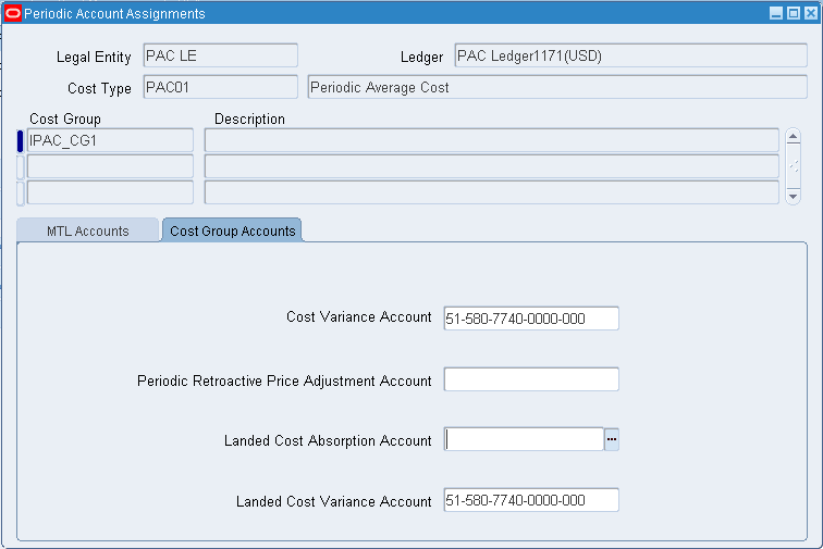

Setting accounting options (required if using Periodic Cost Distributions).
Assigning periodic accounts (required if using Periodic Cost Distributions).

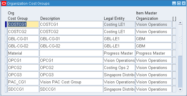

To define an organization cost group
Navigate to the Organization Cost Group window.
Enter a name for the Org Cost Group.
Enter a description for the Org Cost Group.
Select the legal entity to associate with the Org Cost Group.
Enter the Item Master Organization ID.
Save your work.

Once an inventory organization is associated with an Organization Cost Group and transactions have been processed, that association is permanent and exclusive.
An Organization Cost Group can be associated with one or more organizations.
Those inventory organizations which can be associated with an organization cost group meet the following qualifications:
The organization already belongs to the legal entity.
The organization is not associated with any other organization cost group.

Using the Cost Type Associations Accounting Options window, you can set options pertaining to the creation of accounting entries (cost distributions) and posting (transferring) to General Ledger. If you do not Create Accounting Entries, you cannot post to the General Ledger from Periodic Costing, and therefore General Ledger options are unavailable to you.
You can choose to submit the Journal Import at the same time as the transfer to General Ledger or as a separate process.
You can check Allow Override at Program Submission which allows the user to change these options:
Journal Import
Transfer mode (detail or summary) .
To set your accounting options
Navigate to the Cost Type Associations Accounting Options window.
Check Create Accounting Entries if you wish to have Periodic Cost distribution entries created.
If you do not check this option, all the other options are unavailable to you. Exit from this window.
Select an Accounting Library. The options are:
US GAAP
PAC Brazil
Note: Landed Cost Management (LCM) related accounting is only supported for US GAAP.
Check Post entries to GL if you wish to post your Periodic Cost distributions to the General Ledger.
This enables options for additional options.
Make selections on the following options:
Allow Override at Program Submission.
Transfer to GL Interface. Choose one:
In Detail
Summarize by Accounting Date
Summarize by Accounting Period
Submit Journal Import.
Save your work.

Periodic Cost Accounts are used during Periodic Cost distributions. The periodic accounting library may use these accounts to create accounting entries. Users can only specify these accounts if distribution is enabled for the legal entity cost type. There are two sets of accounts:
Cost group category level accounts: used to perform periodic inventory accounting based on categories defined in the master item organization for the cost group.
Cost group level accounts: used independently of the category to define variance and inventory offset accounts.
To assign periodic accounts
Navigate to Periodic Account Assignments.
Select your legal entity and cost type association.
Select the cost group.
Choose the MTL Account tab to assign accounts for the category.
In the category column, select item family and class.
Select accounts for the following:
Material
Material Overhead
Overhead
Resource
Outside Processing
Expense
Bridging
Non-Invoice Sales orders
Non-Invoiced Revenue
Choose the Cost Group Accounts tab to assign variance accounts.
Select an account for Cost Variance.
Select an adjustment account for Retroactive Price Adjustment Account if you are using the Retroactive Pricing functionality.
This account must be entered in your initial setup only.
Note: The application prevents retroactive price adjustment transactions when the Purchase Order is Landed Cost Management (LCM) enabled.
See: Retroactive Pricing
Enter a Landed Cost Absorption account and a Landed Cost Variance account when Landed Cost Management (LCM) is enabled for any of the inventory organizations that belong to PAC Cost Groups.
Save your work.
You can choose the Open button in the MTL Accounts tab to view the accounts in list format.

To run the Periodic Acquisition Cost Processor
Navigate to Periodic Acquisition Cost Processor concurrent window. The Parameters window displays.
Select information in the following parameters:
Legal Entity
Cost Type
Period
Process Upto Date - If you want to create a partial period run, enter the date for limiting records in the submission
Cost Group
The Run Option field is used when you want to regenerate a run that has started. Your options are:
Start - Regenerates the Periodic Acquisition Cost Processor concurrent program.
Resume - This option is only available when the processor is stopped because of errors. It enables you to resume the program from the beginning phase, to the phase where the error began.
Choose OK.
Choose Submit on the Request window to process this request.

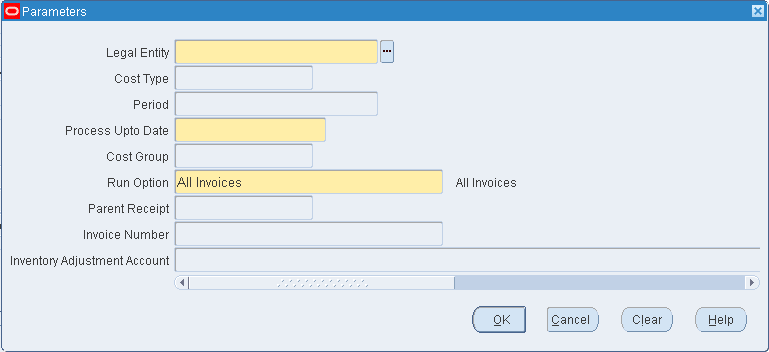

To run the Periodic Acquisition Cost Adjustment Processor
Navigate to Periodic Acquisition Cost Adjustment Processor concurrent window. The Parameters window displays.
Legal Entity
Cost Type
Period
Process Upto Date - If you want to create a partial period run, then enter the date for limiting records in the submission
Cost Group
Run Option - You can run the program for All Invoices, Particular Invoice, or Particular Receipt
Parent Receipt - This is the original receipt number before corrections were submitted
Invoice Number
Adjustment Account
Choose OK.

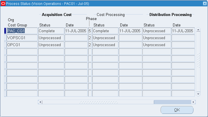

The Periodic Cost Processor calculates the Periodic Cost for all asset items in asset subinventories. The Periodic Cost processor is run manually, by submission, not automatically.
The Periodic Cost Processor can be run using either the Periodic Average or Incremental LIFO algorithm. You can define different cost types for each and associate them with one appropriate cost method.
To run the Periodic Cost Processor
Navigate to Periodic Cost Processor concurrent window. The Parameters window displays.
Legal Entity
Cost Type
Period
Cost Group
Start - Regenerates the Periodic Cost Processor concurrent program.
Choose OK.
The Periodic Cost Distributions Processor uses the accounts set up in Periodic Account Assignment to create accounting entries (distributions) which are copied to the manufacturing subledgers.
When Landed Cost Management (LCM) is enabled, accounting entries are generated based on landed costs for LCM enabled PO receipts. Unlike other PO receipt transactions, the difference between acquisition cost (calculated from Landed Cost) and PO price goes into the Landed Cost Absorption account instead of the IPV or ERV account.
Separate accounting events that include PAC Landed Cost Adjustment – Receipt, and PAC Landed Cost Adjustment – Delivery, are created from the perpetual landed cost adjustment transactions when the latest perpetual landed cost adjustment transactions are within the current PAC period for which the parent PO receipts are in the previous PAC period.
PAC Landed Cost Adjustment – Receipt, and PAC Landed Cost Adjustment – Delivery accounting events are not created when perpetual landed cost adjustment transactions are in the current PAC period for which parent PO receipts are also in the same PAC period.
When LCM is enabled, the application creates PAC Accounting Distributions for the new accounting events:
Options for the distribution processor are set in the Cost Type Associations Accounting Options window, which is chosen from the Cost Type Associations tab of the Org Cost Group/Cost Type Associations window. See: Setting Accounting Options.
Note: To use Periodic Distributions, your ledger for the cost type must be the same as for the perpetual costing method.
To run Periodic Distributions
Navigate to Periodic Cost Distributions concurrent window. The Parameters window displays.
Select the following parameters.
Legal Entity
Cost Type
Cost Group
Period
Choose OK.
In the Item Cost Inquiry window, you can list items by the following:
Cost Group
Cost Type
Period
This window includes fields for entering market values and justifying the market values to be used with the Incremental LIFO costing method. These fields still appear when the method is periodic average costing, but are ignored.
Note: You must specify values for Legal Entity, Organization Cost Group, Cost Type, and Period in the Find Window (mandatory). Additionally, you can choose options for Item Category, Item Range, or Particular Item.
Entering Market Values (Incremental LIFO)
You can view the calculated inventory item cost per period in the Item Cost Inquiry window. Also, you can run and review the Incremental LIFO Valuation report.
If the market value of an item is less than the calculated LIFO item cost, then you may manually enter that value along with a mandatory justification. The market values replaces the LIFO item cost. You may update and delete the market value and it's justification while the period is open.
The Incremental LIFO Valuation report calculates the Inventory Value using the formula:
| Inventory Value = Total Item Quantity x LIFO item cost |
If you enter a market value, the report uses this calculation:
| Inventory Value = Total Item Quantity x Market Value |
For that particular point in time, this market value is applied to accumulated items. The totals for that point in time will be carried forward and calculated using the previous formula, considering the market value as if it were an item cost.
To perform an item cost inquiry or enter a market value
Navigate to the Item Cost Inquiry window.
Query for desired cost item information, including LIFO item cost for possible entry of market value in the current period.
Enter a market value in place of the LIFO item cost if it is appropriate.
Save if you have entered a market value.

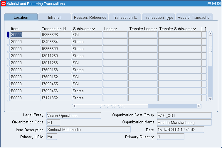

The Viewing Material and Receiving Transactions window enables you to view those transactions, per cost type, that have been:
Processed by the Periodic Cost processor and the Periodic Acquisition processor
Distributed using the Periodic Costing Transfer to General Ledger. See: Transferring to General Ledger.
Transactions that have not been processed and distributed cannot be viewed.
These same transactions are viewable in the perpetual system.
Note: This feature differs from the corresponding feature in perpetual costing, in that you view transactions by organization and cost type. Perpetual costing is limited to the default cost type for the costing method (standard or average). For a discussion of the perpetual system feature, See: Viewing Material Transaction Distributions.
A transaction from receiving to inventory appears twice since it is both a receiving and an inventory transaction.
To view Material and Receiving Transactions
Navigate to Material and Receiving Transactions. The Find Transactions window appears.
Enter search criteria in the Find Transactions window.
Choose Find to initiate the search.
The Material and Receiving Transactions window displays six tabs:
Location
Intransit
Reason, Reference
Transaction ID
Transaction Type
Receipt Transaction
Note: You can view the accounting debits and credits, and the T-accounts from the Tools menu.

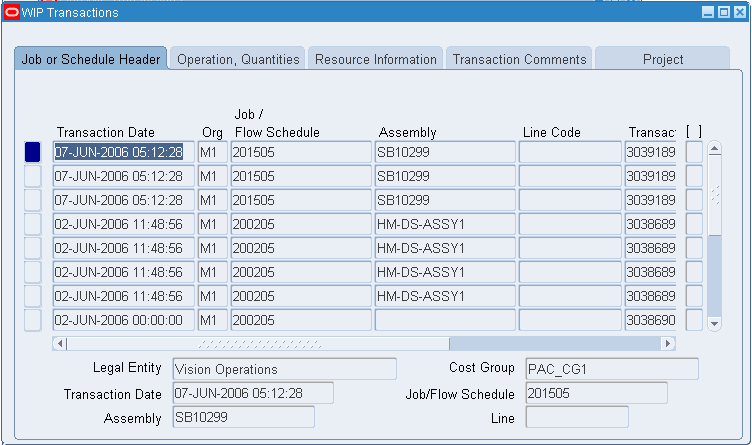

You can view WIP transactions from the Periodic Costing View WIP Transactions window.
If distributions were run, view by cost type.
For a discussion of the corresponding perpetual system feature, See: Viewing WIP Transaction Distributions.
To view WIP transactions
Navigate to WIP Transactions. The Find WIP Transactions window appears.
Select the following required criteria:
Legal Entity
Cost Group
Enter any additional optional criteria.
The WIP Transactions window displays five tabs:
Job or Schedule Header
Operation, Quantities
Resource Information
Transaction Comments
Project
Note: You can view the accounting debits and credits, and the T–accounts from the Tools menu.

Processing Status
The Process Status window shows any organization cost groups that are unprocessed by either the acquisition processor, Periodic Cost processor, or periodic distributions processor. Possible process statuses are:
Unprocessed: Unprocessed.
Complete: Fully processed.
Error: Cannot process until the error is corrected.

Choose Process Status to view the current processing status of the period.

To transfer Periodic Cost distributions to the General Ledger
Navigate to Transfer to General Ledger.
Select Transfer Periodic Cost Distributions to GL.
Select the following parameters:
Legal Entity
Cost Type
Period
Batch Name (Optional)
The system generates a batch name from the journal entry source, the Request ID, the group ID, and the Actual Flag (A (actual), B (budget), or E (encumbrance). If you wish, you can enter a name for your journal entry for easy identification. The system uses this name as the prefix to the generated name.
GL Transfer Mode
There are three choices:
In Detail
Summarized by Accounting Date
Summarized by Accounting Period
Select Yes or No to determine whether the Journal Import is submitted during posting or later.
Choose Submit.

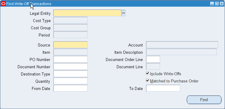

To make an accrual write-off
Navigate to Accrual Write–Off.
(N) Cost > Periodic Costing > Periodic Close Cycle > Accrual Write Off
In the Find Write–Off Transactions form, select the following required criteria:
Legal Entity
Cost Type
Cost Group
Enter additional search parameters (optional).
Enable the following, if desired:
Include Write-Offs
Matched to Purchase Order
Click the Find button to initiate the search. The Accrual Write-Offs form appears.
In the Accrual Write-Offs form, select the Write-off checkboxes for those transactions that you want to write off.
Enter any reasons and comments.
Save your work.

To update Periodic Costs
Navigate to the Update Periodic Cost window.
Enter the following parameters:
Legal Entity
Cost Type
Org Cost Group
Transaction Date
In the Transaction Change tab, enter the following:
New Periodic Cost
% Change
Inventory Value Change
Adjustment Quantity
You can enter the adjustment quantity for Periodic Cost Update - Value Change.
If the on-hand at the time of cost processing is greater than the user-entered Adjustment Quantity, then the entire value change is applied to inventory valuation.
If the on-hand is less than the user-entered Adjustment Quantity, then only the proportionate value change is applied to the on-hand quantity. Inventory valuation is performed for the on-hand quantity based on proportionate value change. The left-off value goes to the Expense account that you specify.
Adjustment Quantity can be entered only for Periodic Cost Update - Value Change transactions. Adjustment Quantity cannot be entered for Periodic Cost Update - New Cost or percentage transactions.
Select the Accounts tab and enter the following accounts:
Material
Material Overhead
Resource
Outside Processing
Overhead
Expense - enter if Adjustment Quantity is specified
Enter a change in item cost or value.
Enter an Adjustment Quantity for Landed Costs.
Click the Cost Elements button to view Update Periodic Cost Details.
Save your work.

Use this report to list details for each Accrual Write-off Account Number. The details listed include the item number, PO Number, Source, organization, accrual amount, date, transaction quantity, unit price, and write off reason.
All the transactions that have been chosen for write off will be queried and presented in the report based on your criteria.
