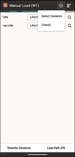

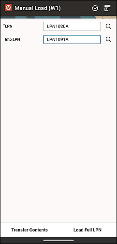

To perform manual loads
A manual load is a put away task that you create. You can use the Manual Load page to fully load the contents of one LPN into another LPN to put away the outer LPN. You can also transfer the contents of one LPN into another LPN in order to put away the second LPN. Finally, you can use the Manual Load page to select items from an LPN and put away only those items. For efficient warehouse operations, you sometimes need to put away individual contents of an LPN and then consolidate the content at various warehouse storage locations. To accomplish this, you load an entire LPN and then specify which items of the LPN to put away at the various storage locations. To perform a manual load, complete the following steps:
Navigate to the Manual Load Page.
Enter or scan the LPN to load.
Enter the Into LPN to nest the LPN.
Select <Load Full LPN> to nest the loaded LPN in the to LPN, select <Transfer Contents> to transfer the contents from one LPN to another LPN, or choose <Select Contents> to open the Item Load page and select loose content from the loaded LPN.
If you select <Transfer Contents> or <Select Contents> you must enter an into LPN. The into LPN is used to transfer the contents of the original LPN, or individual items if you select <Select Contents>.
If you selected <Load Full LPN> or <Transfer Contents> repeat the previous steps to load or transfer additional LPNs. If you selected <Select Contents>, complete the following steps.
