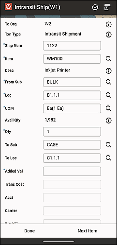

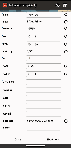

Log on to the mobile device.
Navigate to the Org Transfer window.
Continuation of above screenshot
Enter or select the from organization if necessary
Enter or select the To Organization.
Note: You can only transfer LPNs to Oracle Warehouse Management enabled organizations.
Enter or select the Transaction Type.
Optionally, in the LPN field, enter or select the LPN to transfer.
Note: If you do not enter an LPN you must enter the Item, Subinventory, and Locator information.
Enter the destination subinventory in the To Sub field.
Enter the destination locator in the To Loc field.
Select <Save/Next> to transfer another LPN, <Done>to complete the transfer, or <Cancel> to cancel the transfer.
