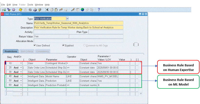

Pick Verification Using Machine Learning
You can use the rules engine and machine learning to identify picking tasks for verification. This feature is applicable only to the sales orders. You can use the rules engine to specify criteria, such as, user, customer, or item, to identify the LPNs for pick verification for sales orders.
Additionally, the machine learning algorithm calculates a discrepancy probability for each task by analyzing various data sources, such as, RMAs, cycle count discrepancies, and past verification results. The data sources may change with time. Therefore, you must create or train the machine learning model regularly to obtain the correct results.
You can define a rule which compares the discrepancy probability to a threshold value to determine the tasks to verify. For example, with machine learning and the rules engine, you can ensure that a high value item must be inspected, if the discrepancy probability exceeds a user-defined threshold.
Create Models to Reference from the Rules Engine:
Machine learning models are database schema objects that perform machine learning techniques. These can be standard models or custom models. For more information about machine learning, see Oracle Machine Learning for SQL User's Guide.
Example Screenshot for Pick Verification Rule
