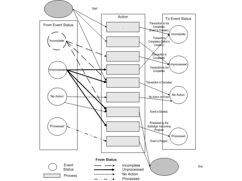

Every event has a life cycle. The event status indicates what actions have been completed on a transaction and where the event is in its life cycle. The life cycle is shown in the diagram below.
The above diagram illustrates all the status changes for an accounting event. The diagram has three blocks. The left block, From Event Status, shows the possible initial statuses of an event. These statuses are Incomplete, Unprocessed, No Action, and Processed.
The center block, Action, represents actions that users complete in subledger application, such as Oracle Projects, Oracle Assets, or Oracle Receivables. These actions result in events being created, processed, or deleted.
The right block, To Event Status, shows the possible final status based on the action in the central block. The status values include Incomplete, Unprocessed, No Action, and Processed Program.
Note that these are all the possible status changes. Not all accounting event types can support all of these status changes. For example, some accounting events, once they have a status of Unprocessed, cannot be updated to an Incomplete status. Implementers are responsible for determining the supported status changes for an event.
There may also be conditions that determine whether the accounting event can move from one status to another. These conditions can vary by accounting event.

If there is an implied order in the accounting events related to the different event types of a particular document, then implementers are responsible for enforcing that order. For example, an Invoice Validated event should have a lower event number and the same or an earlier event date than Invoice Adjusted events for the same invoice. The Financials Accounting Hub is neither aware of, nor does it enforce any implied order.
The accounting program processes accounting events according to criteria specified by users. All events whose dates are equal to or less than the end date specified when the accounting program is submitted are selected for processing.
Assume the following three accounting event types for an invoice: Invoice Validated, Invoice Adjusted, and Invoice Canceled.
It should not be possible to generate a subledger journal entry to account for an invoice adjustment before the invoice validated event is processed. Similarly, it should not be possible to adjust the invoice after it has been canceled. Therefore there is an implied order to these event types.

Some business events have the potential to invalidate the accounting created by a previous accounting event. These business events should not be supported. Each event and its accounting should be auditable and reportable at a later point in time. As an example, it should not be possible to delete an invoice after the Invoice Validated accounting event is processed in final mode.
Users can change the transaction data if its associated event is unprocessed, but no changes should be allowed after the event is processed. As a general guideline, transactions should not support business events that call for a delete or update of accounting created by other accounting events. The business events should be changed to achieve the same results by reversing accounting created by the previous accounting events.
Subledger journal entries can be created in draft or final mode. Both kinds of entries are created using the same accounting definitions, with the difference that it is possible to modify or delete transaction information associated with draft entries. Any changes to the transaction data after accounting in draft mode invalidates the draft journal entries.
In both draft and final mode, if errors are raised in processing of events for a transaction, the accounting program does not endeavor to fully account that transaction. Instead those events are flagged and the program proceeds to the next transaction.
Draft journal entries are purged once the final accounting is created. Also, if there is any change in event status, event date, or event type of an event, then draft journal entries associated with this event are deleted. Draft entries are not transferred to General Ledger.
If you have already created accounting in Final Mode but have not transferred them to GL, and then you run the Create Accounting program again with Transfer to GL option set to Yes, then the application does not pick up events already created in the Final mode. In this case, run the Transfer Journal Entries to General Ledger program.
