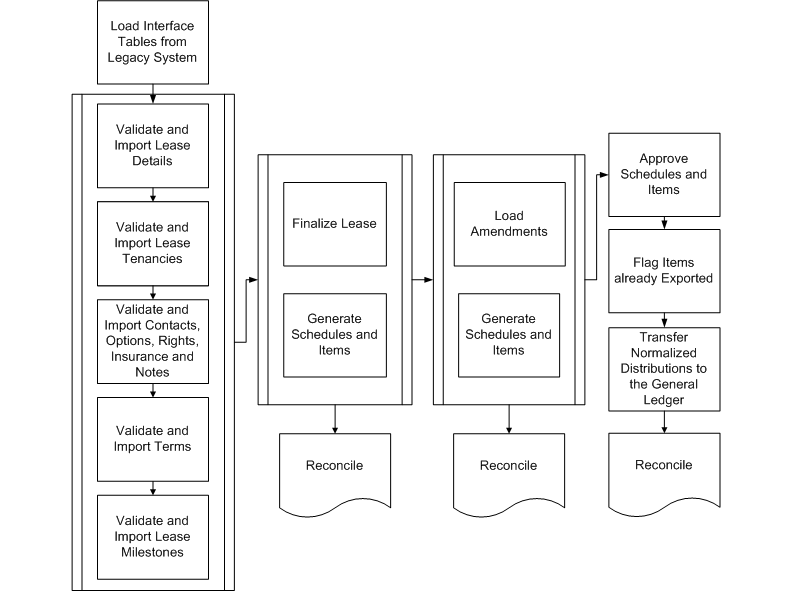

Whichever conversion method you select, it is advisable to group leases belonging to the same operating unit while converting data for leases. In addition, you must convert legacy lease data for each lease in the following sequence:
Load lease details.
Load lease tenancy information.
Load contacts, options, rights, notes, and insurance information.
Load terms.
Load milestone information.
Finalize the lease.
Load amendments.
Approve schedules.
Clean up schedules and items.
Transfer normalized distributions to Oracle General Ledger.
Reconcile the conversion activity.
The following diagram illustrates the sequence of steps you must follow while converting legacy lease data.

When you finalize a lease, the following processes take place:
Schedules and items are created. Items are created from terms and then aggregated into schedules.
The lease is placed under change control, and all subsequent changes must be made through either amendments or edits.
Therefore, before a lease is finalized, you should ensure that the abstracted or converted information is accurate. You must do this for each lease, so depending on the number of leases, terms, and computing resources, the lease finalization process may take several hours to complete.
If the Schedules and Items concurrent program fails, you can resubmit the program manually with the following parameters:
Lease Number
Context: ABS - Abstract
Called From: Main
For more information, see Schedules and Items, Oracle Property Manager User Guide.
When you edit or amend a lease, Oracle Property Manager creates a history record highlighting the data elements that you have changed. A lease edit is a correction of existing information while a lease amendment originates when you execute an ancillary document to alter the lease.
You edit a lease when you want to correct data entry errors. You amend a lease when you want to change the termination date of the lease or the lease status, relocate an assigned space, change an option or right, or insert an additional billing or payment term. You can convert legacy data for lease edits by
Including the changes as part of the original conversion. This may be the simplest and most effective approach, because Oracle Property Manager may not identify changes in the legacy system not recorded as amendments.
Loading the changes after the finalization of the lease to record the original abstraction, and then any changes to the lease.
Converting lease amendments is a more complex task because you must:
Load lease amendments sequentially based on the effective date.
Commit the amendments to the database.
Submit the Schedules and Items concurrent program. See Schedules and Items, Oracle Property Manager User Guide.
You must also ensure that the conversion routine references a previously loaded lease event, when the amendment or edit relates to a change of a record, instead of the insertion of a new record.
The following history tables are updated as part of the conversion of lease edits and amendments:
PN_LEASE_CHANGES_ALL
PN_LEASE_DETAILS_HISTORY
PN_CONTACT_ASSIGN_HISTORY
PN_TENANCIES_HISTORY
PN_INSURE_REQUIRE_HISTORY
PN_LANDLORD_SERVICE_HISTORY
PN_OPTIONS_HISTORY

Once you load terms, you must approve the schedules before you can export the information. You can approve schedules using the Approve or Cancel Approval of Schedules concurrent program. For more information, see Approve or Cancel Approval of Schedules, Oracle Property Manager User Guide.
You should approve schedules up to the date of the cutoff from the legacy system to Oracle Property Manager.
If you convert all historical terms, you may face reconciliation problems with the Account Receivable or Accounts Payable subledgers. It is likely that the approved term is already reflected in the appropriate subledger. So, exporting terms will result in invoice duplication. Additionally, if terms are normalized, the accrual and relief of the accrual has probably occurred and does not require replication.
If all terms in the legacy system (before the cutoff date) have been transferred to the appropriate subledger, you need not reconcile the receivable and revenue accounts (for a revenue lease or sublease) or the liability and expense accounts (for an expense lease.) This is because the new items transferred after the cutoff date are independent of those previously transferred.
An exception is when billing terms are transferred and the non-normalized terms have revenue rules where
The initial revenue period is before the cutoff date.
Revenue recognition is on going.
In this case, you may need to create two separate lease terms: one for the period before the cutoff date and one subsequent to the cutoff date.
If normalized terms exist on the lease, you must reconcile the accrued asset or liability with the balance or normalized terms remaining on the lease in Oracle Property Manager. In addition, the reconciliation of the conversion process requires that both schedules and items, and prior normalized terms be cleansed.
You must designate as exported items that have been exported to a subledger. Items can be marked as exported in two ways. You can
Use a SQL*Plus script to update the PN_PAYMENT_ITEMS_ALL table
Transfer terms to the appropriate subledger and then delete the invoices in the interface.
Regardless of the approach, you must ensure that all legacy terms related to the lease have been transferred from the legacy system before the cutoff date. Failure to ensure the transfer of all legacy terms may result in missing invoices.
After you cleanse Schedules and Items data, you must perform a similar process for the normalized items that are transferred to the General Ledger.
You can accomplish this through the Transfer Normalized Lines to GL and Create Accounting concurrent programs.
The Transfer Normalized Lines to GL concurrent program transfers normalized lines to Oracle Subledger Accounting. When you submit this request, ensure that the schedule start and end dates cover all schedules up to the cutoff date.
When the Transfer Normalized Lines to GL concurrent program terminates successfully, run the Create Accounting program (provided by Oracle Subledger Accounting) to transfer data to Oracle General Ledger. Depending on how you plan to reconcile the accrued liability or asset accounts, you may choose to either import the journal lines or delete them from the interface table.

For more information on common application setup steps and setup steps in other Oracle products, see Prerequisites and Optional Integration.
The following is a list of setup steps that you must complete in Oracle Property Manager before you can convert lease information
Descriptive flexfields and value sets: See Descriptive Flexfieds and Value Sets.
Contacts: See Contacts.
Grouping rules: See Invoice Grouping Rules.
Term templates: See Payment and Billing Term Templates.
Milestone templates: For more information, see Milestone Templates.
Locations: See Setting Up Property, Oracle Property Manager User Guide.
Oracle Property Manager System Options: The following system options have an impact on how you convert lease data.
Accounting Option
Allow Tenancy Overlap Within Lease
Currency Conversion Type
Automatic Space Distribution
Automatic Lease Number
Multiple Tenancy Lease
Location Code Separator
Default Location Area for Leases
Invoice Grouping Name
Legacy Cutoff Date
For more information, see System Options in Oracle Property Manager.
Oracle Property Manager Lookups: You must define the following lease-related lookups before converting lease data.
Lease Type (PN_LEASE_TYPE)
Lease Status (PN_LEASESTATUS_TYPE)
Payment Purpose Type (PN_PAYMENT_PURPOSE_TYPE)
Payment Term Type (PN_PAYMENT_TERM_TYPE)
Role (PN_LEASE_ROLE_TYPE)
Job Title (PN_JOB_TITLE)
Landlord Services (PN_LANDLORD_SERVICE_TYPE)·
Insurance Type (PN_INSURANCE_TYPE)
Lease Option Types (PN_LEASE_OPTION_TYPE)
Lease Option Status (PN_OPTION_STATUS_TYPE)
Milestone Sets (PN_MILESTONES_SET)
Milestone Type (PN_MILESTONES_TYPE)
Note Type (PN_NOTE_TYPE)
Financial Responsible Party (PN_OBLIGATION_FIN_RESP_PARTY)
Obligation Responsibility (PN_OBLIGATION_RESP_TYPE)
Recovery Space Standard Type (PN_RECOVERY_SPACE_STD_TYPE)
Recovery Type (PN_RECOVERY_TYPE)
Rights Type (PN_RIGHTS_TYPE)
Rights Status (PN_RIGHT_STATUS_TYPE)
Tenancy Usage Type (PN_TENANCY_USAGE_TYPE)
For more information, see Lookups.
Oracle Property Manager uses the following tables while loading lease components.
Leases and Lease Details: Oracle Property Manager inserts records into the following tables when you abstract or amend a lease:
PN_LEASES_ALL
PN_LEASE_DETAILS_ALL
PN_LEASE_TRANSACTIONS_ALL
Contacts: Oracle Property Manager inserts records into the following tables when you abstract or amend a lease:
PN_CONTACT_ASSIGNMENTS_ALL
Tenancies (Locations): Oracle Property Manager inserts records into the following tables when you abstract or amend a lease.
PN_LEASE_TENANCIES_ALL
PN_LEASE_TENANCIES_HISTORY
Insurance Details: Oracle Property Manager inserts records into the following tables when you abstract or amend a lease.
PN_INSURANCE_REQUIREMENTS_ALL
PN_INSURE_REQURE_HISTORY
Lease Obligations: Oracle Property Manager inserts rows into the following tables when you abstract or amend a lease:
PN_LANDLORD_SERVICES_ALL
Lease Rights: Oracle Property Manager inserts records into the following tables when you abstract or amend a lease:
PN_RIGHTS_ALL
PN_RIGHTS_HISTORY
Lease Options: Oracle Property Manager inserts records into the following tables when you abstract or amend a lease:
PN_OPTIONS_ALL
PN_OPTIONS_HISTORY
Terms (Payments and Billings): Oracle Property Manager inserts records into the following tables when you abstract or amend a lease:
PN_PAYMENT_TERMS_ALL
PN_DISTRIBUTIONS_ALL
Oracle Property Manager inserts records into the following tables when you run the Schedules and Items concurrent program:
PN_ PAYMENT_SCHEDULES_ALL
Notes: Oracle Property Manager inserts records into the following tables when you abstract or amend a lease:
PN_NOTE_HEADERS
PN_ NOTE_DETAILS
Milestones: Oracle Property Manager inserts records into the following table when you abstract or amend a lease:
PN_LEASE_MILESTONES_ALL
The Amend API for Equipment Leases in package PN_EQUIP_LEASE_PUB is as follows:
Amend_Equip_Lease (p_Commit IN VARCHAR2 := Fnd_Api.g_False ,p_Validate IN VARCHAR2 :=Fnd_Api.g_False ,p_Equip_Lease_rec IN OUT NOCOPY Pn_Equip_Lease_Pvt.eq_lease_rec_type ,p_Equip_dtls_Lease_rec IN OUT NOCOPY Pn_Equip_Lease_Pvt.EQ_LEASE_DTLS_REC_TYPE ,p_Equip_Notes_Dtls_rec IN OUT NOCOPY Pn_Equip_Lease_Pvt.EQ_NOTE_DETAILS_REC_TYPE ,p_Equip_Party_tbl IN OUT NOCOPY Pn_Equip_Lease_Pvt.EQ_LS_PTY_TBL_TYPE ,p_Equip_Assets_tbl IN OUT NOCOPY Pn_Equip_Lease_Pvt.eq_asts_tbl_type ,p_Equip_Srn_tbl IN OUT NOCOPY Pn_Equip_Lease_Pvt.EQ_SRNUM_TBL_TYPE ,p_Equip_Option_tbl IN OUT NOCOPY Pn_Equip_Lease_Pvt.eq_ls_options_tbl_type ,p_eqp_lease_term_tbl IN OUT NOCOPY pn_eqp_payments_pvt.Eqp_Lease_Terms_Tbl ,p_extend_term IN VARCHAR2 DEFAULT 'N' ,p_renormalize IN VARCHAR2 DEFAULT 'N' ,p_cutoff_date IN DATE ,p_request_id IN OUT NOCOPY VARCHAR2 ,x_Msg_Count OUT NOCOPY NUMBER ,x_Msg_Data OUT NOCOPY VARCHAR2 ,x_Return_Status OUT NOCOPY VARCHAR2 ,p_Equip_Lease_Context IN VARCHAR2 DEFAULT 'AMENDAPI');
