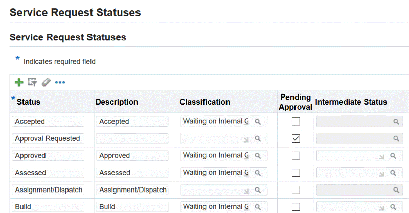

An intermediate status is the status of the service request while it is waiting for the approval process to complete, an example is, "Waiting for Approval".
To create an intermediate status, you must select the Pending Approval check box while setting up the status in the Service Request Statuses page.

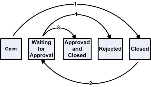

Approval Before Closure With Approval Action Status
Suppose you create the statuses listed in the following table for the approval process:
| Status | Description |
| Open | Initial |
| Closed | Triggering and Final |
| Waiting for Approval | Intermediate |
| Approved and Closed | Approval Action and Final |
| Rejected | Rejection Action |
The application behaves as follows (numbers in brackets refer to the diagram below):
An agent wants to close the service request and so sets the service request status to Closed (1).
If an approval process is not triggered by the rules you set up, the service request remains Closed.
If approval is required, then the application sets the status to Waiting for Approval. (2)
If the service request is approved, then the application resets the service request status to Approved and Closed(3)
If it is rejected, then the status becomes Rejected.(4)
Note that the service request can end up in one of two final statuses: the triggering status "Closed" if no approval is required, or "Approved and Closed" if approval is required and obtained.

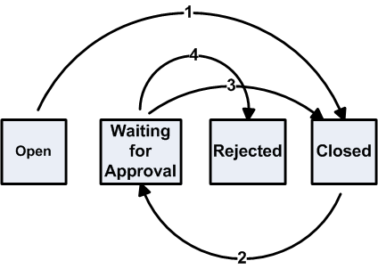

Approval Before Closure Without an Approval Action Status
To set service requests to the same "Closed" status regardless of any approval process, you can set up your statuses without the rejection action status:
| Open | Initial |
Then the application behaves as follows:
The agent sets the service request status to Closed (1).
If your rules determine that service request does not requires any approval, the status remains Closed.
If approval is required, then the application sets the service request to Waiting for Approval (2).
If the service request is approved, the application resets the service request status back to Closed (3)
If it is rejected, the status gets set to Rejected.(4)
If you do not enter a rejection status, then the application reverts the service request to its previous status. If the agent had changed the service request from "Open" to the triggering status "Closed", a rejection resets the status to "Open". If you do not use a rejection status, then agents cannot tell that the service request was rejected without looking at the history log.

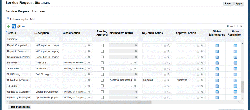

Create the intermediate status. The procedure is similar to the procedure described in Setting Up Service Request Statuses. There is one additional step: for intermediate statuses you must select the Pending Approval check box. When you do, the application automatically selects the following check boxes:
Disallow Request Update
Prevents the service request from being updated while the service request is in the intermediate status.
On Hold
Placing a service request on hold prevents the application from distributing the service request to agents when they click the Get Next Work button while the service request is awaiting approval.
You can override the settings of both of these check boxes.
Note: Please note the following:
You cannot reuse the same intermediate status for multiple triggering statuses.
Agents cannot set service requests to the intermediate statuses themselves. The application does this automatically.
An intermediate status cannot be an initial status in the status group.

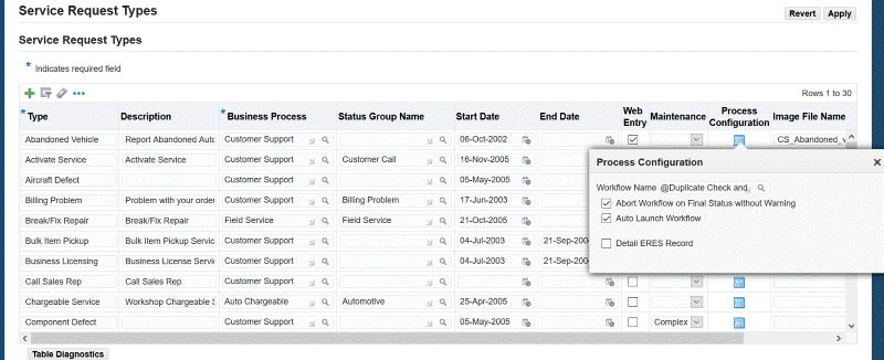

To have the application generate the detailed e-record report for your service request type rather than the default summary report, navigate to Setup, Definitions, HTML Setup, Service Request Types, and select the Detail ERES Record check box in the Process Configuration column.
If this check box is not selected, the default summary report is generated.
For more information about setting up service request types, see Setting Up Service Request Types.

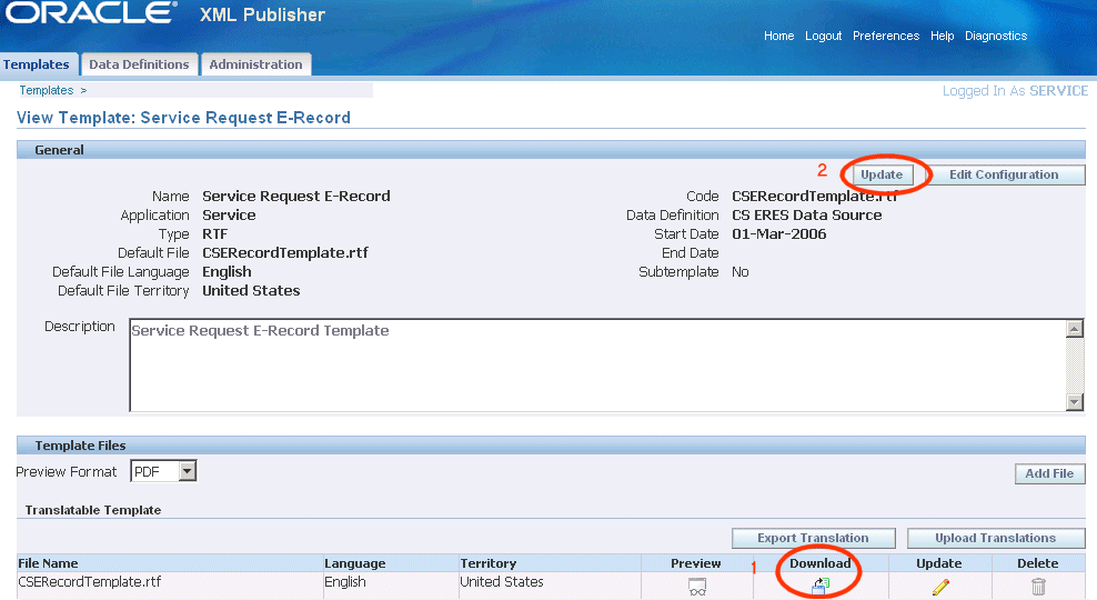

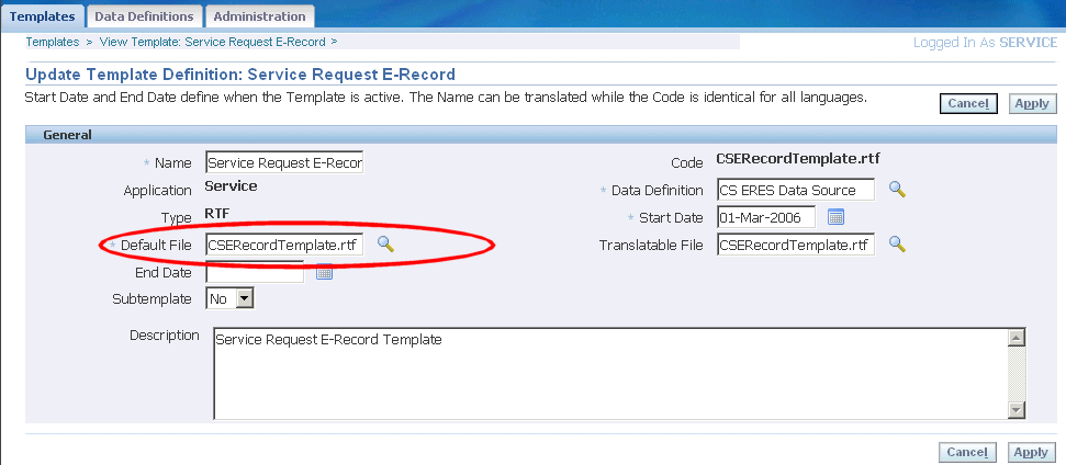

Optionally, modify the seeded electronic record (e-record) template and register the new version according to the procedures outlined in Downloading and Registering the E-Record Template.
You can add or remove information or modify the template's appearance. Oracle does not recommend extensive modifications. See About the E-Record Template for guidelines and a list of service request attributes used by the template.
Specify the variable EREC_STYLE_SHEET to the new template name you want to use for creating e-records.

Set up the statuses.
The triggering status is the final status: "Closed".
Because you want to escalate service requests when they are rejected, you need a rejection action status.
You do not need to set up an approval action status as you want the application to set the service request in the Closed status if approval is obtained or no approval is required.
The statuses you need are the same as those described in Approval Before Closure Without an Approval Action Status. Additional details about entries you must make in the status setup window are shown in the table below:
| Status | Initial Check Box | Final Check Box | On Hold Check Box | Intermediate Status Field | Rejection Action Field | Approval Action Field | Pending Approval Check box | Disallow Request Update Check Box |
| Open | Selected | Null | Null | Null | Null | Null | Null | Null |
| Closed | Null | Selected | Selected | Waiting for Approval | Rejected | Approved | Null | Null |
| Waiting for Approval | Null | Null | Selected | Null | Null | Null | Selected | Selected |
| Rejected | Null | Null | Selected | Null | Null | Null | Null | Selected |
Please note that:
Open is the initial status
Closed is the triggering status.
Waiting for Approval is the intermediate status.
Selecting the On Hold check box prevents the application from reassigning the service request

You must set up status transition rules to prevent agents from setting the service request to the approval action and rejection action statuses.
Because you have only one status group for all users in this example, you can associate the status group with the service request type on the Service Request Type setup window as shown in the table below:

Use this procedure to set up service request statuses that trigger the Oracle E-Record processes you have set up.
Prerequisites:
You must set up the intermediate, rejection action, and approval action statuses.
To set up a triggering service request status
Navigate to the Service responsibility, Setup, Definitions, HTML Setup, and then Service Request Statuses.
The Service Request Statuses page appears.
Enter a name in the Status field. This is what the agent sees when the application sets the service request to this status.
Enter an intermediate status using the Intermediate status list of values. If the Oracle E-Record process you have set up requires approvals (e-signatures), then the service request will be set to this status until all the approvals are obtained. If approvals are not required, then the service request remains in the triggering status.
If approvals are required, then select the Approval Action status and the Rejection Action status.
To assign a color to the text the support agent sees in the Status field of the Service Request page use the Text Color field.

Under the XML Publisher Administrator responsibility navigate to Home, Templates.
The XML Publisher Templates page appears.
To display the seeded template, search for "Service" in the Application field and "RTF" as the Type.
Click the "Service Request E-Record" link in the Name field.
Note: Your application includes two other templates, which are used for service request reports.
The View Template: Service Request E-Record page appears.
To download the template for modification, click Download.
If you modify the seeded template, you must upload it under a different name and then make it the default.
Click Update and enter the file name (Code) in the Default File field in the Update Template Definition page.
