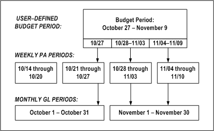

If a budget period does not match the summarization period or the budget is not time-phased, the summarization process must apportion the budget amounts into the summarization periods.
If a budget is not time-phased, Oracle Projects determines the budget start and end dates based on the project or task start and end dates, as illustrated in the following table:
| Budget Entry Level | How the Budget Period is Determined |
| Project | Project Start and End Dates |
| Task (where start and end dates have been entered for the task) | Task Start and End Dates |

If summarization is by GL period, the summarization process uses the following logic:
Divide the amounts into PA periods, prorating the amounts by day if a budget period spans PA periods.
Summarize the amounts in the GL period that includes the ending date of the PA period determined in step 1.
The following illustration shows an example of reconciling summarization by GL Periods.
In the above illustration , the user-defined budget period is October 27 through November 9. The first budget period is October 27, the second budget period is October 28 through November 3, and the third budget period is November 4 through November 9. Summarization of budgeted amounts is by GL period. The summarization process is as follows:
Divide the budgeted amounts into weekly PA periods.
Divide the October 27 budget into the PA period October 21 through October 27.
Divide the budget for the budget period October 28 through November 3 into the PA period October 28 through November 3.
Divide the budget for the budget period November 4 through November 9 into the PA period November 4 through November 10.
Summarize the amounts in the monthly GL period that includes the ending date of the PA period determined in step 1.
Summarize the amount divided into the PA period October 21 through October 27 in the GL period October 1 through October 31.
Summarize the amounts divided into the PA periods October 28 through November 3, and November 4 through November 10, in the GL period November 1 through November 30.
