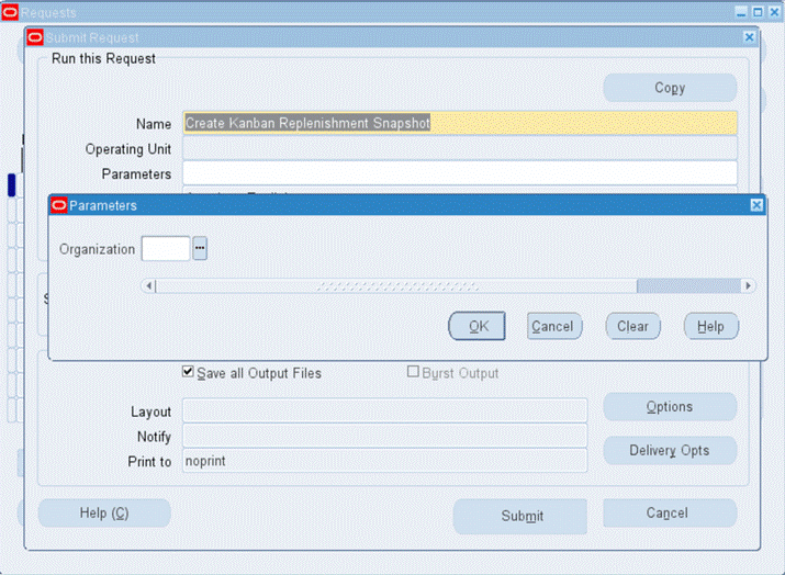

To create Kanban replenishment snapshot:
On the Find Requests window, click Submit a New Request.
In the Submit Request window, select Create Kanban Replenishment Snapshot from the list of values in the Name field.
In the Parameters window, select the organization for which you want to generate Kanban replenishment snapshot. If you leave the Organization parameter blank, then the program creates snapshots for all the organizations.
Click OK on the Parameters window.
Click Submit on the Submit Request window to submit the concurrent request.
Review your request using the Requests page.
