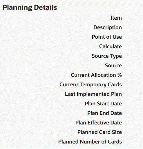

Select a pull sequence record in the search results table to display the Planning Details and Horizontal Plan for the selected pull sequence.
In the Planning Details region, you can see values in the following fields:
Item
Description
Point of Use
Calculate: Indicates the method to calculate either size or number of cards.
Current Temporary Cards
Last Implemented Plan
Plan Start Date
Plan End Date
Plan Effective Date
Planned Card Size
Planned Number of Cards
Source
Source Type
Current Allocation %
Planning details window

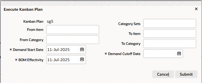

Click Execute to open the Execute Kanban Plan dialog window.
Enter parameters in the following fields:
From Item
To Item
Category Sets
From Category
To Category
BOM Effectivity
Demand Start Date
Demand Cutoff Date
Click Cancel to close the execution or Submit to execute the plan .
Click View to navigate the Planning Workbench subtab to view the planning details of the plan. You can also export Plan definitions to Excel or PDF.
