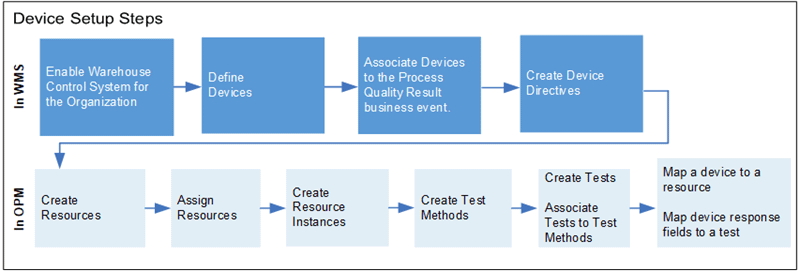

You can set up devices to provide an alternate way of adding quality results for samples in process manufacturing laboratory organizations. You can set up the devices, perform quality tests, and then read the devices to automatically enter results in the Results window.
To use the device reading functionality, you must perform one-time setup steps in Oracle Warehouse Manufacturing and Oracle Process Manufacturing. The following diagram and steps describe the setup process:
Prerequisite Device Setup Steps in Warehouse Management (WMS)
Enable Warehouse Control System for your organization. See: Defining Default Inventory Parameters, Oracle Inventory User's Guide
Define devices. To configure the laboratory equipment, use the MES for Process Manufacturing Administrator responsibility to navigate to the Define Devices window. Ensure the following:
In the Device Type field, select Laboratory Equipment. See: Defining Devices, Oracle Warehouse Management User's Guide
In the Message Template field, select the template you have created. This template assigns the directives to the device.
See: Defining Device Response Messages, Oracle Warehouse Management User's Guide
Note: Create each message template to be compatible with the device's communication format. Match the message component and message component UOM of the template to that of the test and test unit.
Associate devices with the Process Quality Result business event in the Assign Devices to the Business Events window. See: Material Handling Devices and Business Events, Oracle Warehouse Management User's Guide
Create device directives on the Warehouse Control System dashboard.
See the following topics:
Warehouse Control System, Oracle Warehouse Management User's Guide
Searching for Tasks Within the Directive Queue, Oracle Warehouse Management User's Guide
Carousel Configuration, Oracle Warehouse Management User's Guide
Material Handling Device Integration, Oracle Warehouse Management Implementation Guide.
Prerequisite Device Setup Steps in Oracle Process Manufacturing (OPM)
Create a generic resource. Use the Process Engineer responsibility to navigate to the Generic Resources window. When you create a generic resource for device integration, select Laboratory in the Type field.
See: Defining Generic Resources, Oracle Process Manufacturing Process Planning User's Guide
Assign the resource. Navigate to the Resource Information window and assign the generic resource to a laboratory organization.
See: Defining Plant Resource Parameters, Oracle Process Manufacturing Process Planning User's Guide
Create a resource instance. In the Resource Information window, click the Instances button. Create an instance in the Resource Instances window.
See: Defining Plant Resource Parameters, Oracle Process Manufacturing Process Planning User's Guide.
Create a test method. In the Test Methods window, select a test method and then click the Resource button. In the Resources window, add one or more resource, resource instance, and laboratory organization combination to the test method.
Create tests and associate tests with test methods.
See: Entering Tests
Map a device to a resource and map device response fields to a test. See: Using the Resource Device Mapping Window.
Using the Quality Manager responsibility, navigate to the Resource Device Mapping window.
In the Test Method field, select a test method from the list of values.
Click Find.
The tests associated with the test methods appear in the Tests region, which displays the test, the test description, and the test unit.
Select a test for which you want to define a device.
Use the Devices region to define a device for each test. Select a test and then enter values in the following fields:
Laboratory - Select a laboratory that is associated with the test method.
Resources - Select a resource that is associated with the laboratory.
Resource Instance
Response Value - Enter processing parameter attributes such as height, weight, and so on.
Response UOM - Enter the unit of measure for the response value.
Click Save.

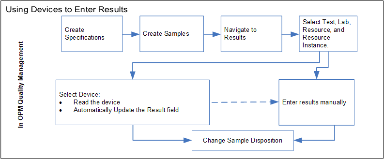

Using a Device to Enter Results
The following diagram and steps describe how you can read quality results from a device and automatically enter results for a test:
Create specifications. See: Entering a Specification
Create samples. See: Entering Item Samples
Navigate to the Results window to read devices. See: Entering Results
On the Devices tab in the Results window, perform the following steps:
Select a test.
Select and enter the laboratory, resource, and resource instance combination.
Select the device.
Click Read Selected Test Results in the Results window. The Result field displays the device read result.
Change the sample disposition. See: Changing Quality Disposition
