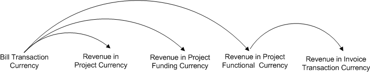

Oracle Project Billing always generates revenue in project, project functional, and project funding currencies. Oracle Project Billing generates invoice amounts in invoice transaction currency. The invoice transaction currency is an attribute that you define for each customer. On a multi-currency project the invoice transaction currency can be a foreign currency. To include exchange rate gains or losses in foreign currency for unbilled receivables and unearned revenue amounts when revaluating accounts in Oracle General Ledger, Oracle Projects enables you to derive revenue including unbilled receivables and unearned revenue in invoice transaction currency.
Note: To derive revenue in the invoice transaction currency, disable the Invoice by Bill Transaction Currency option when defining the currency options for your project.
You can define Revenue Transaction Currency options for your project. By default, Oracle Project Billing selects the Project Functional Currency Only option for revenue transaction currency. This ensures that the Generate Draft Revenue concurrent program generates revenue in project functional currency. To enable the Generate Draft Revenue concurrent program to additionally derive revenue in invoice transaction currency, select the Project Functional Currency and Invoice Transaction Currency option.
When you select Project Functional Currency and Invoice Transaction Currency as your revenue transaction currency, the Generate Revenue Accounting Events process calculates unbilled receivables and unearned revenue amounts in invoice transaction currency. For information on the calculation formula, see: Generate Revenue Accounting Events, Oracle Projects Fundamentals.
Note: For realized gains or losses events, because these amounts are always only calculated in project functional currency, the revenue transaction amounts for these is always zero. However, while converting invoice amounts from other currencies, the application considers the difference in dates used to find the conversion rate to calculate realized gains and losses on an invoice.
The following diagram illustrates the flow that the Generate Draft Revenue concurrent program uses to derive revenue in foreign currency. By default, the Generate Draft Revenue concurrent program uses the billing amounts entered in billing transaction currency to generate revenue amounts in project, project functional, and project funding currencies. If you select Project Functional Currency and Invoice Transaction Currency as your revenue transaction currency, the Generate Draft Revenue concurrent program converts the revenue it generates in project functional currency to revenue in invoice transaction currency.
Process Flow for Converting Revenue To Invoice Transaction (Foreign) Currency
