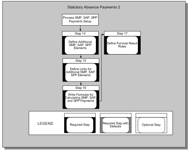

Statutory Absence Payments Setup (UK Only) 1
the picture is described in the document text
Statutory Absence Payments Setup (UK Only) 2

Process SMP, SAP, SPP Payments Setup
Refer to Setup to Process Payments for SMP, SAP, and SPP, Oracle HRMS Compensation and Benefits Management Guide for an overview of processing these statutory payments.
Step 75: Define Additional SMP, SAP, or SPP Elements
You can define additional SMP elements to hold the formula results from processing the Statutory Maternity Pay element. Similarly, you can define additional elements for SAP, SPP Birth, and SPP Adoption.
For example, if you need to maintain the predefined SMP Total balance, which can be reported on at year end, you should define an SMP Total element. This non-payment element will be fed an indirect result from the SMP element and pass that value to the SMP Total balance.
Similarly, you can define an SAP Total element, and SPP Birth Total Element, and an SPP Adoption Total element to feed the relevant predefined Total balances.
If you also want to pay SMP, you must define an SMP Paid element with a Pay Value. You can feed this element as an indirect result from the Statutory Maternity Pay element, or you can process this separately in a payroll run, depending on your own business needs.
Note: If you are offsetting SMP payments from salary payments, you will not want to use the SMP Amount from the Statutory Maternity Pay element as the Pay Value for the SMP Paid element. Use the Statutory Maternity Pay formula to calculate the relative portion of SMP paid, depending on your business rules.
Similarly, you can define an SAP Paid element, and SPP Birth Paid Element, and an SPP Adoption Paid element to calculate the amount to appear on the payslip for each statutory payment.
Use the Element window.
See: Defining an Element, Oracle HRMS Compensation and Benefits Management Guide.
Step 76: Define Links for Additional SMP, SAP, and SPP Elements
Define links for SMP Total and SMP Paid elements--and the equivalent elements for SAP, SPP Birth, and SPP Adoption--if you have defined them.
Use the Element Link window.
See: Defining Element Links, Oracle HRMS Compensation and Benefits Management Guide.
Step 77: Write Formulas for Calculating SMP, SAP, and SPP Payments
Write the formula that is associated with the Statutory Maternity Pay element to perform the payroll calculations for SMP payments. You should be conversant with your own business rules for the payment/offsetting of SMP payments.
Similarly, write the formulas for the predefined SAP element, SPP Birth element, and SPP Adoption element to calculate the amount to appear on the payslip for each statutory payment.
Use the Formula window.
See: Writing Payroll Formulas for Elements, Oracle HRMS FastFormula User Guide
Step 78: Define Formula Result Rules
Associate the formula with the Statutory Maternity Pay element to specify what happens to the formula results for this element.
Similarly, create the formula processing rule and result rules for the Statutory Adoption Pay element, the Statutory Paternity Pay Birth element, and the Statutory Paternity Pay Adoption element.
Use the Formula Result Rules window.
See: Defining Formula Processing and Result Rules, Oracle HRMS Compensation and Benefits Management Guide.
