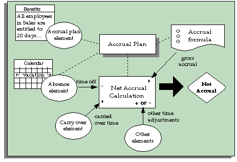

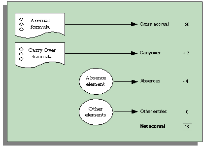

Accrual Plan Structure, including elements, formulas, and the net accrual calculation rules

Each accrual plan is associated with one absence element (and hence one absence type). Each entry of time off reduces the net accrual on the plan. You can also associate any number of other elements with a plan and determine how entries to these element affect the accrual calculation. This is useful for recording time bought or sold, or unused PTO brought into a new plan on enrollment.
A few types of accrual plan are seeded with the system. However, accrual plan rules vary from enterprise to enterprise, and country to country. Oracle HRMS provides you with the flexibility to define your own plan rules. Here is just a selection of the rules you can set up:
The length of the accrual term (often one year), and the start date, which may be fixed (such as 1 January) or vary by employee (such as the anniversary of the employee's hire date). Some plans have no start date, but always calculate accruals for the previous 12 months (or other length of time).
The frequency of accrual, such as monthly, or once each pay period. In other plans, employees receive their full entitlement up front, at the beginning of the accrual term.
The amount of accrual and any ceiling on the amount that can be held. These figures may be fixed or vary by length of service, grade, time worked, or other factors.
What happens to unused PTO at the end of the accrual term.
Rules for part time employees, and for employees with suspended assignments
Rules for new hires, including when they can begin accruing PTO and when they can begin to use it.

In Oracle HRMS, accrual plans are based on elements, formulas, and a net accrual calculation. All of these are available for you to configure so you have complete control over the rules underlying your plans.
Oracle HRMS does not store net accrual totals. It calculates gross accruals dynamically by calling the Accrual formula. The net accrual calculation specifies the element entries that should add to or subtract from this figure to create the net entitlement.
If you use Oracle Payroll, you can set up your accrual plan so that gross accruals are stored in a payroll balance. Each payroll run retrieves the latest balance and calls the accrual formula to calculate new accruals since the end of the last payroll period. This approach - using a payroll balance - is optional but provides performance enhancements if you need to calculate accruals in a batch process. See: Accrual Balances Maintained By the Payroll Run.
The table below further explains the role of the elements, formulas, and net accrual calculation.
For each accrual plan, you define and link an absence element and then define a plan using this absence element. The system generates elements for the plan.
The system generates the following elements when you save a new accrual plan:
An element representing the plan and which has the same name as the plan. You use this element to enroll participants in the plan.
An element to hold participants' unused PTO that is available for carry over to the next year.
An element to hold residual PTO, that is, unused PTO not available for carry over under plan rules.
If you use Oracle Payroll and have elected to store gross accruals in a payroll balance, the system also generates:
An element to feed a payroll balance. This element receives an entry from the accrual formula during a payroll run.
A tagging element, which the payroll run uses to keep track of retrospective absences (and other element entries included in the net accrual calculation) that need to be included in the gross accrual calculation.
The Carried Over and Residual elements have input values that automatically receive entries when you run the PTO Carry Over process:

Most accrual plan rules are incorporated in two formulas:
An Accrual formula, which calculates the amount of PTO accrued at any given time, and
A Carry Over formula, which returns the maximum amount of accrued time that a plan participant can carry over to the next plan period, the date on which this carry over is effective (normally the first day of the new accrual term), and any expiry date by which the carried over PTO must be used, or forfeited.
The Carry Over formula is called by the Carry Over process. When the Accrual formula is run, it always receives a calculation date as input, as shown in the following table.

Oracle HRMS uses the following calculation for an employee's net accrual:
Net PTO accrual = (Accrued PTO + PTO carried over) - PTO taken to date
Accrued PTO is the sum of regular accruals to date in this accrual term, calculated by your Accrual formula.
PTO Carried Over is the hours or days carried over from the previous accrual term, obtained from the plan's Carried Over element.
PTO Taken To Date is all PTO taken in this accrual term, obtained from the entries to the plan's absence element.
You may require a more complex calculation of net accruals, perhaps to take some account of time stored in the residual PTO element, or to take account of time entered on other elements that you have created. You cannot change the predefined rules for PTO taken to date (the absence element) and PTO carried over, but you can add your own rules in the Net Calculation Rules window.
Notice that the system does no automatic processing of the entries of employees' residual PTO. Your enterprise may want to use these entries to inform employees of accrued but unused time they may forfeit, or to make payments for part or all of this time.

The rules for automatic calculation of employees' net PTO appear in the Net Calculation Rules window. You enter this window by choosing the Net Calculation Rules button in the Accrual Plan window.
The default net accrual calculation takes account of absences (entered on the Absence element) and time carried over from the previous accrual term (entered by the Carry Over process on the plan's Carried Over element). You cannot change these rules. However, if your plan's calculation needs to take account of other values (such as time bought or sold), you can add new rules in this window.
To change the net accrual calculation
Create and link any additional elements you need for the plan. For example, you might need an element to store the amount of PTO an employee has bought or sold. Use the Information classification for these elements, define them as nonrecurring, and give them at least two input values:
An input value with the same units (days or hours) as you selected for the accrual plan, and
An input value with the units Date (to hold the effective date).
Tip: Use names for these elements that clearly link them to the appropriate accrual plan. For example, if the accrual plan is called Standard Vacation, you could name the element Standard Vacation Bought or Sold.

To view information on employees' accrued PTO, use the Accruals window.
To view an employee's net PTO accrual
Set your effective date to the day for which you want to calculate PTO entitlement.
In the Assignments Folder, query the employee's name. Choose the Accruals button to go to the Accruals window.
Query the accrual plan in the Name window.
The Dates region shows the dates that the accrual formula uses for the entitlement calculation. These are typically from the start of the accrual term to your effective date. The Net Entitlement field displays the net accrued days or hours between these dates. The Last Accrual date is the end of the last complete accrual period, if the formula does not calculate accrual for partial periods.
If you allow maintenance of negative balances of accrued time at your installation and an employee's time absent exceeds time accrued, the net entitlement appears as a negative number.
Note: Net Entitlement can exceed the accrual ceiling if you have increased entitlement using an adjustment element or the Carry Over element. If you have adjusted net accrual so that it exceeds the ceiling, the employee will accrue no time until net accrual falls below the ceiling.
The Entitlement Details region shows the values used in the calculation of the net entitlement:
The <plan name> element stores current accrued time.
The <plan name> Carried Over element stores accrued time carried over from the previous accrual term. If the plan has an expiry date for carried over time, the value shown after the expiry date is the amount of accrued time that was used. Any remaining time was lost.
The absence element stores accrued time taken.
Any other elements created at your site to hold values used for calculating net entitlement, such as elements to store bought or sold PTO.
If the accrual plan uses the seeded formulas, note that an absence is included in the accrued time taken figure if it starts on or before your effective date.
Important: When reviewing employee accruals at the end of an accrual term, remember that carried over and residual PTO appear only after the PTO Carry Over process is run.
