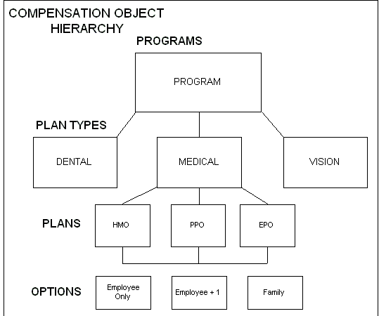

For most benefits and some types of compensation, you define compensation objects as well as elements. You can define a hierarchy of compensation objects, optionally starting with programs at the highest level, to represent a package of benefits you offer, followed by plan types, plans, and options. A plan type is a category of plans, such as a medical plan type. A plan is a specific offering, such as a health benefits plan, and an option is an electable choice within a plan.
If you use SSHR, employees can use self-service to enter voluntary contributions, such as Thrift Savings Plans. They can also manage their own enrollments in benefit plans, while the back-office maintains control of the plan's administration.
If you have defined compensation objects, you manage participation by defining eligibility profiles and attaching them to the appropriate level of the hierarchy. You can define several profiles for each object, and each profile can contain both required and optional criteria. For example, the profile could specify that eligible employees must work full time, and either have been employed for at least two years, or be assigned to a manager grade.
You can attach any number of activity rates to a plan or option to specify the contributions made by employee and employer, or the distributions, such as compensation awards. When you define an activity rate, you can associate it with an element. Activity rates support a variety of calculation methods to determine how much a person pays or receives: flat amount, multiple of premium, multiple of elected coverage, and so on. When a participant enrolls in a plan, the enrollment process runs the calculation and enters the result on an element entry for the employee.

Central to benefits administration are the compensation objects that you use to define, categorize, and manage the benefits that you offer to eligible participants. The four compensation object types that you use to structure your benefits offerings are programs, plan types, plans, and options.
Defining compensation objects is a key part of your overall plan design that includes defining eligibility and enrollment requirements, plan year periods, activity rates, and other elements of benefits management.
The hierarchical structure of compensation objects
Viewing a program structure that you have defined
Compensation objects are designed hierarchically so benefits that share similar features can be defined in similar ways. You build this hierarchical structure by defining attributes of the different compensation objects and then linking the components into a hierarchy.
Compensation Object Hierarchy
A description of the four compensation objects follows:
Program: A package of benefits offerings. Programs are important because they set the boundaries for the benefits you offer. You define many administrative procedures and rules at the program level.
Plan Type: A grouping of similar benefits offerings to facilitate their management. Example plan types include medical, dental, employee group life insurance, and savings.
Plan: A formally defined benefits offering that a participant can elect, such as a medical plan.
Option: A level of coverage for a participant's election, such as Employee Only for a medical plan, or 2x Salary for a life insurance plan.
Attributes set at the program level are inherited by each level of the compensation object hierarchy. However, if these same attributes are set at a lower level in the hierarchy, the compensation object inherits those attributes set at the lowest level at or above its level. A compensation object never inherits attributes set at a lower level in the compensation object hierarchy.

You define your compensation objects in the order below. As you define objects in the hierarchy, you associate objects together to form your program structure.
1. Define plan types.
2. Define options.
3. Associate options with plan types.
4. Define plans.
5. Associate options with plans.
6. Associate plans with plan types.
7. Identify which plans are not part of a program.
8. Define programs.
9. Associate plans and plan types with programs.
For example, let's say you want to define the medical plans offered by a benefits program you are administering. You first define the plan type of medical. Then, you define the coverage options available for the medical plan type, such as Family and Employee only.
Next, you define the medical plans in the plan type, such as an HMO or a PPO offering. Lastly, you associate the plans or plan type with a program that groups together a variety of plans and plan types into a single benefits offering.
You define plan types as categories of benefits grouped according to the type of benefit provided. Common plan types include medical, employee group life insurance, and savings.
Plan types are used to record administrative rules for all benefits of the same type. When you define a program that groups plans together, you specify parameters that control how plans of the same plan type behave.
Plan types are the most stable of the four compensation objects. Once you define the plan types that you need to support your benefits offerings, you rarely need to modify them.
You can define options for many purposes, but commonly you do so to define coverage available under one or more plans.
Options are re-usable. Once defined, you can associate an option with one or more plans. When you associate an option type with a plan type, you make options of that type available for selection to all plans in that plan type.

When you define a benefits plan, it is not necessary that the plan be placed in a program. However, there are advantages to associating a plan with a program. In general, a plan belongs in a program when:
Participants typically enroll in the plan at the same time they enroll in other plans in the program.
Participation eligibility requirements defined for the program also apply to the plan.
In general, a plan does not belong in a program (termed a "not in program plan") when:
Participants typically enroll in the plan at a different time than other plans in the program.
Participation eligibility requirements defined for the program differ substantially from those defined for the plan.
The benefits the plan provides differ substantially from the benefits provided by other plans in the program.
You define currency types at the program level. A plan in program must inherit the program's currency definition. You cannot associate a plan with more than one program if those programs use different currency types.
For example, let's say your organization defines two programs, a US Benefits Program and a Canadian Benefits Program. You must define different currency types for these two programs.
Accordingly, you must define two employee stock purchase plans: the US Employee Stock Purchase Plan and the Canadian Employee Stock Purchase Plan to accommodate the different currency types of the programs with which they are associated.

You link eligibility criteria profiles to a compensation object to restrict eligibility for that benefit. You can also define participation start and end dates and required waiting periods that control when an eligible person can enroll in a benefit.
You can link participation eligibility criteria to a compensation object at the following levels in the compensation object hierarchy:
Program (Program Participation Eligibility window)
Plan type in program (Plan Type Participation Eligibility window)
Plan in program (Plan in Program Participation Eligibility window)
Plan (Maintain Plan Eligibility window)
Option in plan (Maintain Options Eligibility window)
Follow the steps below regardless of the level or levels in the compensation object hierarchy at which you define participation eligibility.
See: Compensation Objects

You link a life event definition to a compensation object to restrict eligibility for that benefit to participants who experience that life event.
You can also define the participation start and end dates and required waiting periods that control when an eligible person can enroll in a benefit based on the occurrence of the life event.
You can link a life event definition to a compensation object at the following levels in the compensation object hierarchy:
program (Life Event window)
plan type in program (Life Event window)
plan in program (Life event window)
plan (Maintain Plan Related Details window, Life Events tabbed region)
option in plan (Life Event Reason Impact on Eligibility window)
Follow the steps below regardless of the level or levels in the compensation object hierarchy at which you link a life event to a compensation object.

You use the View Program Structure window to view the benefit programs that you have defined and the plan types, plans, and options that comprise these programs. Use this window after you have recorded your plan design in the system to make sure you have correctly defined the structure of your benefits programs.
In the hierarchy:
+ A plus symbol to the left of a compensation object indicates that there are lower levels that are not currently displayed.
- A minus symbol to the left of a compensation object indicates that you are viewing a collapsible list that you have expanded fully.
= An equals symbol indicates that you are viewing the lowest level within a collapsible list that you have expanded fully.
Go To modify the definition of a compensation object, select the compensation object and choose the Go (traffic light) button.
You can expand or contract the program hierarchy in the same way that you expand or contract the Oracle Applications Navigator.
To expand the view of a compensation object by one level, select the compensation object and choose the Plus (+) button (or double-click on that compensation object).
To contract the view of a compensation object by one level, select the compensation object and choose the Minus (-) button (or double-click on that compensation object).
To fully expand the view of a compensation object, select the compensation object and choose the Full Plus (+->) button.
To fully contract the view of a compensation object, select the compensation object and choose the Double Minus (- -) button.

Eligibility is determined according to the order of the compensation object hierarchy:
Program
Plan Type in Program
Plan in Program
Plan
Option in Plan
If a participant is eligible for a program, then the system checks for plan type in program eligibility, and so on down the hierarchy. This allows you to link different eligibility profiles to different benefits that you offer within a program.
