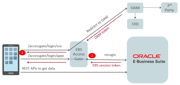

To better understand the setup tasks specifically for mobile apps with Apps SSO Login, the following diagram illustrates the high level process flow when authenticating Oracle E-Business Suite mobile users using single sign-on in the case of TLS configuration:
Note: Oracle E-Business Suite mobile apps work with any single sign-on configurations for Oracle E-Business Suite.
High Level Process Flow for Apps SSO Login Authentication with TLS Configuration
In this diagram, there are two different REST invocation points (client vs server) which require you to import certificates into appropriate truststores:
Scenario 1: TLS client invocation from a mobile app
This scenario invokes the following two endpoints:
Oracle E-Business Suite AccessGate
A mobile user attempts to log in to an app through the value configured in the "SSO Login URL" (login/sso) parameter. The user is directed to Oracle E-Business Suite AccessGate (EAG) which is protected by the Oracle Access Manager (OAM) server for user authentication. When the user enters the login credentials in the Sign In screen, OAM verifies the credentials against user directory. If the user is successfully authenticated, OAM returns a unique OAM access token to Oracle E-Business Suite AccessGate for further identification verification, as described in Scenario 2.
Oracle E-Business Suite REST endpoint on the server
Once the user is successfully authenticated to access Oracle E-Business Suite from the mobile app, the mobile app uses "EBS Session Service" (login/apps) to create a valid Oracle E-Business Suite session. The user then performs desired actions through Oracle E-Business Suite REST APIs to fetch Oracle E-Business Suite data for the app.
Scenario 2: TLS client invocation from Oracle E-Business Suite AccessGate to invoke Oracle E-Business Suite application tier
Oracle E-Business Suite AccessGate is a Java Enterprise Edition application that maps a single sign-on user to an Oracle E-Business Suite user. Once picking up the access token from OAM, Oracle E-Business Suite AccessGate verifies the user identification against the Oracle E-Business Suite database. If the verification is successful meaning that this is a valid Oracle E-Business Suite user, an Oracle E-Business Suite session token is returned. The session token that points to the user session will be passed to HTTP headers of all subsequent service calls for the user authentication.
To successfully invoke the Oracle E-Business Suite application tier from Oracle E-Business Suite AccessGate as described in this scenario, custom CA or self-signed certificates used in Oracle E-Business Suite application tier should be imported to the Oracle E-Business Suite AccessGate truststore.
