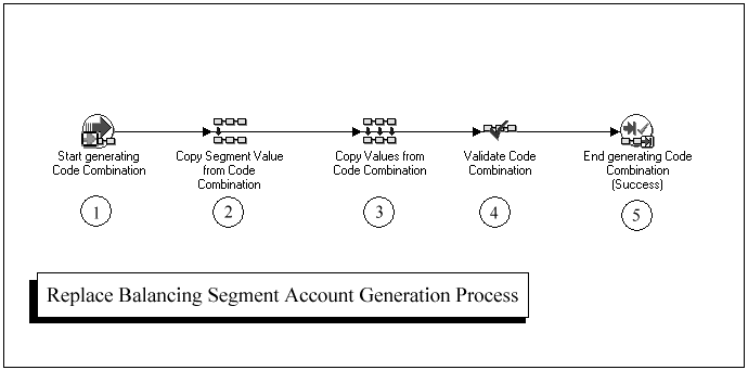

The Replace Balancing Segment process consists of three unique activities that comprise the five activity nodes that appear in the following workflow diagram.
In the workflow diagram shown below, the process activity nodes are numbered for reference in the descriptions that follow. (The numbered circles are not part of the process diagram.)
Replace Balancing Segment Process
Following is a description of each activity in the sample process for Replace Balancing Segment Account Generation, listed by function name. You can create all the components for an activity in the graphical Oracle Workflow Builder except for the PL/SQL stored procedures that the function activities call.
This is a standard activity that marks the start of the process.
Node 2 copies the new balancing segment value from the substitution code combination ID (CCID). For examples of how the Account Generator derives the balancing segment for different accounting activities, see: Deriving Balancing Segment Values.
This activity copies the remaining segment values from the original code combination into the new code combination for this transaction.
Node 4 contains the standard Flexfield function for validating a code combination. For this function to work, the attribute value New code combinations must be set to True.
This standard activity ends the code combination generation process.

If you want to create a new process to meet your company's needs, use the Oracle Workflow Builder to create a new process, or copy the existing default and change the name before making extensive changes to it.
For more information about the generic features and functions of the Account Generator, see: Customizing the Account Generator, Oracle E-Business Suite Flexfields Guide.
For more information about how to use the Oracle Workflow Builder, refer to the Oracle Workflow User's Guide.
For example, you can customize the AR Substitute Balancing Segment item type to use a different balancing segment for either the late charges or Receivables account.
You must test any modified Account Generator process before using it on a production database.
To test your customized Account Generator Process, run the Create Accounting program, then verify that the Account Generator substituted the correct segment for that account.
If you have customized your Account Generator process for a particular Account Generator item type and assigned a new name to it, use the Account Generator Processes window to associate the new process name with the appropriate Accounting Flexfield structure and item type.
If you made customizations to the default process, but did not change the name of the process, then you do not need to perform this step.
Select the structure to which you want to assign a process. You can choose the application, flexfield title, structure, and description from the list of values.
Specify the Item Type containing the process, for example, Replace Balancing Segment.
Specify the process you want to use to generate the accounts.
The default process, Replace Balancing Segment, will be the default. If you want to use a different process, enter the name of the process you want to use.
