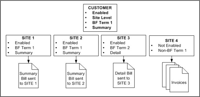

Use site level balance forward billing to generate balance forward bills consolidated at site level.
To generate site level bills, select Site as the bill level at the customer profile class and account profile level. The Bill Level at the site profile level is a read-only field, defaulted from the account profile level. The values for Type and Payment Term set at each site profile level are used for billing that site. These values can be different for each site.
Under site level balance forward billing, both balance forward billing and non-balance forward billing sites can exist under the same account. Receivables generates individual invoices for the non-balance forward billing sites and a bill per site for the balance forward billing sites. You can designate each site of the account as either balance forward billing or regular billing by enabling or disabling balance forward billing at the site profile level. See: Disabling Balance Forward Billing.
You can exclude specific transactions from a site level balance forward bill if you selected Override Terms while defining the balance forward billing payment term at the account profile level. You can generate regular individual invoices for such transactions by assigning them an appropriate non-balance forward billing payment term.
The following diagram illustrates site level balance forward billing.
Customer with Site Level Balance Forward Billing
In this example, the customer has four sites under the same operating unit. While balance forward billing is enabled at sites 1, 2, and 3, Site 4 is set up for regular billing.
Consequently, a unique and distinct balance forward bill will be generated for each site 1 through 3. However, Regular, individual invoices are sent to the bill-to addresses of Site 4's transactions. Additionally, if this customer's account profile has Override Terms selected, then any transactions with non-balance forward billing payment terms at Sites 1, 2, and 3 are excluded from the respective site-level balance forward bill and also receive individual invoices.

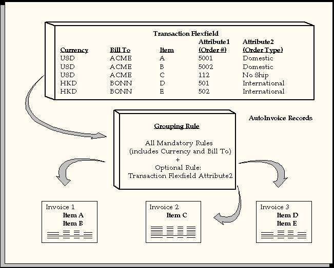

In the diagram below, the grouping rule specifies that to appear on the same invoice items must match on all of the mandatory attributes, for example currency (CURRENCY_CODE) and bill-to address (ORIG_SYSTEM_BILL_ADDRESS_ID) and must also match on the optional attribute of order type (SALES_ORDER_SOURCE). For example, in the diagram, assume that all mandatory attributes match other than currency and bill-to address. Items A and B share the same currency and order type, so they appear on the same invoice (Invoice 1). Item C has the same currency as A and B, but it has a different order type, so it appears on its own invoice (Invoice 2). Items D and E share the same currency and Order Type, so they appear on the same invoice (Invoice 3).
Using Grouping Rules
For a text description of this graphic, see Text Description of the Using Grouping Rules Graphic.
AutoInvoice uses the following hierarchy to determine which grouping rule to use for a transaction line:
1) The grouping rule specified in the Transaction Sources window for the batch source of the transaction line
2) The grouping rule specified in the Customer Profile Classes window for the bill-to site use of the transaction line
3) The grouping rule specified in the Customer Profile Classes window for the bill-to customer of the transaction line
4) If you do not specify a rule in either the Transaction Sources or Customer Profile Classes window, AutoInvoice uses the default grouping rule specified in the System Options window. See: Defining Receivables System Options.
Receivables provides the DEFAULT grouping rule which contains all of the mandatory attributes. If you upgrade from a previous version of Receivables, the DEFAULT grouping rule initially becomes your default grouping rule. If you use the DEFAULT rule to create transactions, Receivables does not require that you define any additional grouping rules. You can add optional attributes to the DEFAULT grouping rule to create new grouping rules. You cannot delete any mandatory attributes from a grouping rule.

Enter a Grouping Rule to use for a transaction line (optional). If you do not enter a grouping rule, AutoInvoice uses the following hierarchy to determine which rule to use:
The grouping rule specified in the Transaction Sources window for the batch source of the transaction line.
The grouping rule specified in the Customer Profile Classes window for the bill-to customer and bill-to site of the transaction line.
The grouping rule specified in the Customer Profile Classes window for the bill-to customer of the transaction line.
The default grouping rule specified in the System Options window.

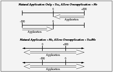

The Natural Application Only and Allow Overapplication options determine how applications can affect the balance due for transactions using this type. Natural Application refers to the type of application, either positive or negative, that a transaction requires to become closer to zero. For example, invoices have a positive balance, so to reduce the balance due you need to create a negative application (such as apply a receipt).
Overapplication indicates whether you can overapply transactions using this type. For example, if you apply a $500 receipt to a $400 invoice, you overapply the invoice and reverse its sign (from positive to negative).
The figure below shows how these rules affect your applications.
Natural Application and Overapplication
For a description of this graphic, see: Description of Natural Application and Overapplication.
Whether or not a transaction allows overapplication determines the actions that you can take on that transaction.
For example, a fully paid transaction's transaction type allows natural application only (in other words, prohibits overapplication). To credit that transaction, you must first unapply the transaction from the receipt before you can create the credit. See: Unapplying Cash when Crediting a Transaction, Oracle Receivables User Guide.
