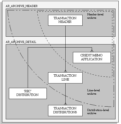

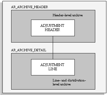

The Archive and Purge program provides three levels of detail for archiving transaction information. You can archive just header level data for your transactions; header and line level data; or header, line, and distribution data.
Archived transactions are stored in the AR_ARCHIVE_HEADER and AR_ARCHIVE_DETAIL tables. The header table stores records of three types: Transactions (Invoices, Credit or Debit Memos, Guarantees, Deposits, Chargebacks, and On-Account Credits), Receipts and Adjustments. Records stored in the detail table relate to these header records.
The following diagrams illustrate the relationships between the records in these two tables.
Note: Regardless of the level of detail you choose to archive, the purge portion of this program will remove all records for the selected transaction and all related transactions.
Archive different levels of transaction data
Notes on the above diagram:
Header records relate to detail records using transaction_class and transaction_id. Detail records are credit memo application(s), transaction line(s) and a distribution of type 'REC'.
Line records in AR_ARCHIVE_DETAIL relate to distributions in the same table using transaction_class, transaction_id and transaction_line_id.
For credit memos, 'related' columns in AR_ARCHIVE_HEADER indicate the credited transaction, or for invoices, they indicate the commitment applied (if applicable).
For transaction lines, 'related' columns in AR_ARCHIVE_DETAIL indicate the credited line and the commitment line applied to the transaction (if applicable).
For credit memo applications, 'related' columns in AR_ARCHIVE_DETAIL indicate the transaction credited

Archive different levels of adjustment data
'Related' columns in AR_ARCHIVE_DETAIL indicate the adjusted transaction in AR_ARCHIVE_HEADER.
No additional columns records are stored for a distribution level archive.

If you select HEADERS, LINES and DISTRIBUTIONS additional records will be archived. These records will contain the following information plus reference data to relate them to the appropriate line record in this table.
| AR_ARCHIVE_DETAIL | Source Database Columns | Source Columns | Derived From Database Tables | Derived From Columns |
| ACCOUNT_COMBINATION1 | GL_CODE_COMBINATIONS | SEGMENT1-SEGMENT30 | RA_CUST_TRX_LINE_GL_DIST | CODE_COMBINATION_ID |
| GL_CODE_COMBINATIONS | SEGMENT1-SEGMENT30 | AR_ADJUSTMENTS | CODE_COMBINATION_ID | |
| GL_CODE_COMBINATIONS | SEGMENT1-SEGMENT30 | AR_CASH_RECEIPT_HISTORY | ACCOUNT_CODE_COMBINATION_ID | |
| GL_CODE_COMBINATIONS | SEGMENT1-SEGMENT30 | AR_MISC_CASH_DISTRIBUTIONS | CODE_COMBINATION_ID | |
| GL_CODE_COMBINATIONS | SEGMENT1-SEGMENT30 | AR_RECEIVABLE_APPLICATIONS | CODE_COMBINATION_ID | |
| ACCOUNT_COMBINATION2 | GL_CODE_COMBINATIONS | SEGMENT1-SEGMENT30 | AR_CASH_RECEIPT_HISTORY | BANK_CHARGE_ACCOUNT_ID |
| ACCOUNT_COMBINATION3 | GL_CODE_COMBINATIONS | SEGMENT1-SEGMENT30 | AR_RECEIVABLE_APPLICATIONS | EARNED_DISCOUNT_CCID |
| ACCOUNT_COMBINATION4 | GL_CODE_COMBINATIONS | SEGMENT1-SEGMENT30 | AR_RECEIVABLE_APPLICATIONS | UNEARNED_DISCOUNT_CCID |
