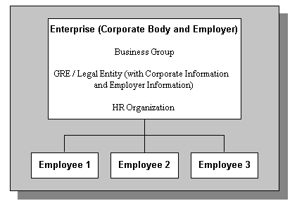

For example, if your enterprise is in a single location and working on a single project, you could set up an organization that has the following classifications:
Business Group
GRE / Legal Entity (with the Corporate Information and Employer Information organization information types completed)
HR Organization (so that employees can be assigned to the organization in the Assignment window)
You could select this organization both in the CN Statutory Info and Assignment windows. You may also assign other classifications to this organization. The following figure depicts this organization:
Sample Organization Setup for Single Location, Project

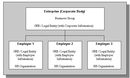

If your enterprise is in one place and your workforce divided among projects and functions, then you could set up an organization with these classifications:
Business Group
GRE / Legal Entity (with the Corporate Information organization information type completed)
Under this organization, you could set up an employer for each project or function. The organizations that you create for your employers would have these classifications:
GRE / Legal Entity (with the Employer Information organization information type completed)
HR Organization (so that employees can be assigned to your employers in the Assignment window)
You could also assign other classifications to your organizations. Then, your setup would resemble that depicted by the following figure:
Sample Organization Setup for Single Location, Multiple Projects / Functions

You enter employer information, such as the names of registration authorities for statutory insurance, for your enterprise's divisions. You must have this information for preparation of statutory reports to submit to the People's Republic of China government. These reports pertain to income tax and statutory benefits such as the Public Housing Fund (PHF).
A Government Reporting Entity (GRE) with employer information may be regarded as an employer. For example, your enterprise's divisions in Shanghai and Beijing are region-specific employers that report to your enterprise's head office.
Important: At least one organization in your organization hierarchy must have employer information. Only organizations with employer information are displayed in the Employer field of the CN Statutory Info window.
Use the Employer Information window to enter employer information for your enterprise's division.
