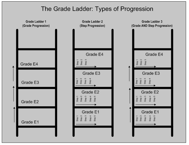

Grade/Step Progression is a business process that enables you to move large numbers of employees from one grade or grade step to the next, in an automated, bias-free way.
You do this by defining how employees become eligible for progression and the details of the grade or step to which they are eligible to progress (including the rate of pay associated with the proposed step or grade). Then, you run a pre-process to check which employees are eligible for progression according to your rules. This triggers a post-process that either progresses eligible employees automatically, or identifies them as eligible so that you can approve their progression manually (depending on how you set up Grade/Step Progression). If you have set up Grade/Step Progression to apply automatic salary updates, the application makes these salary changes and passes them to your payroll.
In order to understand Grade/Step Progression, you need to understand the following key concepts:
Grade Ladder
Salary Rates
Progression Rules
At the centre of grade/step progression is the grade ladder. You use the grade ladder to:

The graphic below illustrates the types of progression the grade ladder supports:
As shown in this graphic, you can set up a grade ladder to progress employees in one of the following three ways:
From one grade to another. Example: Grade E1 to Grade E2.
From one grade step to another grade step (on the same grade). Example: Step 3 on Grade E2 to Step 4 on Grade E2.
From one grade step to another grade step (on another different grade). Example: Step 5 on Grade E2 to Step 2 on Grade E3.
Note: You can only progress employees within the same grade ladder, and not across different grade ladders.
