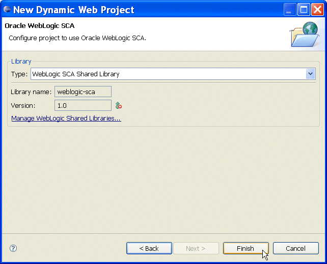

  6. Click Finish on the New Dynamic Web Project > WebLogic SCA screen that Figure 5 shows to complete your configuration.
    Figure 5.
    Configuring Project to Use WebLogic SCA
Upon the completion of the configuration, OEPE adds WebLogic SCA shared library and Spring library to your project, as well as creates the spring-context.xml file in your project's META-INF/jsca directory, as Figure 6 shows.

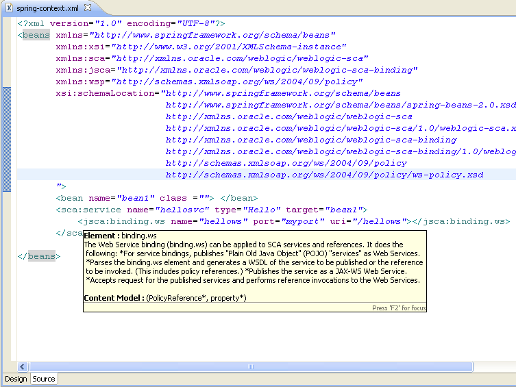

2. Using Context Help for WebLogic SCA XML Attributes
OEPE provides context help for each SCA XML element and attribute. To access help topics, hover the mouse over elements in the XML editor, as Figure 8 shows:
Figure 8.
Using Context Help

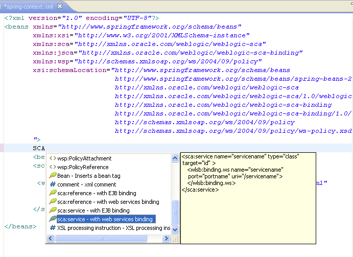

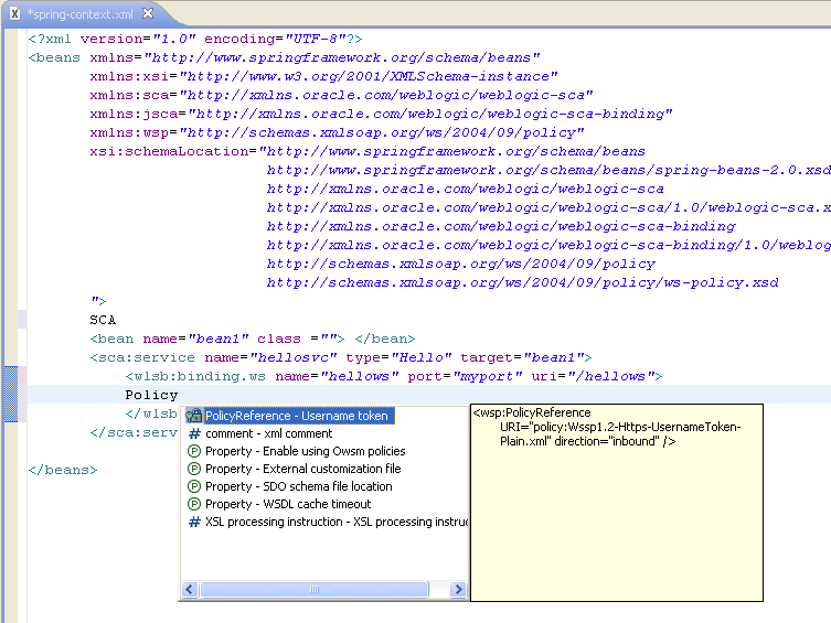

3. Creating Complex Properties Using XML Template
OEPE provides a set of XML templates that you can use to populate a predefined group of XML elements. This facilitates creating of complex properties in binding specification, such as, for example, the PolicyReference.
To invoke an XML template, you type the name of the template (for example, "SCA"), and then press "CTRL + Space" key compbination.
You can use the following XML templates (see Figure 9) for creating WebLogic SCA definitions:
  • SCA service with Web services binding
  • SCA service with EJB binding
  • SCA reference with Web services binding
  • SCA reference with EJB binding
Figure 9.
WebLogic SCA Template
Inside of WebLogic SCA Service with Web services binding, you can invoke the PolicyReference template (see Figure 10) to further customize the binding security setting, as follows:
  • PolicyReference: Username token with message protection: WSS 1.0 X509 with asymmetric binding.
  • PolicyReference: Username token with message protection: WSS 1.1 symmetric binding and authentication with plain-text Username Token which is encrypted and signed using the Symmetric key.
  • PolicyReference: X509 certificate authentication with message protection (WSS 11).
  • PolicyReference: Anonymous with message protection (WSS 11).
  • PolicyReference: ID Propagation using SAML token [sender-vouches] with message protection (WSS 11).
  • PolicyReference: Username token over SSL.
  • PolicyReference: SAML token (Sender Vouches) over SSL.

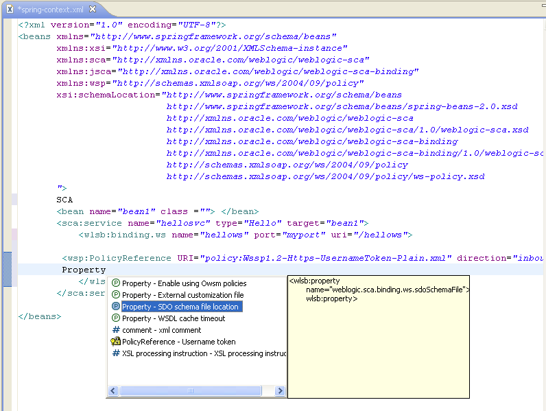

Applicable to both WebLogic SCA Service and SCA Reference, the Property template (see Figure 11) is also available to further customize the binding security setting, as follows:
  • Property: SDO schema file location.
  • Property: External customization file.
  • Property: WSDL cache timeout. Note that this Property (weblogic.sca.binding.ws.referenceWsdlCacheTimeoutMins) applies to references only.
  • Property: Enable using Owsm policies.
Figure 11.
Property Template

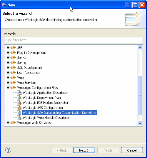

4. Creating WebLogic SCA Data-Binding Customization Descriptor
With OEPE, you can create WebLogic SCA data-binding customization descriptor for which the schema file is bundled. This descriptor defines the external mapping metadata for the data-binding framework. The data is used to define the attributes of a particular Java Web service endpoint interface. Each change that you make to the XML will be validated against the schema.
You create WebLogic SCA data-binding customization descriptor as follows:
  • In the Project Explorer, right-click a Java directory in within your Web project and select New > Other from the drop-down menu to open the New > Select a wizard dialog that Figure 12 shows. From the list of available wizards, select WebLogic Configuration Files > WebLogic SCA Databinding Customization Descriptor, and then click Next.
    Figure 12.
    Select Wizard Dialog

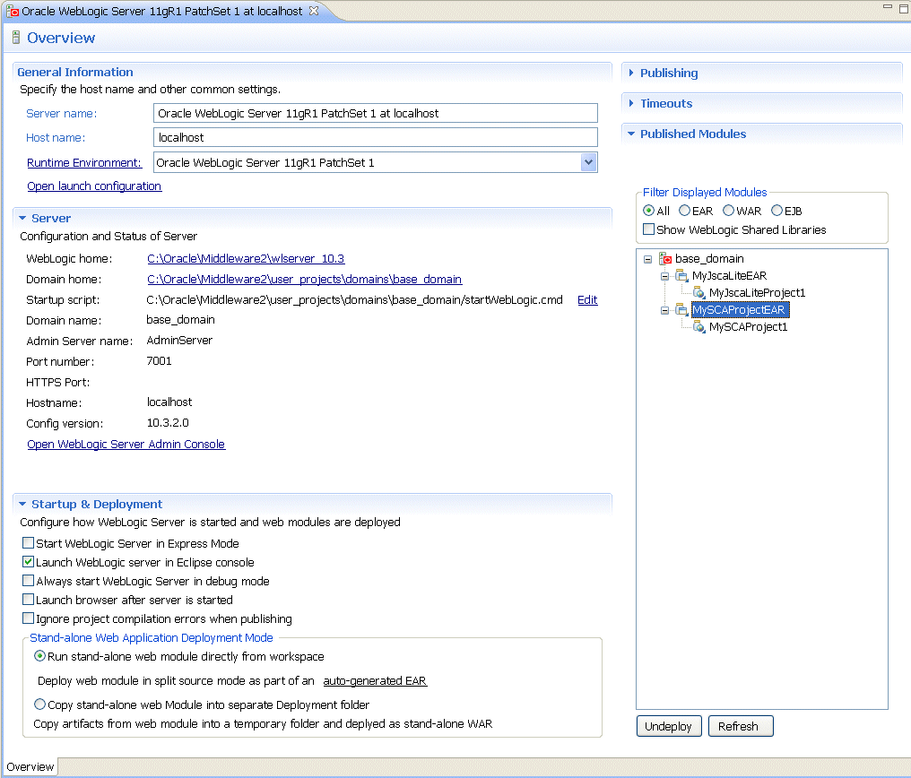

  • Open the server configuration (Overview) page by double-clicking on the server name in the Servers view. Ensure that the information is correct. Notice that the domain area does not contain your project's name.
  • Add your configured project's EAR to the server, as Figure 15 shows. To do so, right-click Oracle WebLogic Server 12c (12.1.1) at localhost in Servers view, select Add and Remove Projects from the drop-down menu, find your the EAR in the list of projects, and then click Add followed by Finish on the Add and Remove Projects dialog.
    Figure 15.
    Adding Project to the Server
    Now the server configuration page displays the project and its EAR under the base_domain, as Figure 16 shows.
    Figure 16.
    Server Configuration Page

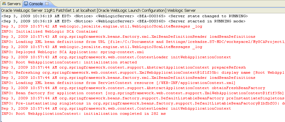

    The server console displays the deployment logging information, as Figure 17 shows.
    Figure 17.
    Server Logging Information
