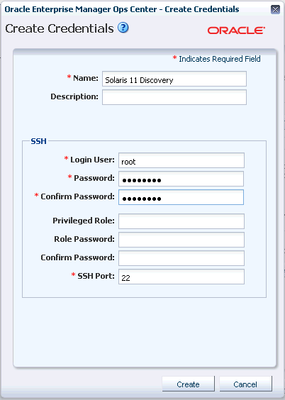

Assets are managed using a set of credentials. You can create or use existing credentials to discover and connect with assets.
When creating a credential, if your target OS supports root login, enter a root user (or other privileged user) and leave the Privileged Role field blank. If the target OS does not support root login, then enter a non-root user that can login to the OS and also specify a root/privileged user in the Privileged Role field.
In the Name field, enter a name for the credential.
In the Description field, enter a description.
In the Login User field, enter a user name to login.
In the Password field, type a password. Retype the same password in the Confirm Password field.
If a non-privileged user logs in, Oracle Enterprise Manager Ops Center runs the "su" command to elevate the user to a root/privileged user.Enter the SSH port number. The SSH port number is populated by default.
Click Create. The user credential is created.

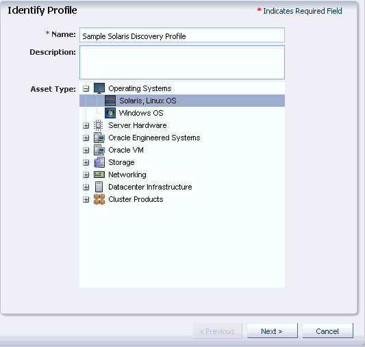

Enter a name and description for the discovery profile.
In the Asset Type, under Operating Systems, select Solaris, Linux OS. Click Next.

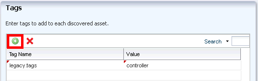

Click the Add icon (highlighted in red in the following figure) to add tags to the discovered operating system. Select a tag name and enter a value for the tag. Click Next.

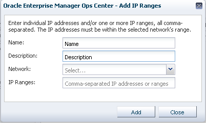

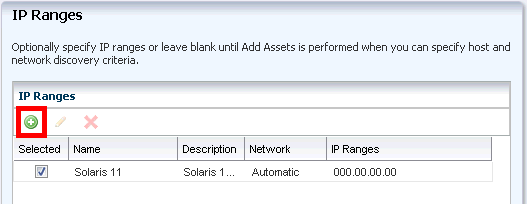

Enter the IP Ranges. Click the Add icon (highlighted in red in the following figure) to add IP Ranges.
Enter values in the respective fields and click Add, then click Next.
Name - A name for the IP range.
Description - A description for the IP range, so that it can be identified and reused.
Network - The managed network with which the host names or IP addresses are associated. This is used to route the discovery to the correct Proxy Controller. When a Proxy Controller cannot reach the assets' network, the discovery will fail. Select Automatic to route the job to the most appropriate Proxy Controller.
IP Ranges - The IP range to be targeted.

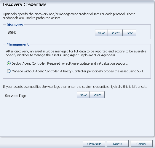

In the Discovery Credentials wizard, click Select to choose an SSH protocol. Under Management, select Deploy Agent Controller option, then click Next.

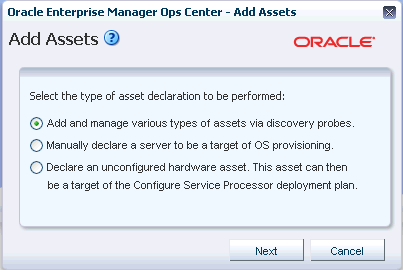

Click Add Assets in the Actions pane.

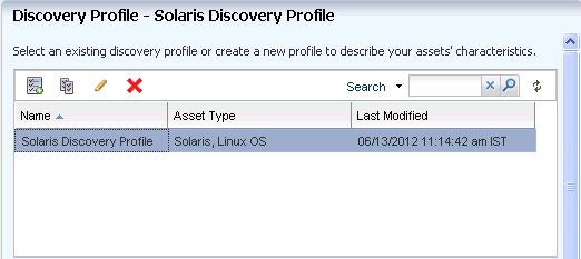

Select Add and Manage Various Types of Assets via Discovery Probes, then click Next.
Select the newly-created discovery profile.

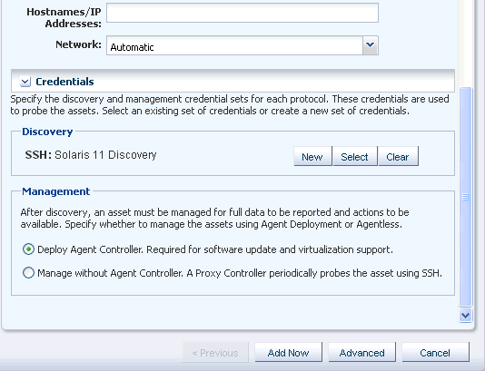

Discovery - Click Select to select the existing set of credentials.
Management - Select Deploy Agent Controller to automatically install Agent Controllers on the discovered operating system.
Click Add Now to launch the discovery. The discovery job is launched.
