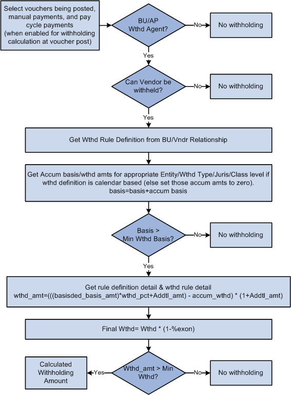

 Understanding Withholding Calculation
Understanding Withholding CalculationThe PeopleSoft Payables calculation module calculates withholdings at voucher posting or at payment processing, depending on the withholding calculation setting on the withholding entity and the voucher.
The following diagram illustrates how the calculation model works (note that calculation for India is slightly different):
Withholding calculation process flow
