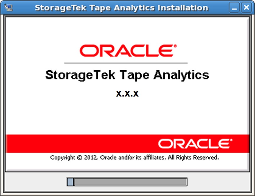

# ./install

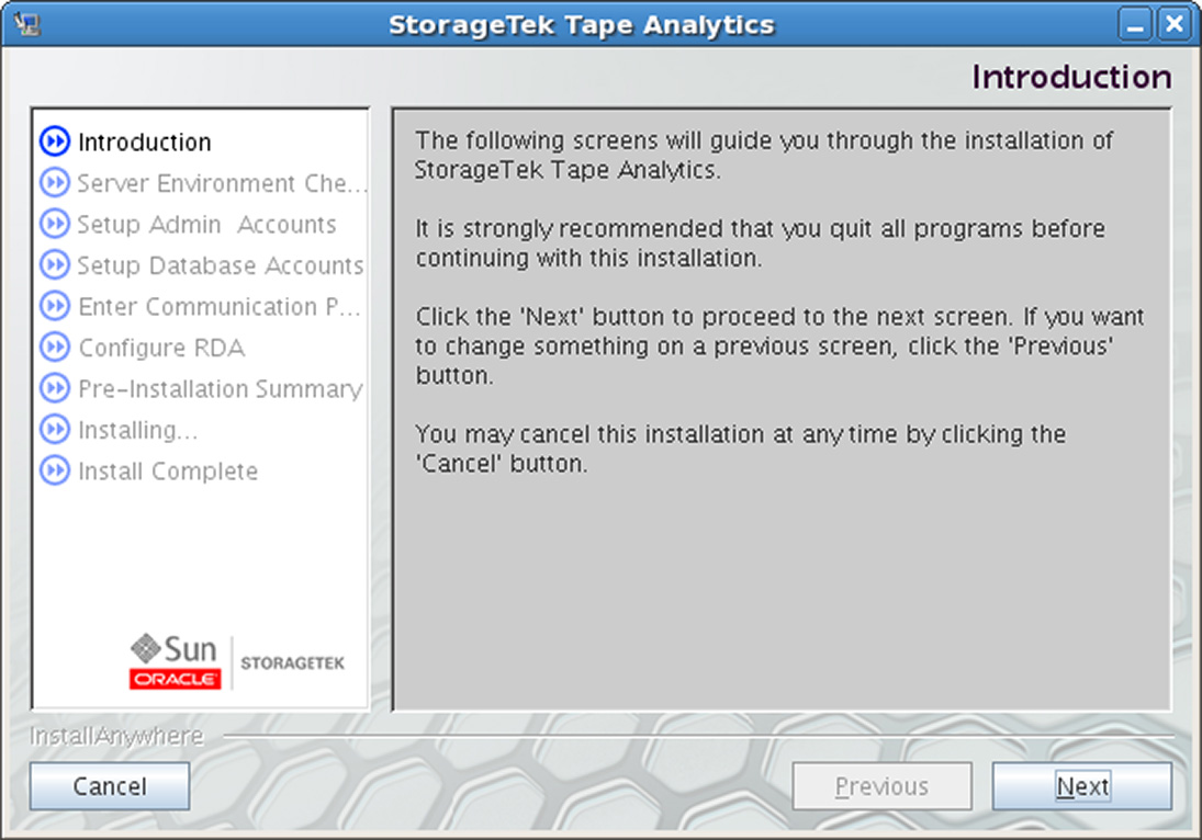

5.

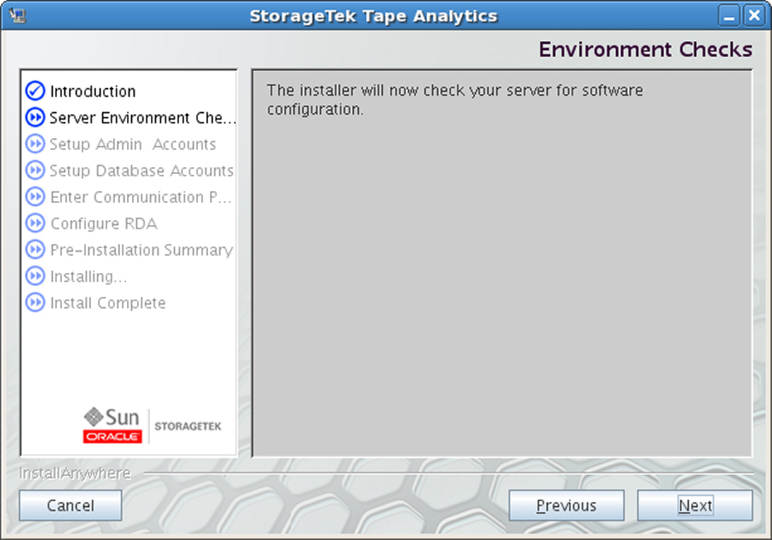

Click Next on the Environment Checks screen. The STA installer will check your environment for existing software and settings.
Caution – If the installer detects existing software (/Oracle/Middleware directory or MySQL), or you receive any other messages relating to your environment, see “Before Installing STA” before proceeding.

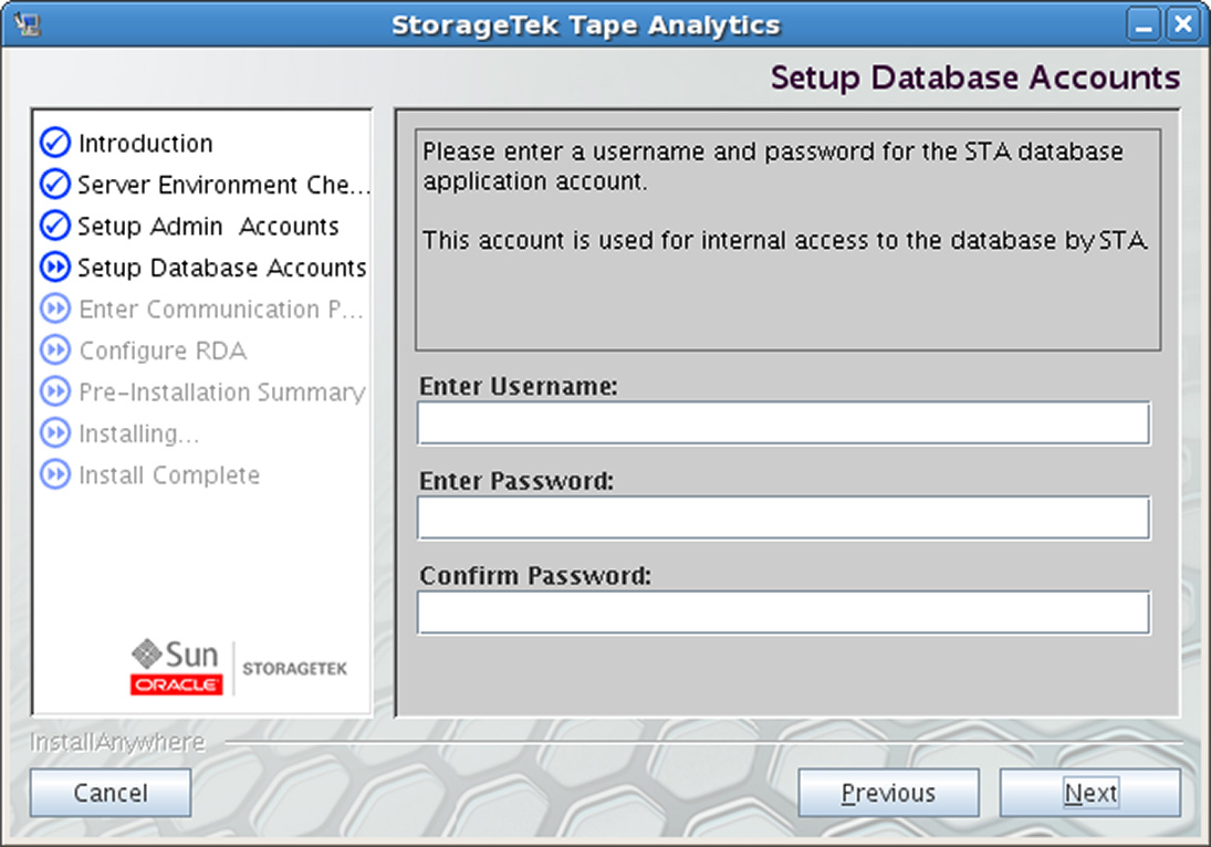

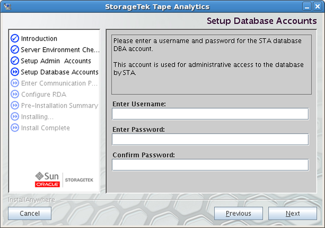

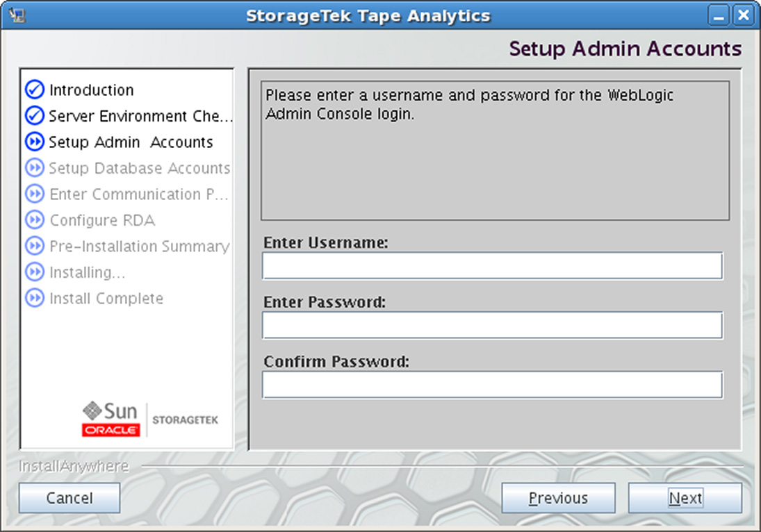

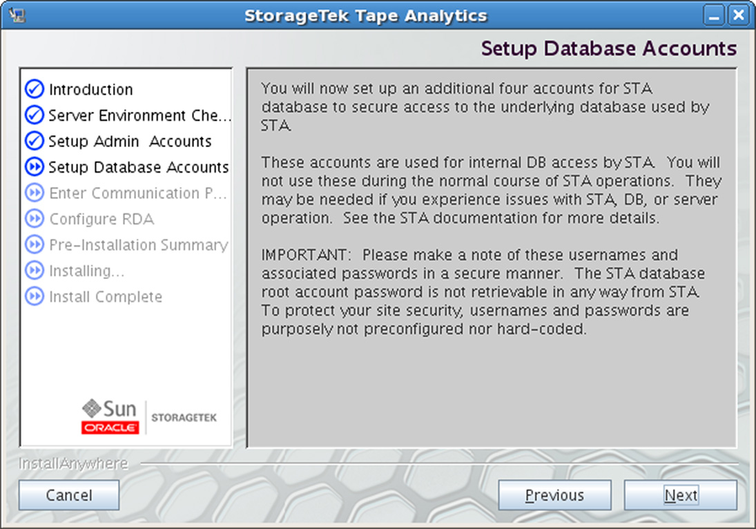

Note – If you ever need to change the database account passwords you establish in the following steps, see the “Password Administration” chapter within the StorageTek Tape Analytics Administration Reference Guide.
10.
11.
12.
13.
14.
Note – If you are unsure about what port numbers to choose, contact your network administrator before proceeding.

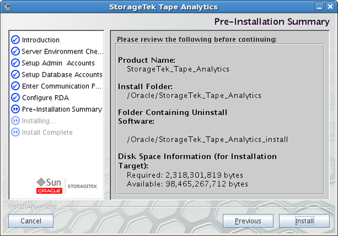

18.
Note – Changes to your system are not implemented until you click Install. You can click Previous to change any settings.

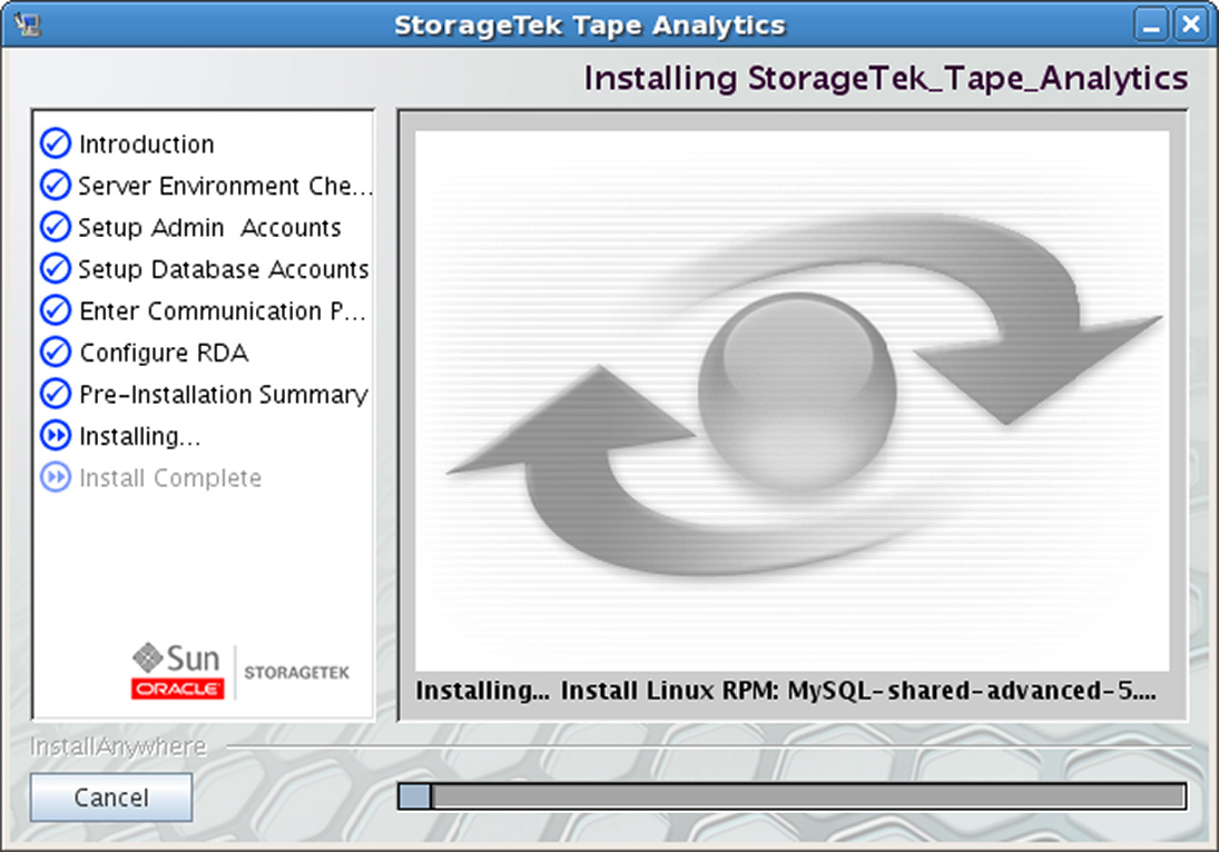

19.
20.
21.
Note – For more information about the STA command, see the “Server Administration” chapter within the StorageTek Tape Analytics Administration Reference Guide.
# STA status

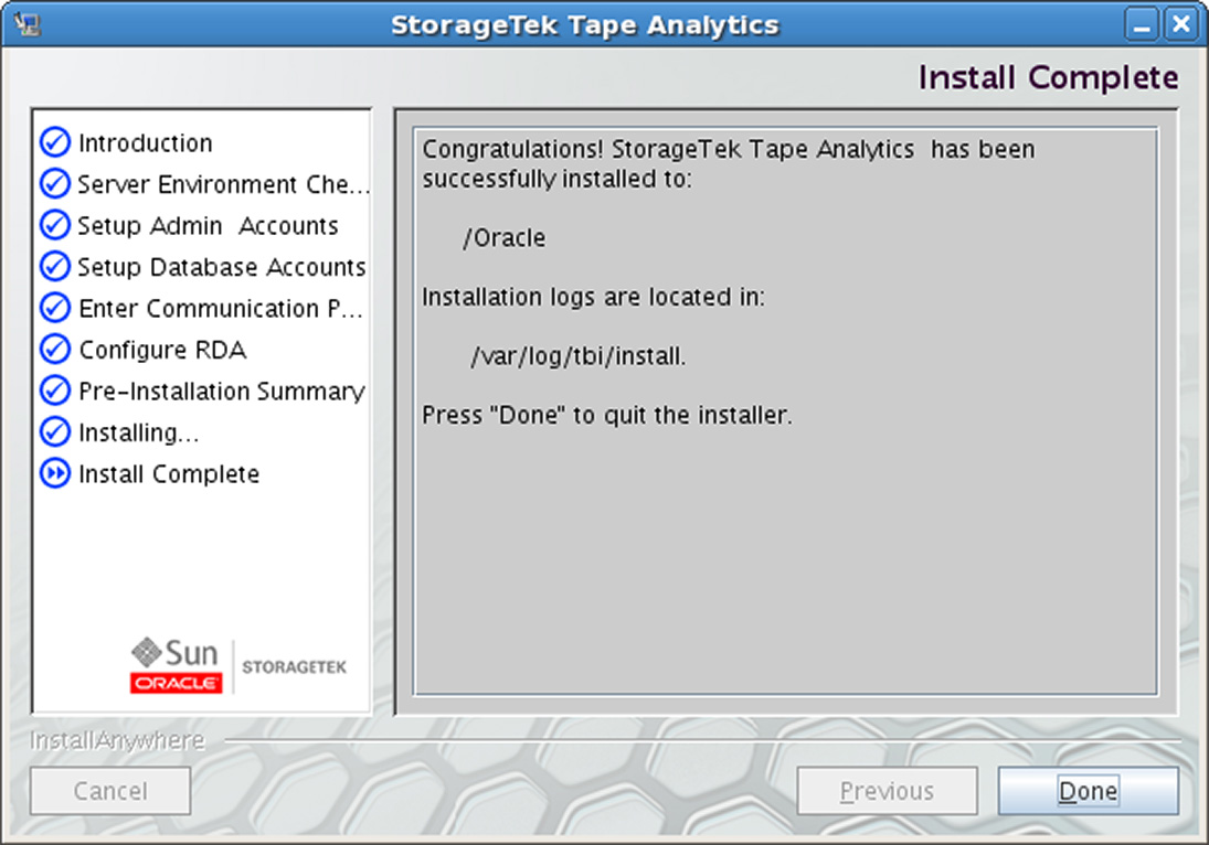

22.
STA installation is complete. You may now configure STA using the StorageTek Tape Analytics Configuration Guide.
