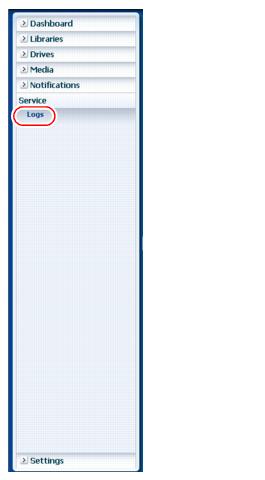

Access the Service Logs Screen
1.
The Service Logs screen is displayed.
