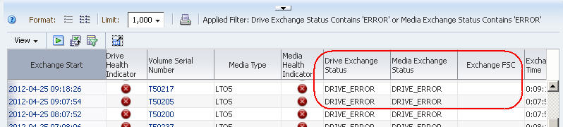

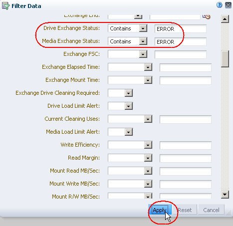

Using the Libraries – Exchanges Screen
In cases where each “job” is an independent exchange (that is, mount, read/write data, dismount), you can use this method to access information about tape job failures.
1.
2.
3.
a.
b.
Note – Entries are case-sensitive, so you must enter all upper-case characters.
c.

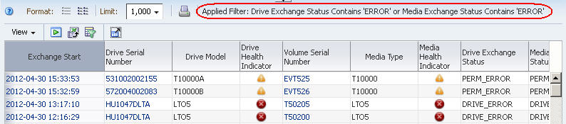

The table is updated according to your selection criteria.
Note – The “Drive Health Indicator” and “Media Health Indicator” columns may indicate “Use” even after an error. This is because the values of these attributes are aggregated over time. The specific values depend on the frequency and severity of errors, and whether there have been subsequent exchanges with no problems. Recent exchanges with no problems move the aggregated value toward a “Use” status.
4.
By default, the rows of the table are sorted by “Exchange Start” time.
5.

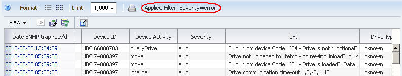

Using the Notifications – Overview Screen
In cases where you know the time of a job failure, you can use this method to check for related error notifications.
1.
1.

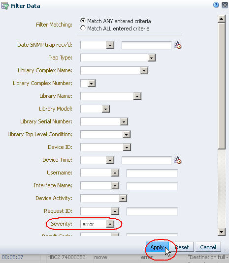

2.
a.
b.
c.
3.
By default, the rows of the table are sorted by “Date SNMP trap recv’d” time.
