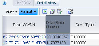

By mouse
1.
Note – Columns are resized from the right side only.
Note – You cannot resize a column from the data rows area.
Note – In this example, the Drive WWNN column will be resized, and the width of the Drive Serial Number column will not change.

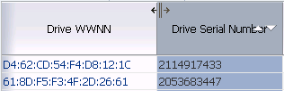

2.
A dotted vertical line appears to indicate the pending width. You can move the border back and forth as much as you want until you get the right width.
3.
The column is resized. All other columns retain their original widths.
