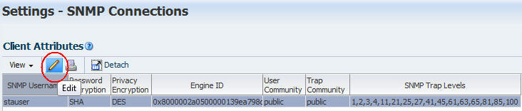

Use this procedure to modify existing connection settings for STA, which in the SNMP model is the client or network management system (NMS). You can modify any of the following settings:
Caution – These settings are also defined on each monitored library, and for the SNMP connection to be successful, the values specified in this procedure must match the ones on the library. See “Configuring the Libraries for STA” in the STA Configuration Guide for instructions on modifying these settings on the library.
Caution – After performing this procedure, you must test connections for all monitored libraries. Failure to do so could result in dropped library connections and lost SNMP traps. See “Test a Library SNMP Connection” for details.
1.
2.

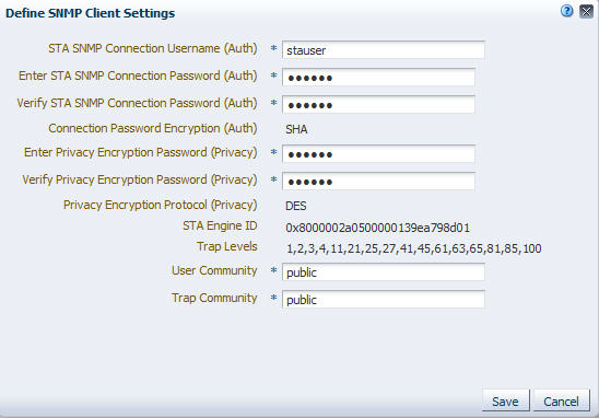

The Define SNMP Client Settings dialog box appears.
3.
Enter the changes you want to make, and click Save.

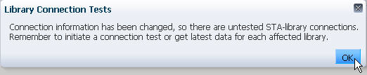

An information message appears, reminding you that a library connection test is required whenever you add or modify library connections.

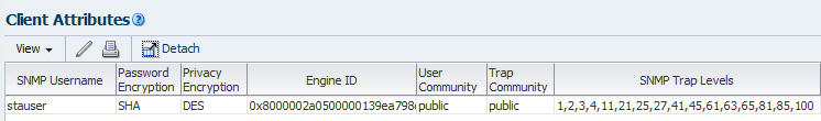

The Client Attributes table is updated with your changes.
