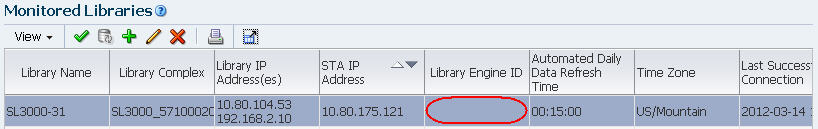

An information message appears, reminding you that a library connection test is required whenever you modify library connections.
4.
The Monitored Libraries table is updated with your changes.
Caution – Note that the Library Engine ID field in the table is now blank. This happens automatically whenever you change library connection settings and is an indication that the SNMP connection with the library has been dropped. You must next perform a connection test to re-establish the connection.
5.
Proceed to “Test a Library SNMP Connection” to re-establish the SNMP connection with each monitored library.
