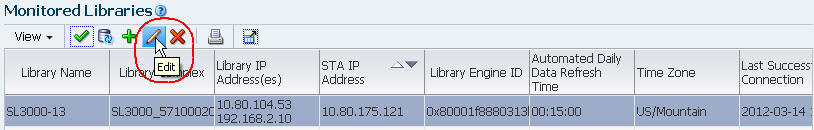

1.
2.

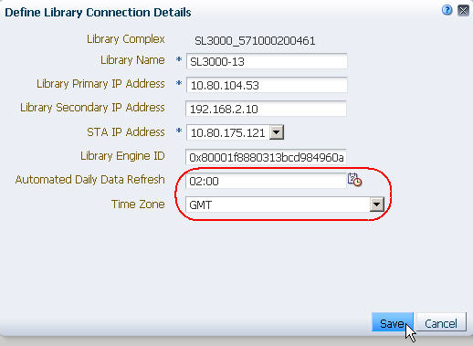

The Define Library Connection Details dialog box appears.
Note – The currently defined data collection time is displayed in the “Automated Daily Data Refresh” and “Time Zone” fields.
3.
In the “Automated Daily Data Refresh” field, enter the time in 24-hour hh:mm format. You can either type directly into the field or you can click the date-time icon on the right to display the date-time editor.

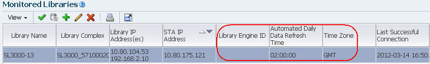

Click Save.
The Monitored Libraries table is updated with your changes. STA will initiate the next scheduled data collection at the time you have specified.
